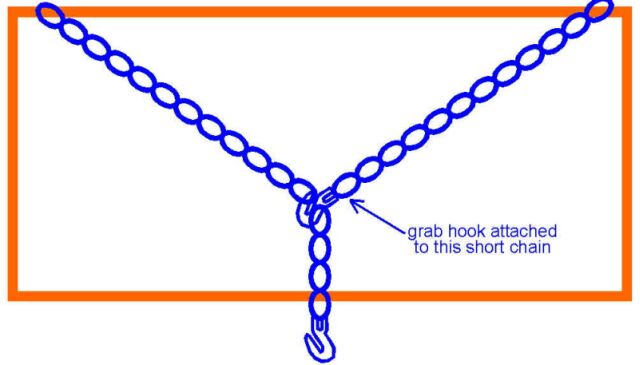

Most everyone's talking about having problems with hooks mounted on the end of the bucket as opposed to in the middle. I have two 3/8" grab hooks that are not welded, but bolted on so they are NOT ridged. They swing a little. I have a short length of chain (about 24" or so) with a grab hook on one end. I use this short chain to "pull" my longer chain over to the center of the bucket. I kinda forms a "Y" so the pull is on the loader arms, not the center of the bucket. I have seen way too many buckets with deformed top center edges. I do like the idea of a heavy angle bolted or welded in place on top of the bucket. I'll take a pic tomorrow to show everyone what I am trying to convey. In the meantime, a quick drawing will have to do.

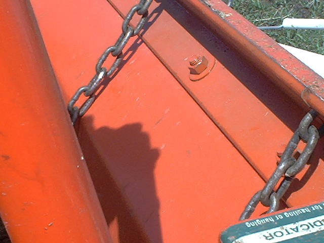

here's some pics of my solution

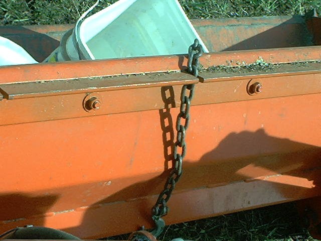

another view

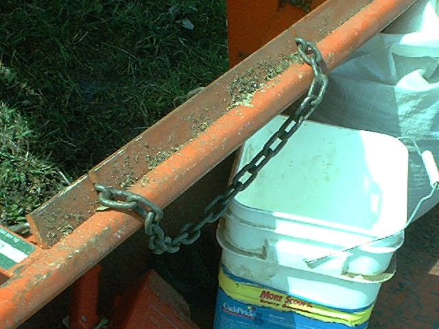

   / What Kind and Size Hooks #15
and lst view - what I like was the ease of installation, it's removable and if I ever get/need heavier chain I can just widen the slots. It also reinforces the top lip of the bucket and distributes the force over the whole top.

Gerard, I like it! Now I just need to find some angle iron..
