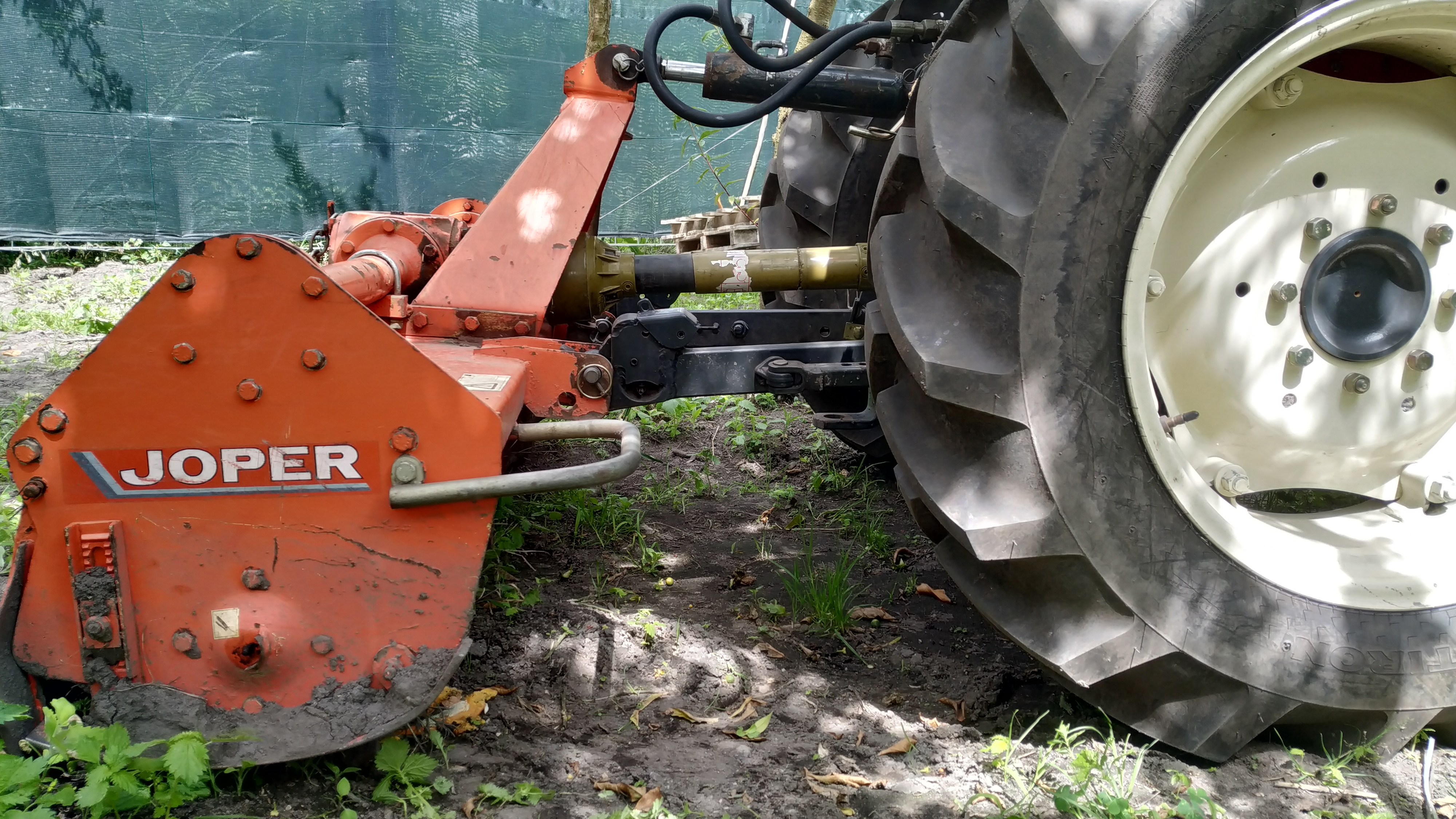

I would weld them with the same angle it comes with. They were designed to be welded on without angling up or down.
A bit hard too see but here are the ones in my tractor. It comes factory with them.

No, that is actually a great picture. Thanks for sharing that. I see that yours is one of the ones that the arm is cut square, and that angle looks fine to me. The implement with the lowest bottom pins is my old box blade, and they're probably at least 4 inches higher than the height of your arms in the picture.
After watching that video, I realized that I do need to make sure the load is going to be pulling into the hook and not against the retaining bar.

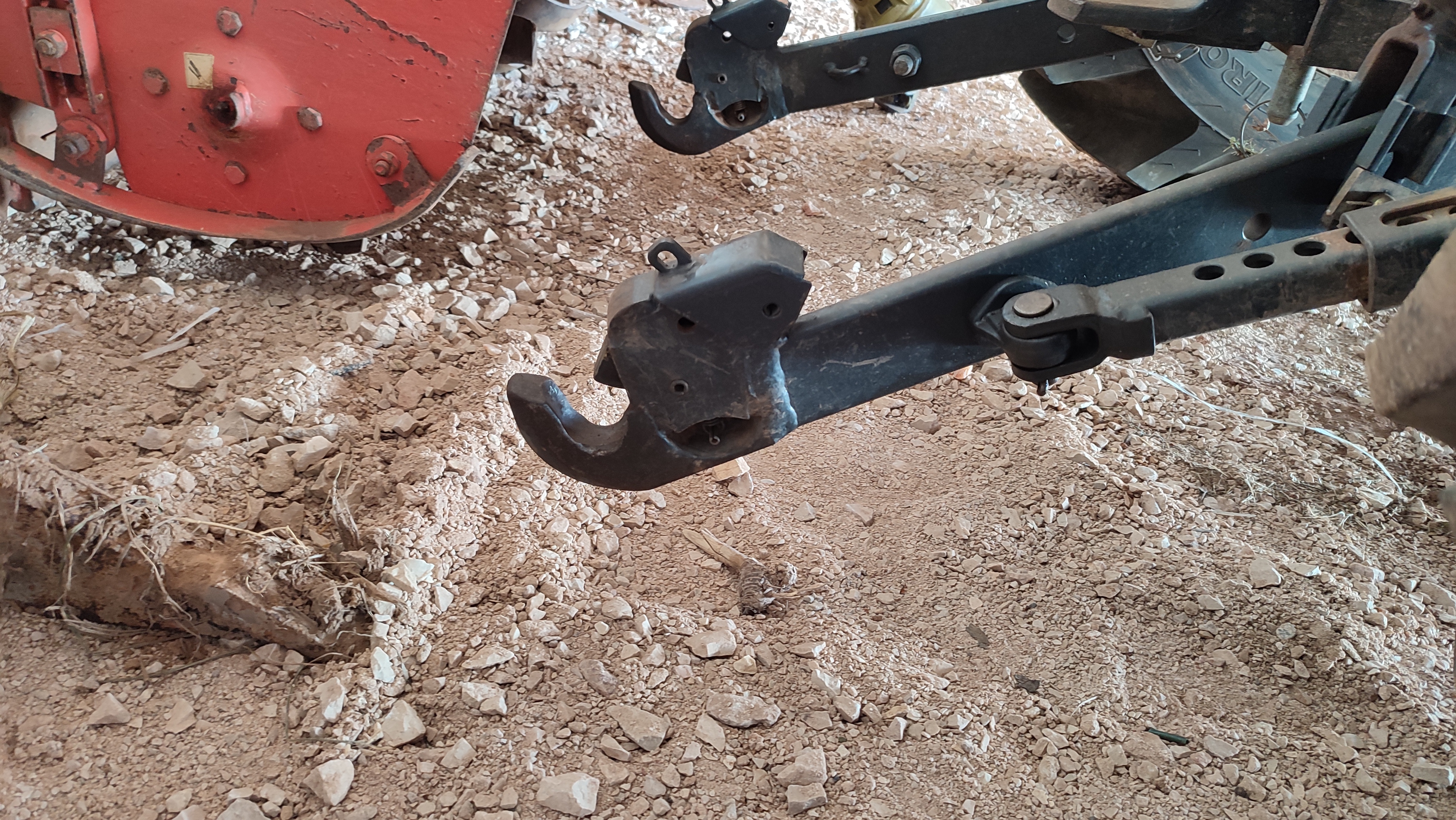

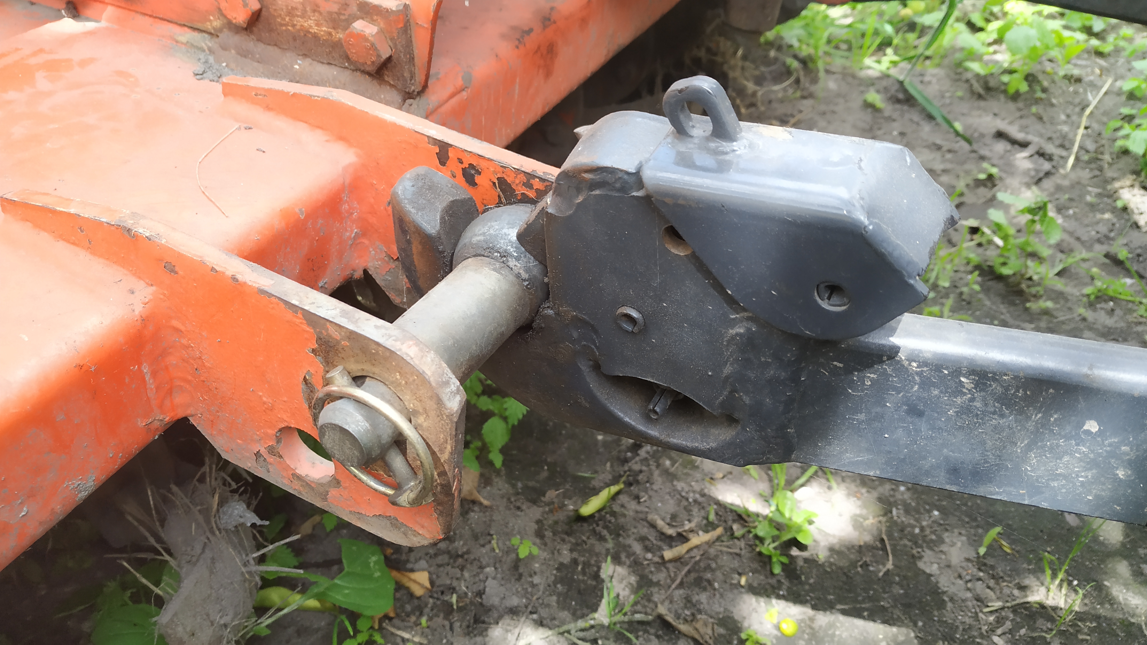

Found some more pictures. Hopefully it helps or gives a couple more ideas.
Those are great pics. And you don't use any bushing or spacer with the ball? This system is incredible.
The more I learn about it, the more I don't understand why pin-and-eye is still the dominant system in North America.

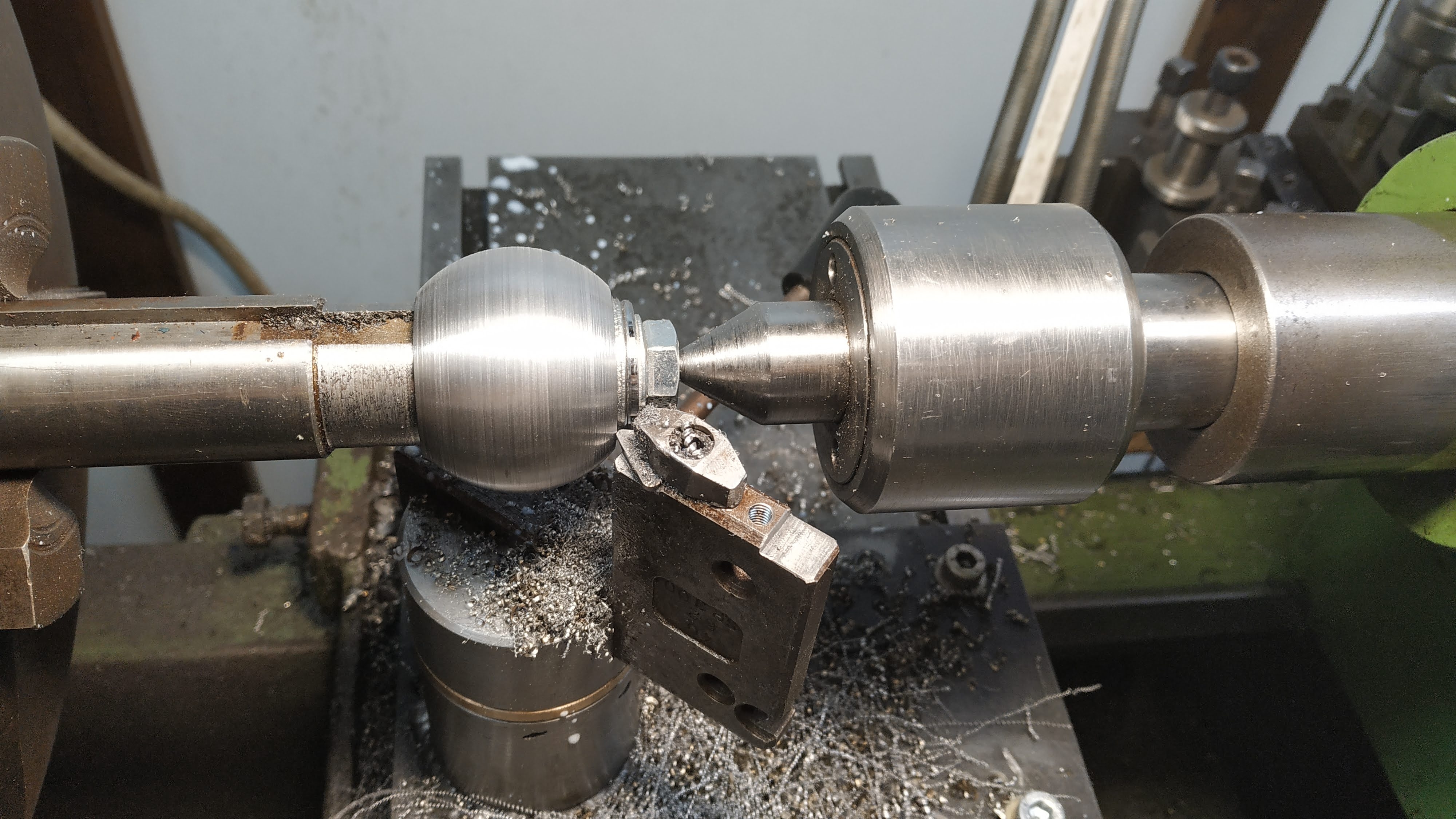

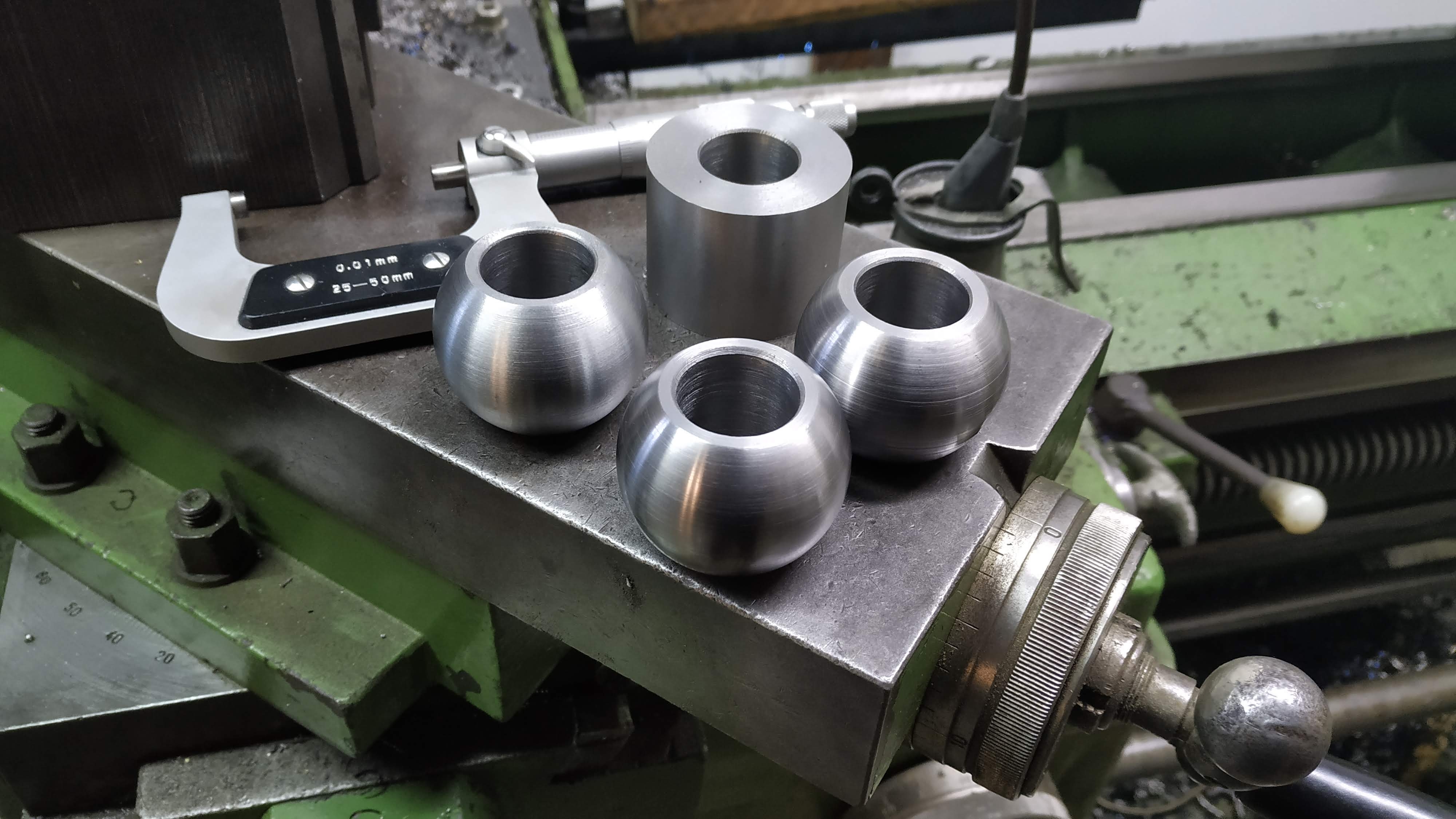

Nothing at all. Just the ball. Mine uses 45 mm balls, being Cat 1, the hole is 7/8" if I recall correctly. This is truly a great system. More and more tractor manufacturers have been offering these as standard here in Europe.
My tractor came with a set of balls. I've since machined 2 more sets so I wouldn't have to move the balls around. They can just stay in the implements. I'm still one set short though but that's for an implement I rarely use.
Using my homemade ball turning attachment here.

You sir are an artist. That ball cutter is brilliant. Thankfully for me, the balls here are relatively inexpensive. Another plus for this system.

The balls are indeed very cheap. I could get them for $4 or $5 each but I've always wanted a ball turning attachment so this was a great excuse for that.

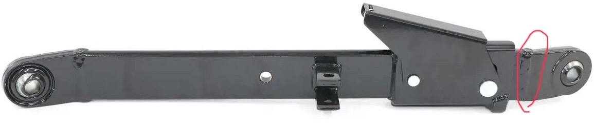

I think he was suggesting to just cut off the ball end (in red) and keep both functions just in case
