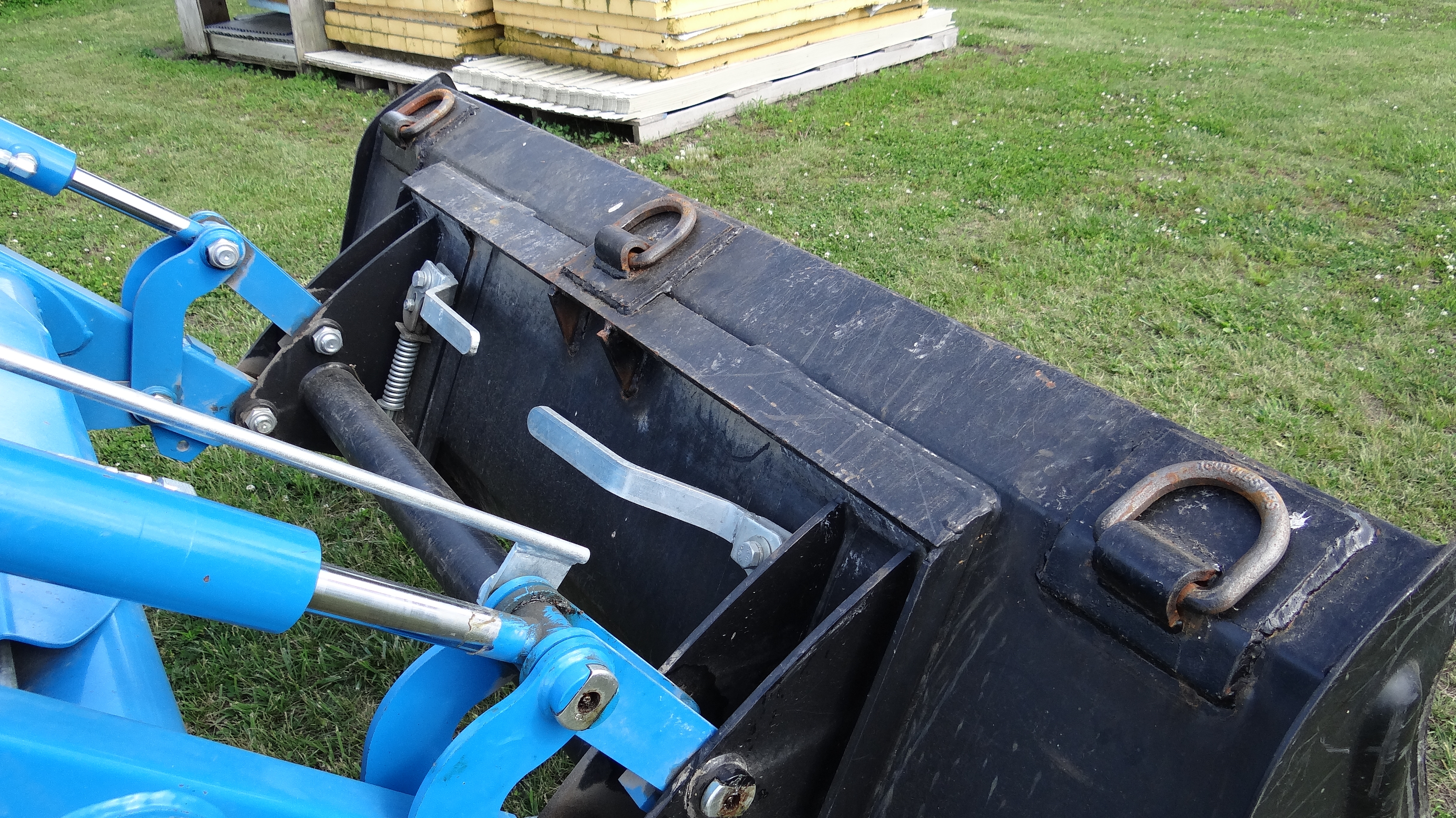

Depending on the bucket it can be a good idea. On my Branson I welded a piece of 2" square tube the length of the top edge then installed the hooks.
I have two slip hooks over the loader arms and grab hooks on each end of the bucket.
(note I did not add a additional cutting edge to the bucket when I should have)

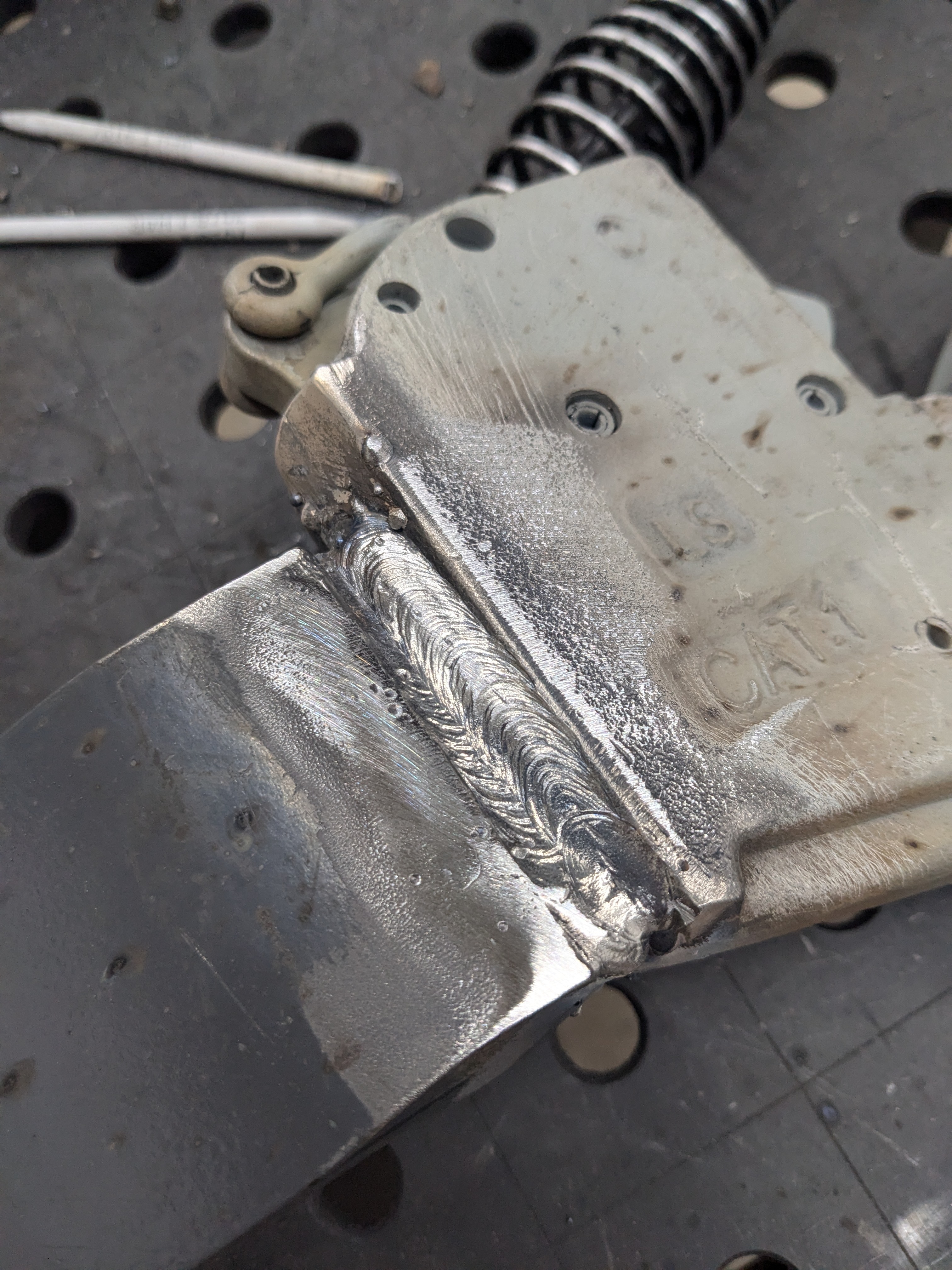

Well the euro hooks haven't snapped off yet :LOL: my box blade with added weight is around 800lbs.
I wasn't loving the looks of the practice beads of the 6011 and 7018 with my small portable stick welder so I decided to upgrade my machine. Got myself a Primeweld Mig285 (multi process), my third machine from Primeweld. The machine maketh the man...
Inflation worked in my favor and I sold my Hobart mig for $70 less than I paid for it, the Mig285 was on sale and was out of pocket $300 for my new machine. I did need to spring for a bigger welding cabinet-HF Vulcan, really nice.
Really loving the euro hooks, total game changer. There was a slight learning curve but it didn't take long. I made 2 spacers out of some pvc pipe to go either side of the balls so that they do not move around when hooking up.

Nice to hear you bought a better welder and everything turned out well .
Pictures would be nice.

Thanks. I will get a couple of shots.

Taking those photos reminds me I need to cut those spacers in half and place them on either side so that there is some more movement.

Good enough for this amateur.

Nice looking welds!

Well done! I would trust that weld job easily. 👍
