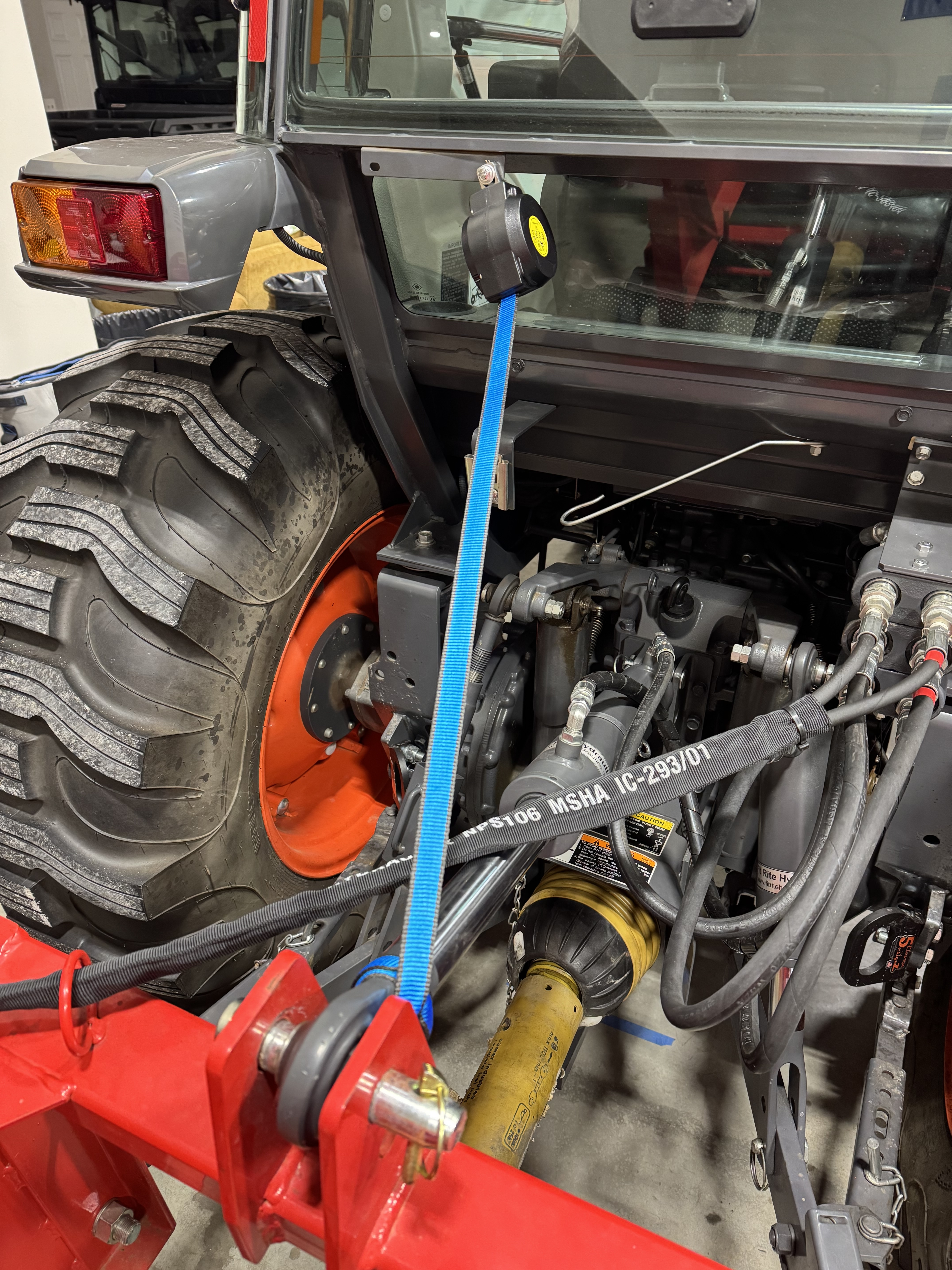

I’m about to have Brian add euro hooks to my tractor thanks to all the post from you guys. I like the idea of the rope for the top link, but don’t like having excess loose stuff hanging around the back of the tractor.
I found the cheapest and smallest fall restraint yo-yo I could find on Amazon ($80), mocked it up this evening. The retract spring will keep the slack out of the line but still allow it to cycle in and out while using the implements. I’ll need to confirm that the spring tension of the yo-yo is not so much that it tries to disengage the latch of the top link, but it feels pretty light so I think it will work ok. Wanted to share my idea with you all.
