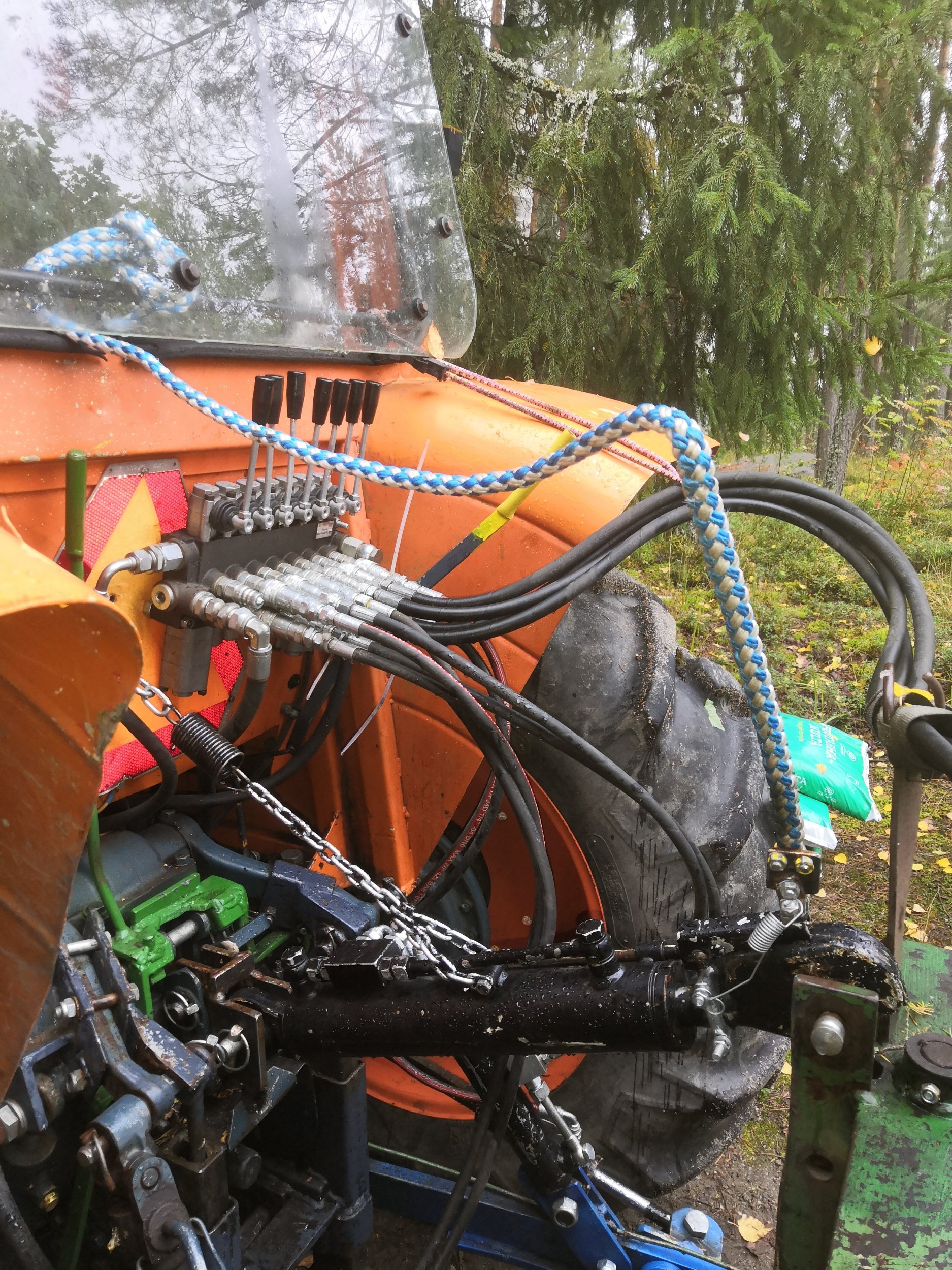

Thank You workinonit and other writers
You can buy hydraulic top link. It is then easy to attach all your tools with QH or without it.
And use this kind of car try rope.
Put a spring abot 1 foot long and 1/2 inch dia inside the rope at tool end to keep rope upright.
Then you need a chain and bigger spring to make the top link floating and easy to lift to your tools upper pin.
This was for my Euro Hooks that I use from my tractors cabin, but i helps QH ,Pats and all other.
You can buy hydraulic top link. It is then easy to attach all your tools with QH or without it.View attachment 834917
7 sets of remotes? 😳 2 for top n tilt, what are the others for ? And the green item tucked behind the top link?
/ Quick Hitch or Euro Hooks
#9
Thanks D&D
Yes I have 7 remotes -- 6 is used
2 for top and tilt
2 for lower arm hydraulic stabilizer bars. I like to tighten arms when I have big logs in my log grapple
2 for my homemade hydraulic log grapple
1 waiting for new use
That green item was my old lever for Euro Hooks opening
Now it is an elbow as I have with JD pictures
JD do not have hydraulic stabilizer bars.
It have left side rigid and right side movable from the
cabin with a lever I made for it
Ah, I missed that in the picture but sure enough it is there. I did not miss that you leave the back window open to use the rope and levers 😋

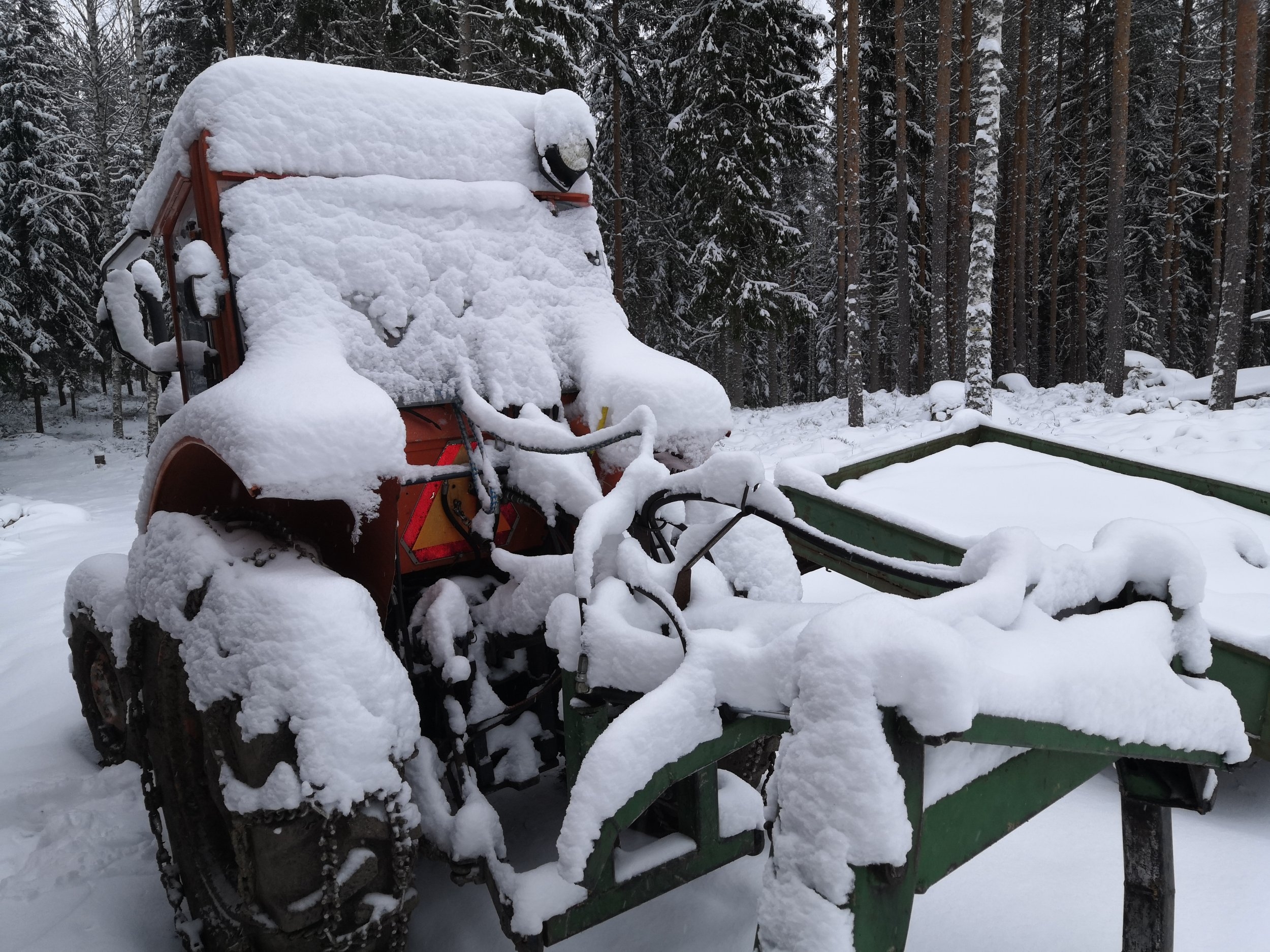

Thanks D&D
Here is some pictures of my Homemade Wood grapple.
I can use it with my leveling drag
Here is use of MY EURO HOOKS
I think the Top Link is not problem after that rope and springs.
Welding Euro Hooks one may need help.
And making linkage from hooks up to
the window one may need help too.
But work is worth the job.
When you come old you understand me.

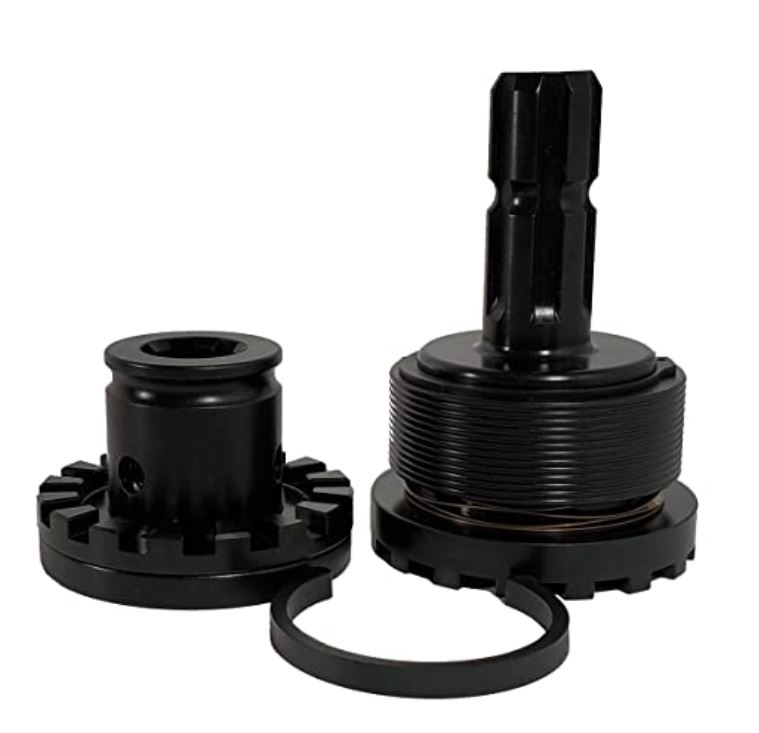

I have a lot of implements that aren't PTO powered but obviously if you have PTO it has to be hooked up. Actually the QH makes it easier because it pushes the implement away from the tractor about 6". But unless you want to spend several thousand on one of those auto devices there's no choice. That said when I do have to hook up PTO I still back up, lift and it's hooked up. 3 minutes hooking up the shaft and you are done. It's the same deal with hydraulic hoses.
I bought a PTO quick connect adapter. Should be called an easy connect adapter. Added the 4 inches I needed to compensate for the Quick Hitch on my mower. And it is super easy to connect. Slip it on then turn to align the teeth - pull the spacer and go. I have adapters on both mowers.
