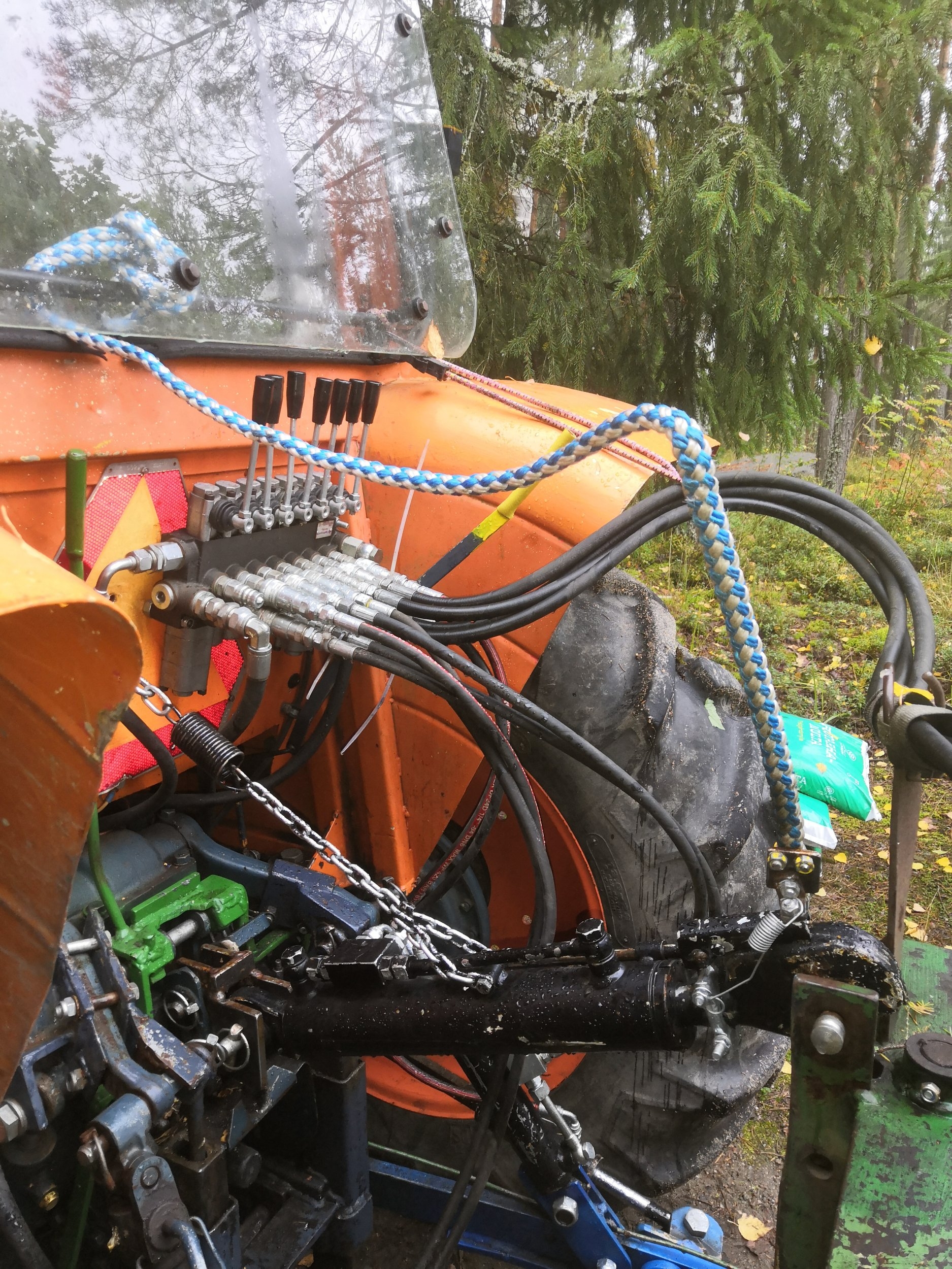

Thank You workinonit and other writers
You can buy hydraulic top link. It is then easy to attach all your tools with QH or without it.
And use this kind of car try rope.
Put a spring abot 1 foot long and 1/2 inch dia inside the rope at tool end to keep rope upright.
Then you need a chain and bigger spring to make the top link floating and easy to lift to your tools upper pin.
This was for my Euro Hooks that I use from my tractors cabin, but i helps QH ,Pats and all other.

You can buy hydraulic top link. It is then easy to attach all your tools with QH or without it.View attachment 834917
7 sets of remotes? 😳 2 for top n tilt, what are the others for ? And the green item tucked behind the top link?
   / Quick Hitch or Euro Hooks
#9
Thanks D&D
Yes I have 7 remotes -- 6 is used
2 for top and tilt
2 for lower arm hydraulic stabilizer bars. I like to tighten arms when I have big logs in my log grapple
2 for my homemade hydraulic log grapple
1 waiting for new use
That green item was my old lever for Euro Hooks opening
Now it is an elbow as I have with JD pictures
JD do not have hydraulic stabilizer bars.
It have left side rigid and right side movable from the
cabin with a lever I made for it
Ah, I missed that in the picture but sure enough it is there. I did not miss that you leave the back window open to use the rope and levers 😋
Any pics of your grapple?
