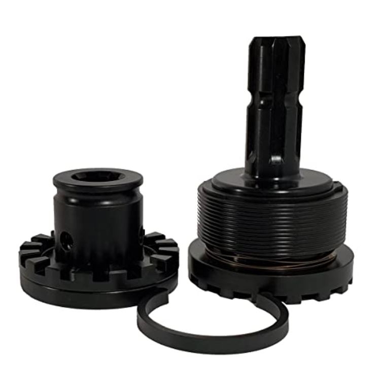

I've looked at those. Have a buddy that has one on a smaller Kubota tractor and he doesn't care for it. I don't have any issues with connecting the PTO. I just have to turn the tractor off so my PTO shaft will rotate on my tractor. Things like my flail are no issue because it turns freely.

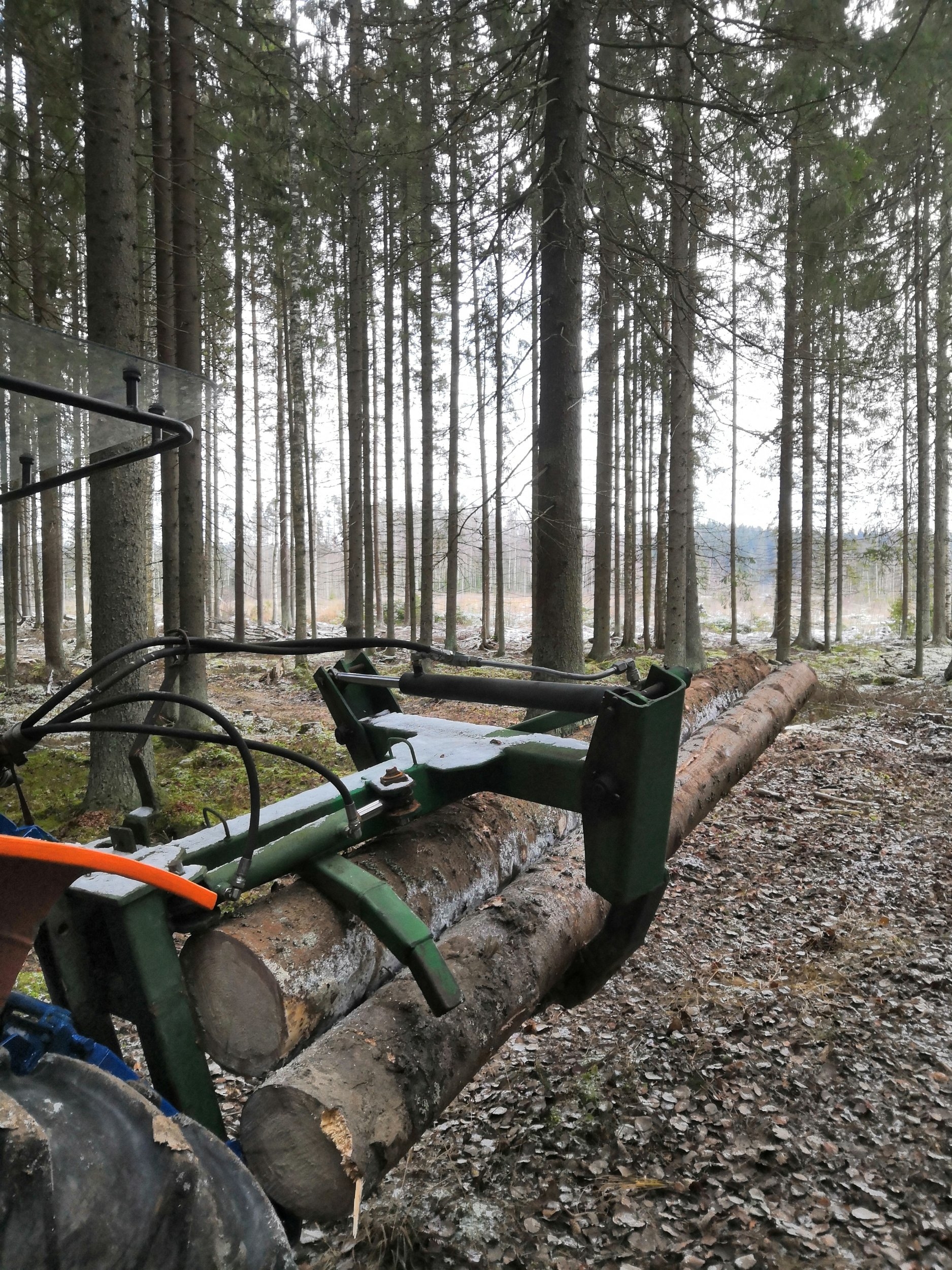

Very interesting concept. Does it just clamp on and pin in some fashion?

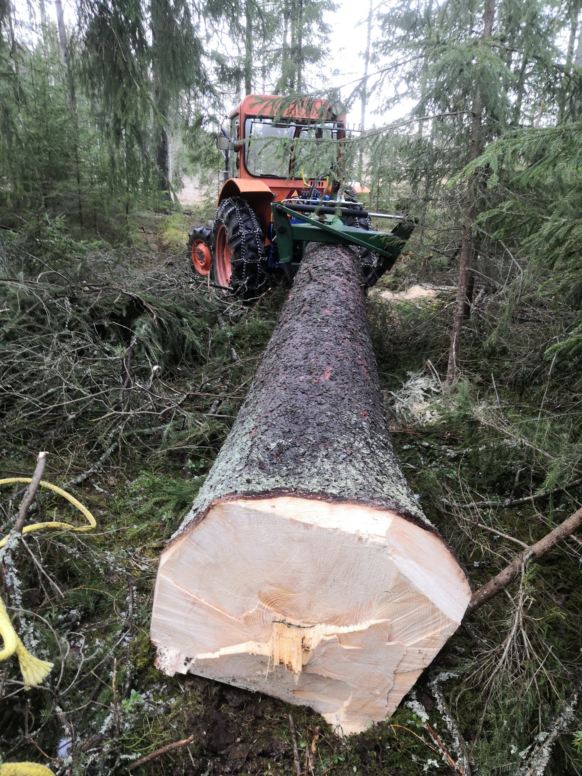

That is some nice timber you’re harvesting.
Yes I clamp it with my grapple and it is ready to go.

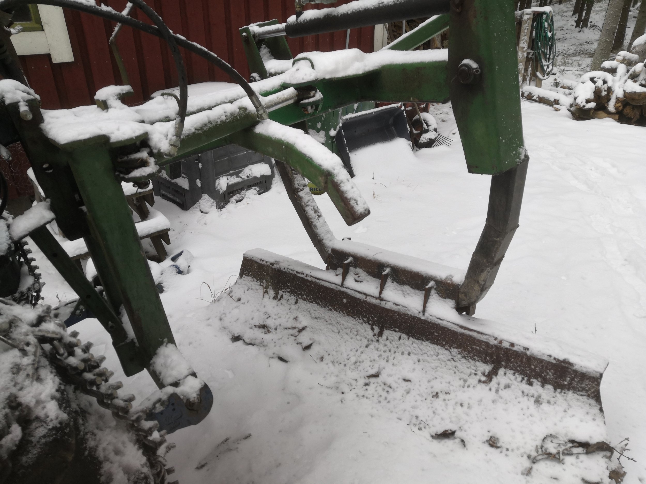

I can take it for pulling or pushing.
I can drag now snow without taking of my grapple.
The tree was about 120 years old and pushed down by wind.

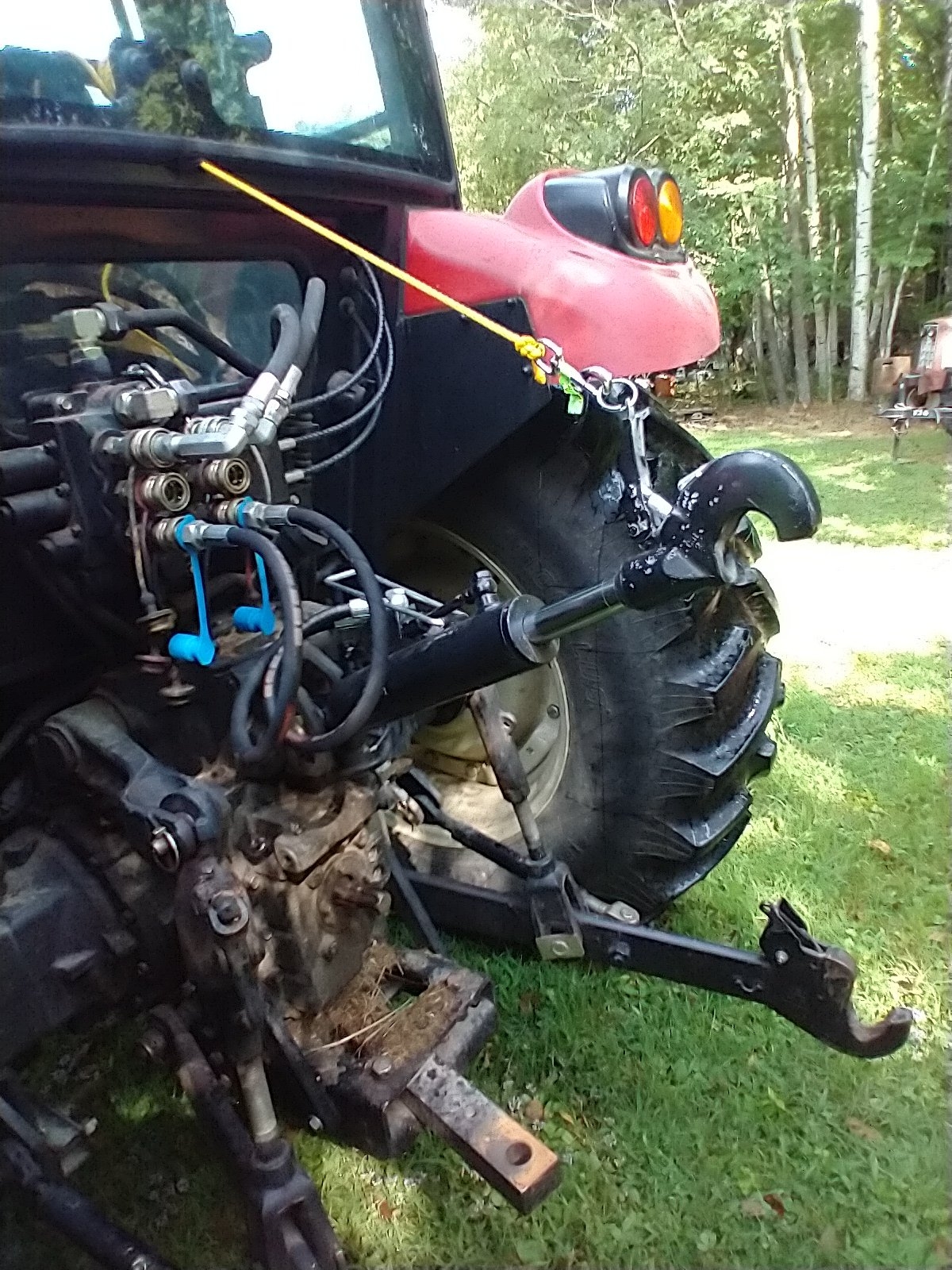

The hook would definitely make it easier but without the hook it takes a bit of magic and ingenuity to hook up a hydraulic toplink. It's one of the reasons I bought the right hand door kit for my tractor, Please tell me how you do it with so much ease and with the first try.
Two of my tractors and several of the farms tractors have 3 pt control buttons on the rear fenders. Makes it easy to lift an implement and raise any jack legs then raise or lower the lift arms till the top link works. Or on some I can reach the hydraulic control to extend or retract the cylinder while standing outside next to the top link. Or I put the pin or leave the pin in the toplink and adjust the length till it looks right then get down and pin it.
I will be ordering another top link hook sooner or later to replace the eye.
I have also stepped around to the right side of the tractor and tweaked the control and stepped back to check and gone back and forth a couple of times.

Thanks LouNY
As a young engineer by Valmet now it is Valtra AGCO Finland
we made the closed back to tractor Valmet 502 cabin.
I got a small invention price of mechanic rear lever for tractor hitch.
After some years every company had same or push buttons if electric hitch.
Like the yellow lever in this picture :)
Now I feel things go slow to make tractors better and more safe to use.:D
