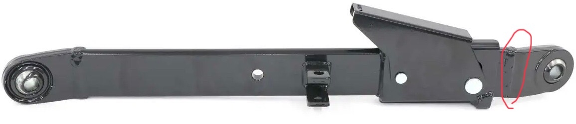

I think he was suggesting to just cut off the ball end (in red) and keep both functions just in case
I'm sure he was. But since the telescoping function is totally unnecessary with this hitch system, that would be a waste of good ball ends.

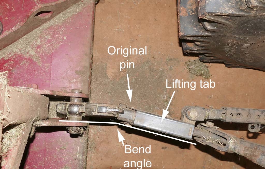

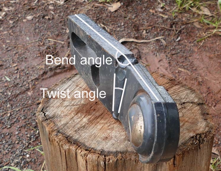

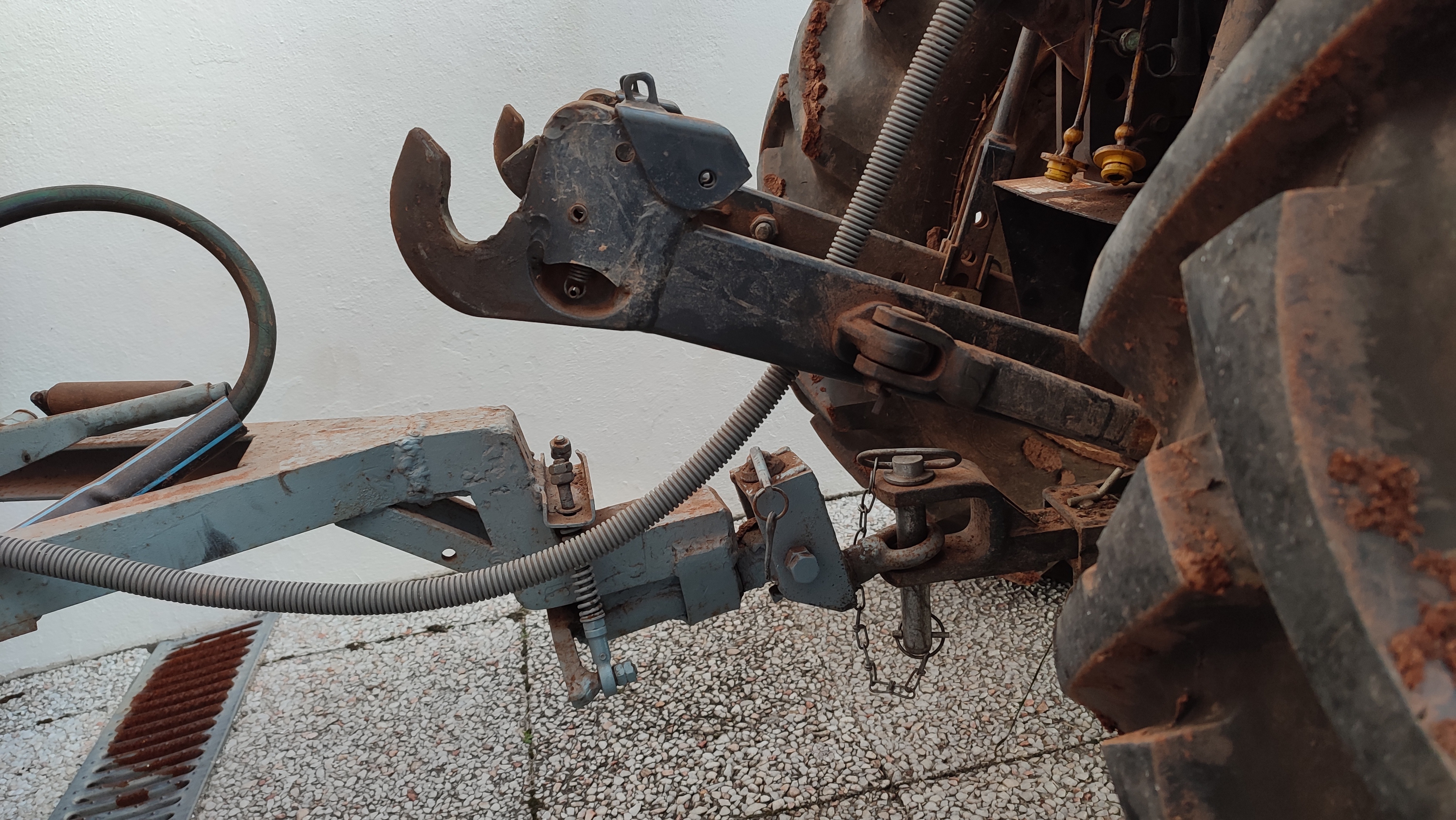

My Kioti came with extendable "cassette type" hole'n'pin connectors, which I removed and put on the shelf. I then got two hooks, welded them on to mild steel bar, drilled a hole in the mild bar and secured them into the slots in the lower arms with a bolt. This way, I still have the option of putting the connections back to factory standard.
It's midnight here now, but I'll take a couple of pics in the morning for you. I will say, and the photos will show this, the hooks need to be twisted a little when being welded, to match the angle of the OEM slide-outs!
Pics coming after a sleep!

/ What angle for weld-on Euro hooks? #31
Using the OEM part as a template, we welded the new hooks onto suitable mild steel bar with the same dimensions, paying particular attention to the two angles* - the bend angle and the lean or twist angle. It was a bit of a fiddle - tacking and comparing - and then the full DEEP weld when it was aligned correctly.
*Different tractors may well have different angles!
We drilled a single hole in the new bar to accept the original pin, so now the original lifting tab is locked into place, and of course the new fitting no longer slides in or out, but that's not an issue for me. :)

Nice job! In my case I have the left to right angle to work out, but no twist so that's nice. I'm still going back and forth a little on the vertical angle. ptsg's hooks look square mounted to the lower links, and the "angle of attack" looked pretty good. I won't be able to make that decision for certain until I have the hooks tacked to the square-cut flat bar and mounted in the arms at implement working height. Whether I leave it that way or dial in a bit of rake, I'll post the results with the final numbers on the angle(s).

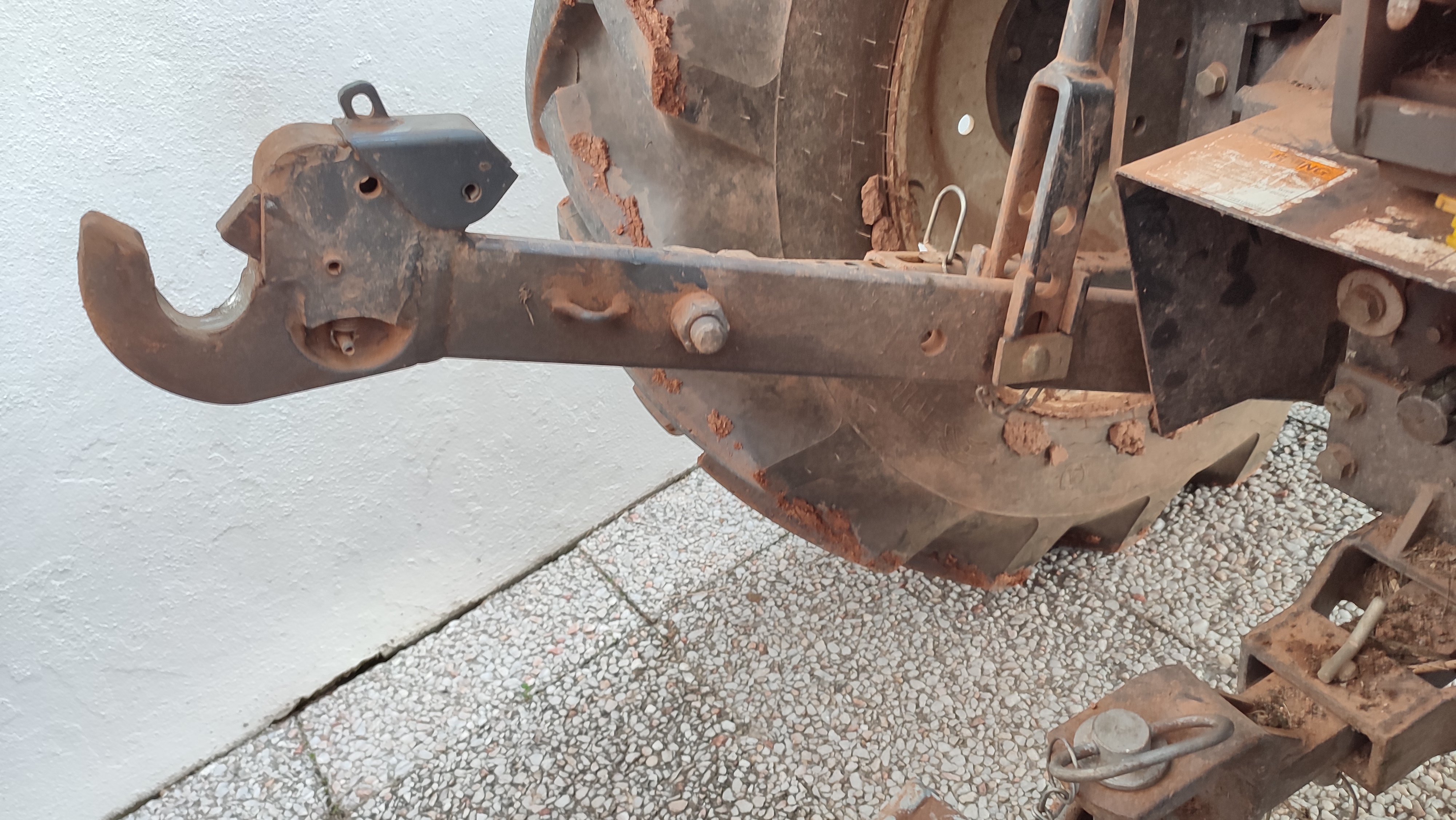

@BCLoco I was near my tractor the other day and remembered to take some better pictures of the hooks. Hope it helps some.
#38
/ What angle for weld-on Euro hooks? #39
Excellent pictures! Thank you.
