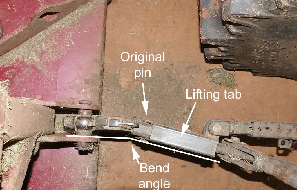

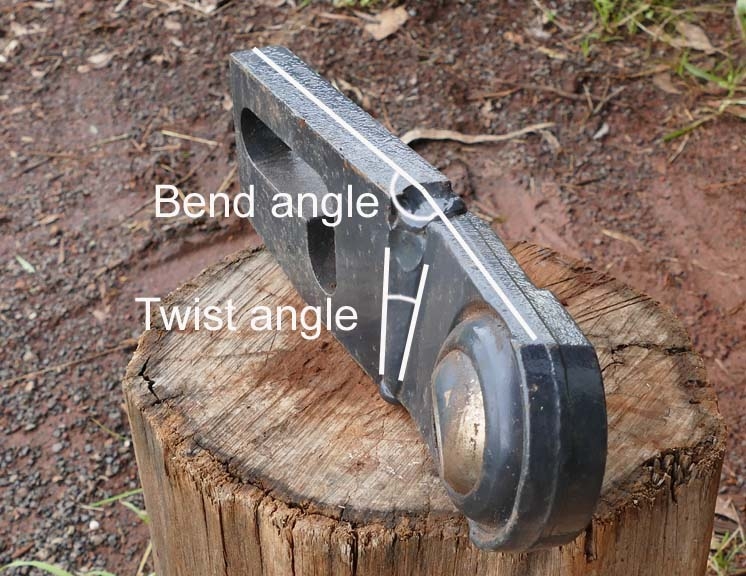

Using the OEM part as a template, we welded the new hooks onto suitable mild steel bar with the same dimensions, paying particular attention to the two angles* - the bend angle and the lean or twist angle. It was a bit of a fiddle - tacking and comparing - and then the full DEEP weld when it was aligned correctly.
*Different tractors may well have different angles!
We drilled a single hole in the new bar to accept the original pin, so now the original lifting tab is locked into place, and of course the new fitting no longer slides in or out, but that's not an issue for me. :)

Nice job! In my case I have the left to right angle to work out, but no twist so that's nice. I'm still going back and forth a little on the vertical angle. ptsg's hooks look square mounted to the lower links, and the "angle of attack" looked pretty good. I won't be able to make that decision for certain until I have the hooks tacked to the square-cut flat bar and mounted in the arms at implement working height. Whether I leave it that way or dial in a bit of rake, I'll post the results with the final numbers on the angle(s).

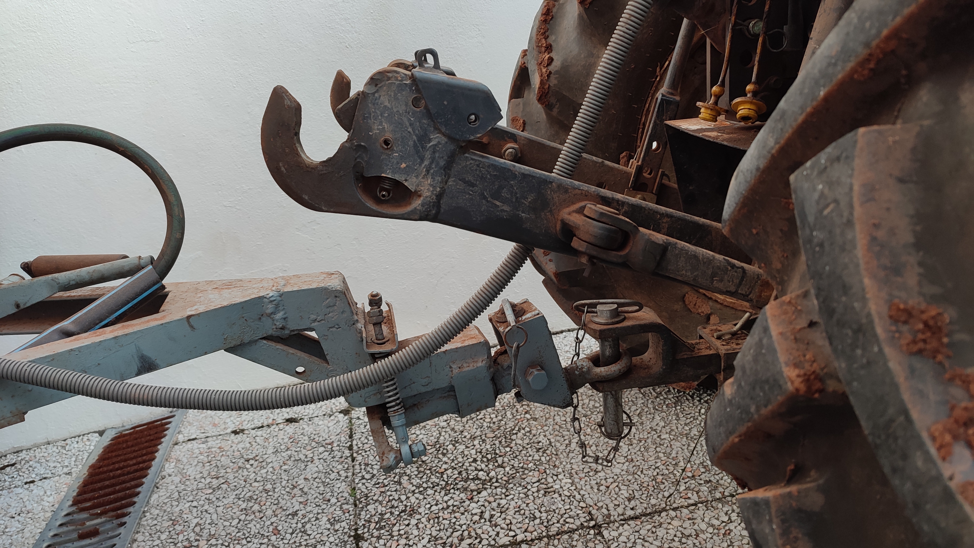

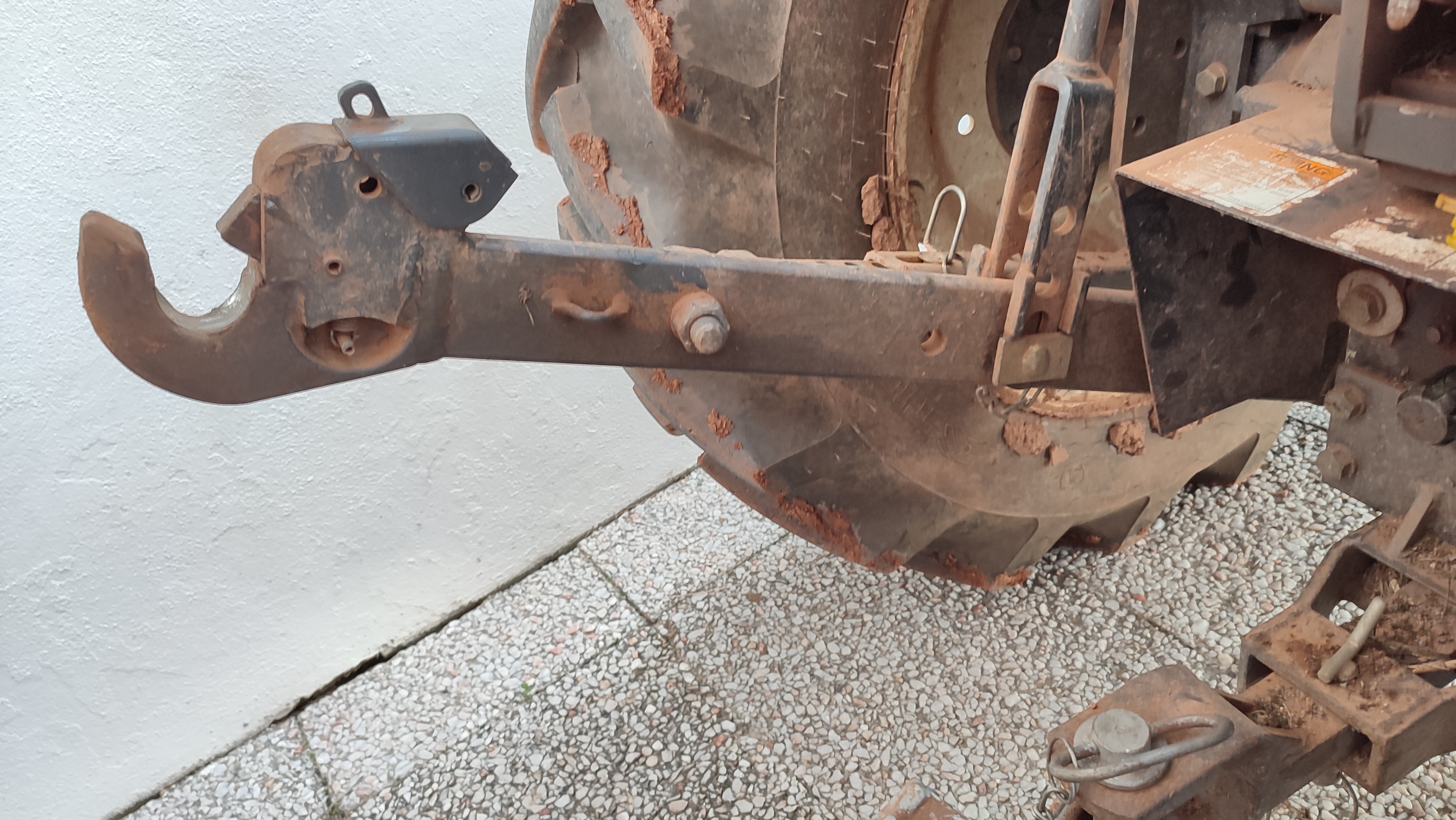

@BCLoco I was near my tractor the other day and remembered to take some better pictures of the hooks. Hope it helps some.

Excellent pictures! Thank you.
