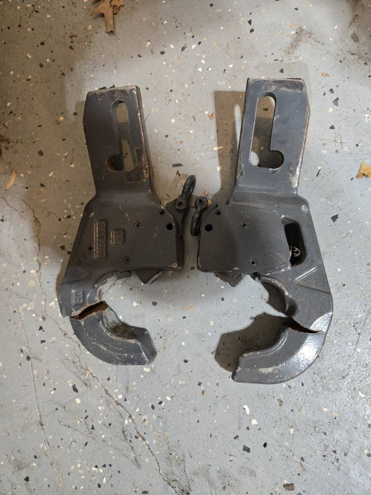

Just make sure your implements don't interfere/ put pressure on the tips of the hooks. My box blade contacted the hooks when the scarifiers were down and ended up doing this to them.
Second time I used them, still need to get around to repairing them.
Luckily I had my stock ends to switch back on.

That's no good. I'm trying to imagine how that happened. I will rotate my BB around and check out the clearance but from memory its not close.
That repair will test out your welds, it looks like its right where the load sits.

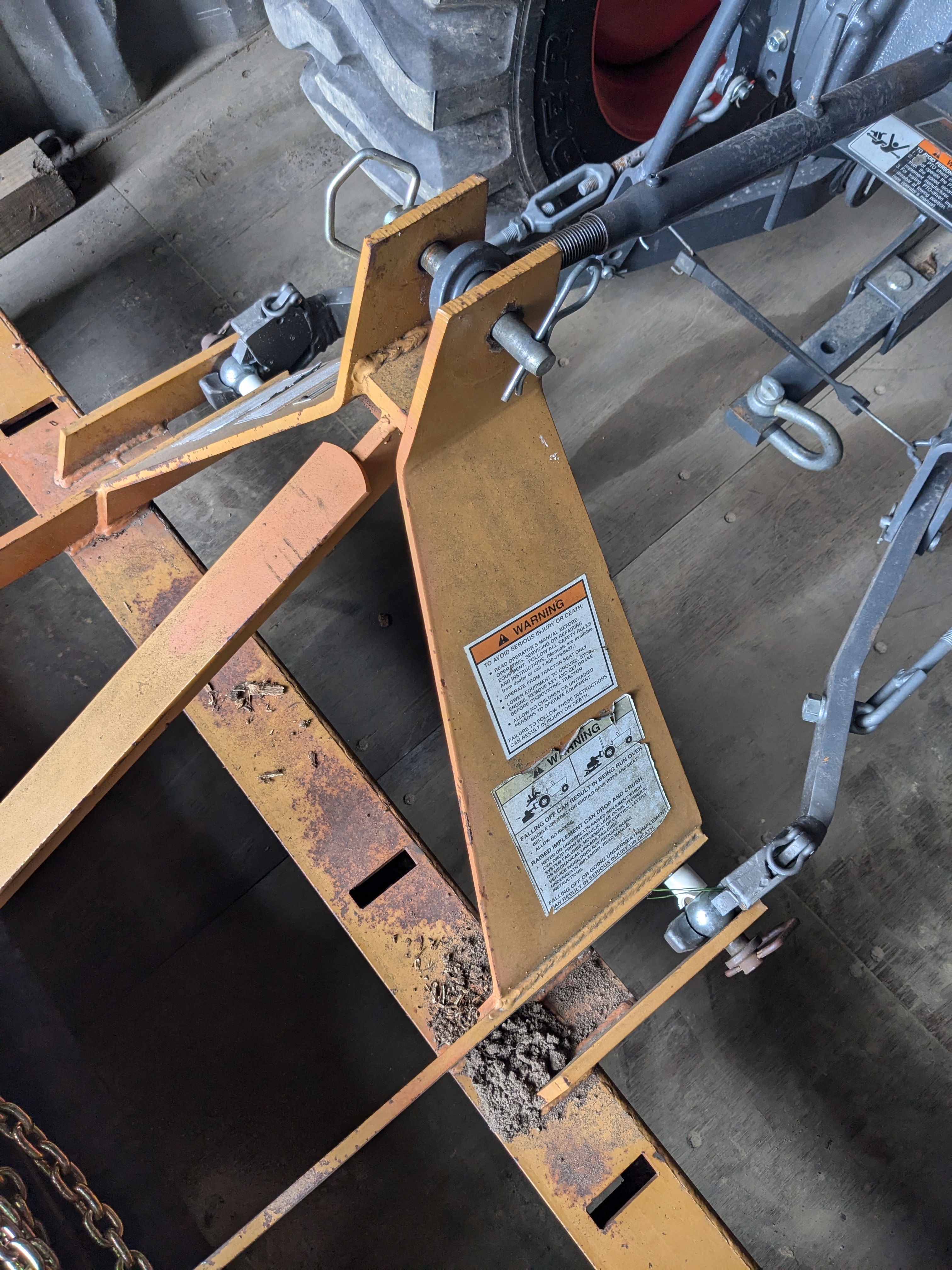

My box blade has a mount that pivots to drop the scarifiers down, the 3pt lower arm mounts are on that bar.
I'm not worried about the repair holding, it's a fairly simple structural repair.

I would like to see a picture that shows how-why that happened.
   / Rod size for euro hooks #49
Well, I was pretty annoyed when it happened, so I didn't get any pictures.
Maybe once I repair them and modify the hooks for clearance I can grab a pic of the box blade mounted.
Don't hold your breath though, happened a few years ago and still haven't gotten around to fixing it.
