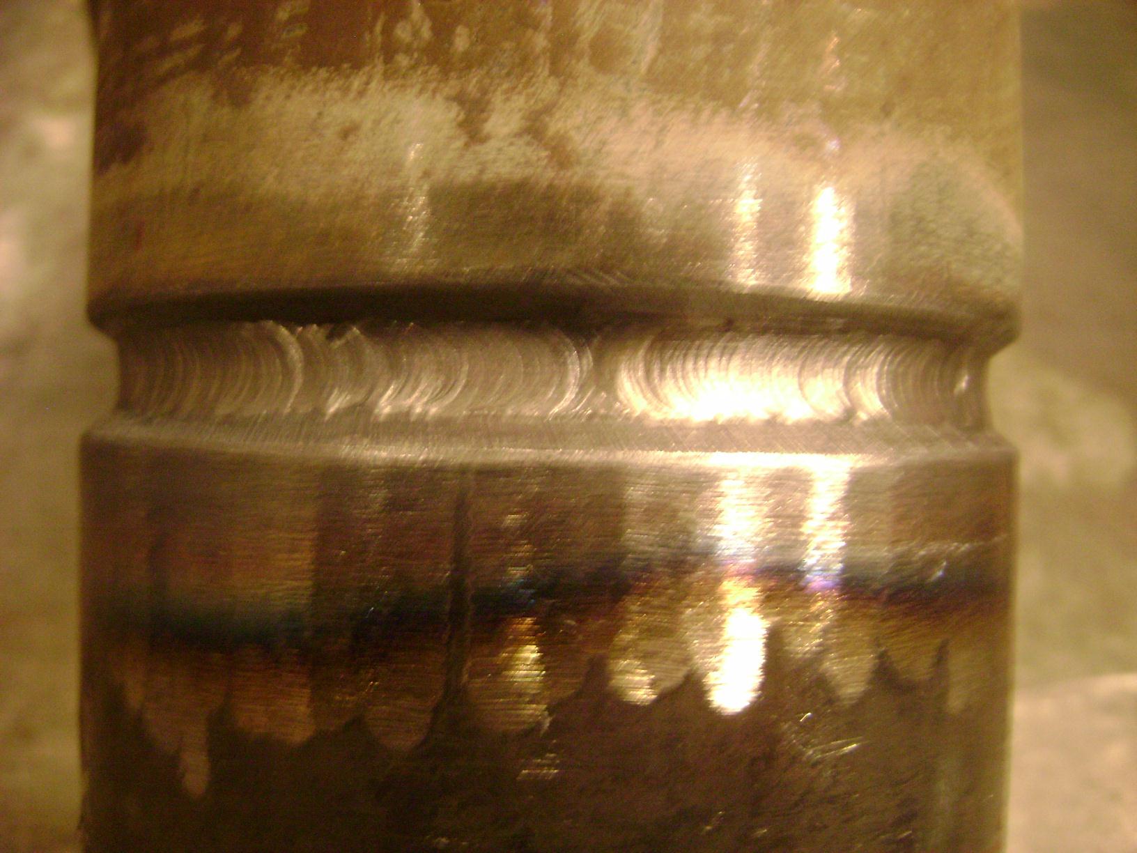

Tig is really nice for thin material. Little steep on the learning curve though.
I know these pictures are blurry:eek:, I took them with an old camera that I eventually through against the wall, and had the wife pickup a better one.
These are some Tig welds I made with my PowerArc 200.
