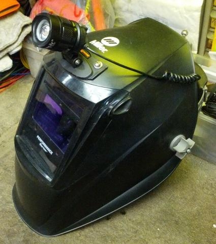

The beauty of helmet light concept is you are always pointing light on to your weld from behind the sensors in helmet there for helmet is less likely to respond to light changes and you also have light source pointed directed at your weld when you are "out of position"...
Also I use 2 diopter cheater lens behind the helmet lens, it a great help for old eyes...

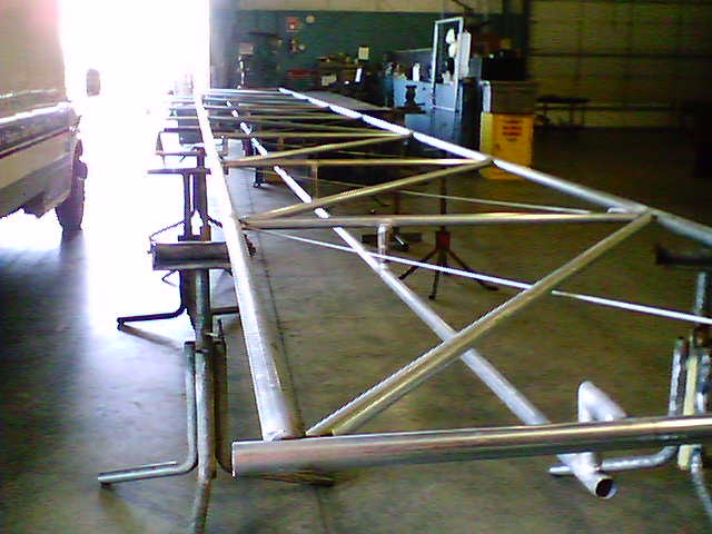

Having a table big enough for all your projects is an illusion; my work table was 6x20' and the cantilever gates were usually between 33-54'.
Having good lighting where you can see the material, and not just the arc is important. It's best to have it coming from behind, but not directly so it won't reflect off the inside of your hood.

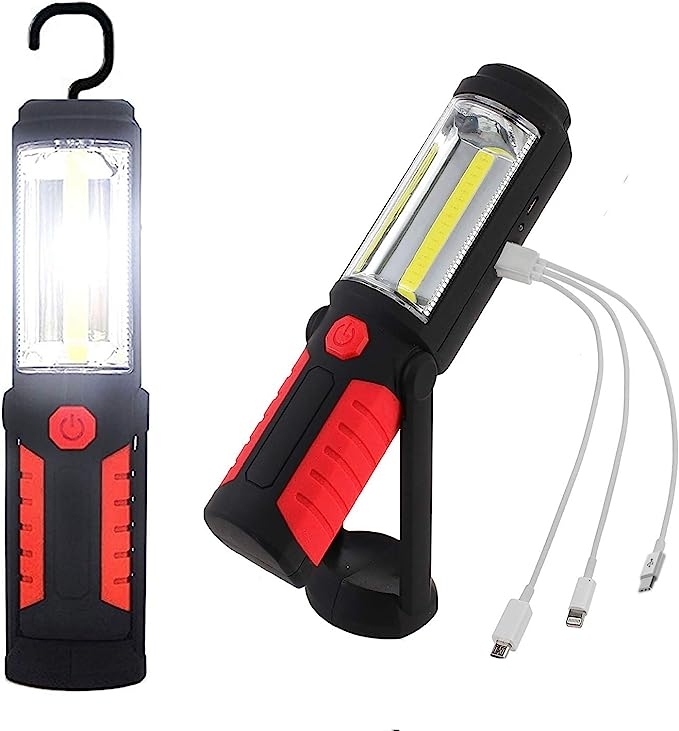

I feel like I'm an "ok" welder, but I definitely do my best work when I can actually see what I'm doing.
Unfortunately, I do most of my welding at night and though my shop lights up plenty bright for most work, as soon as that arc strikes I realize I could definitely use twice as much light - and often I end up in front of my shop where it's kinda dim and then I'm really blind.
I've seen some helmets that have LED lights on them, that seems like a possibility (I love my headlamp for other things but havent' tried stretching it over my helmet, doubt it would reach).
My thought is a big LED panel that I could hang from my neck and possibly belt around my chest, so I'm like iron man with this bright glowing thing in front of me, would do the trick pretty well, but I haven't seen anything like that.
What do y'all do for intense work light, ideally something that moves with you?

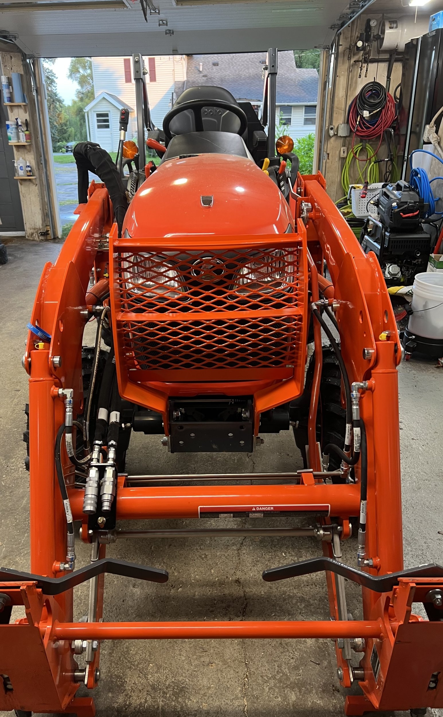

Just adding to my post. I added some expanded metal to my grill over the weekend to make it more a brush guard and was able to see where I was placing my gun and what I was doing when the arc was lit with my hood. There's just a momentary period when the arc first strikes and when it goes out it's black for half a second or so, but otherwise I absolutely can see what I'm doing and I'm positive my ability to see makes me a better welder than I otherwise would be.
