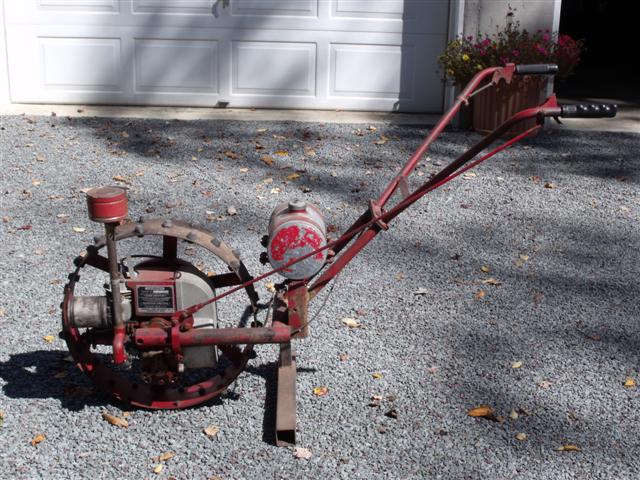

DSCF0148 (Small).jpgDSCF0149 (Small).jpgdaugen That is the David Bradley and that is the hood in the open position, showing the fuel tank and engine. The suburbanite was used by nurseries and gardeners because of its small size. I don't have any attachments for it but they had mowers,cycle bars and cultivators for them.

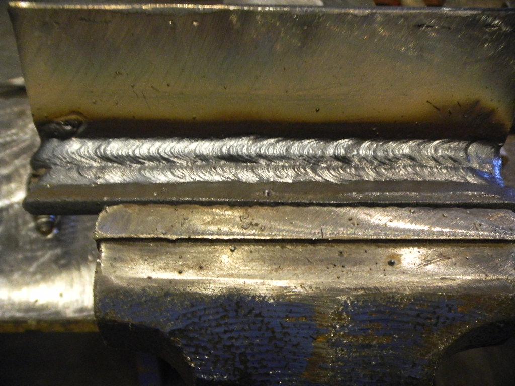

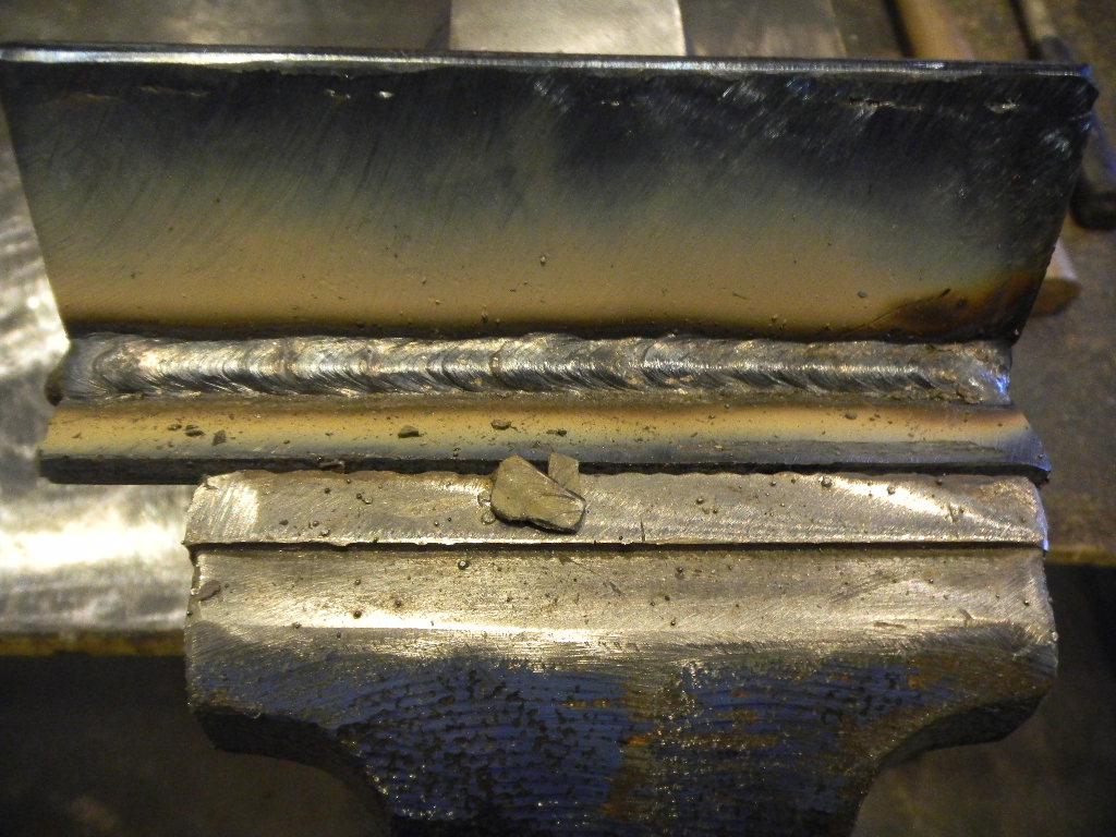

6010 is one of the best rods you can use to run over paint, rust, and general crap. But 6011 will do the same thing. 6010 is a DC only rod, where as 6011 is DC & AC rod. I think Mark said the reason for the special 6010 port is it has an increased OCV, (open circuit voltage). I understand most of these little inverter machines will not run 6010. Miller has a couple that people complain about all the time.
Until joining these tractor forums the thought of using AC for anything but Tig welding aluminum never crossed my mind. So I gave it a try. Here is some 7018 I ran with my Montgomery Wards buzz box. The sound really set me back, and I noticed 7018 didn't want to wet out like on a DC machine.

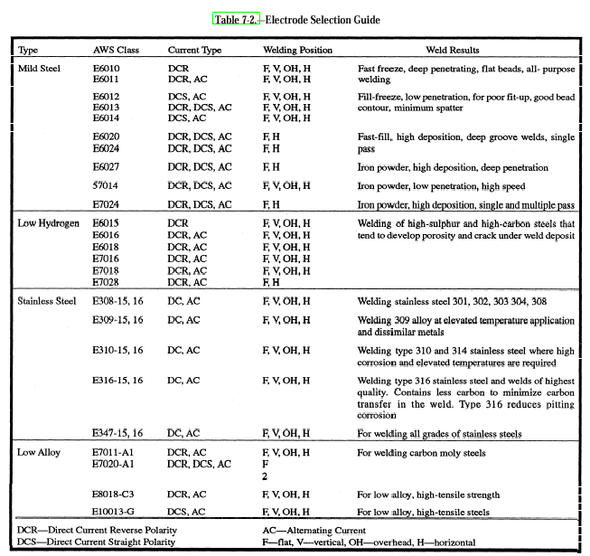

for us unwashed and dumb, could you explain what makes a 6010 rod "special" and why a separate port would make it run better?
General purpose rod? Do some rods work with AC and some with DC better?
sorry, you guys are talking over my head, which clearly doesn't take much.
different rods for different materials.. and the numbers mean different things.
for instance the first digits 6 is for 60k tensile strength.. 7 for 70.. etc...
this chart explains some of it...
