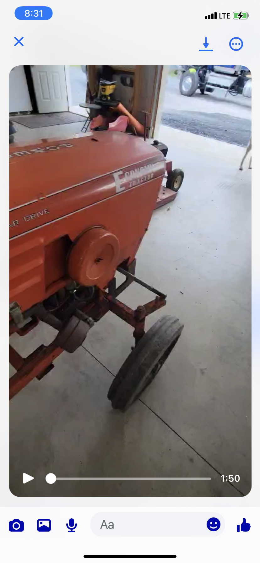

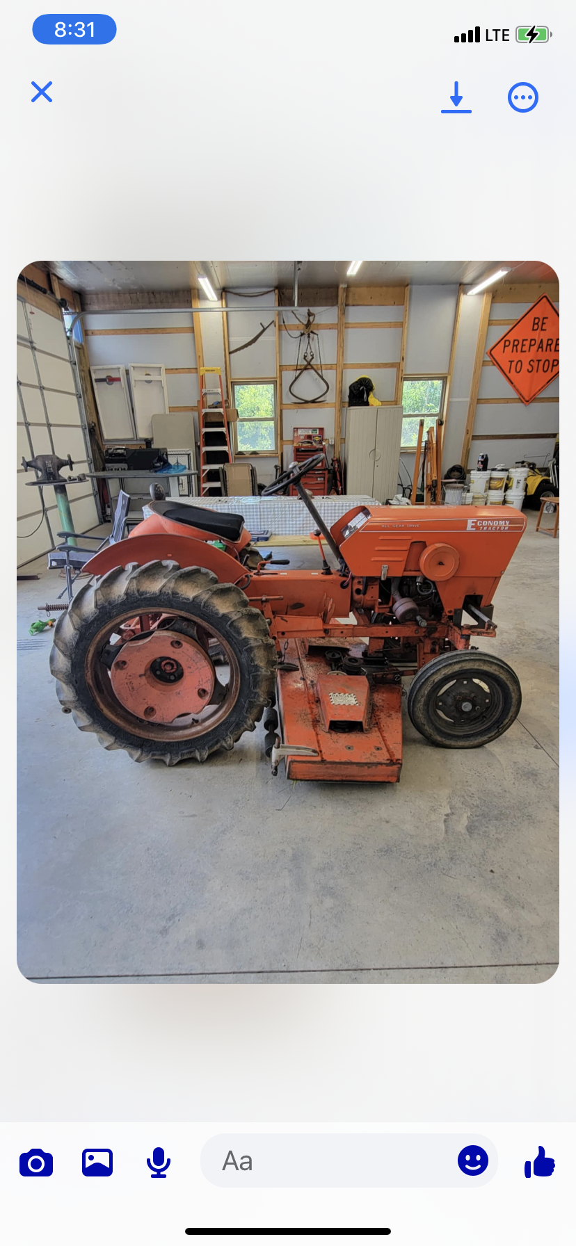

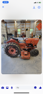

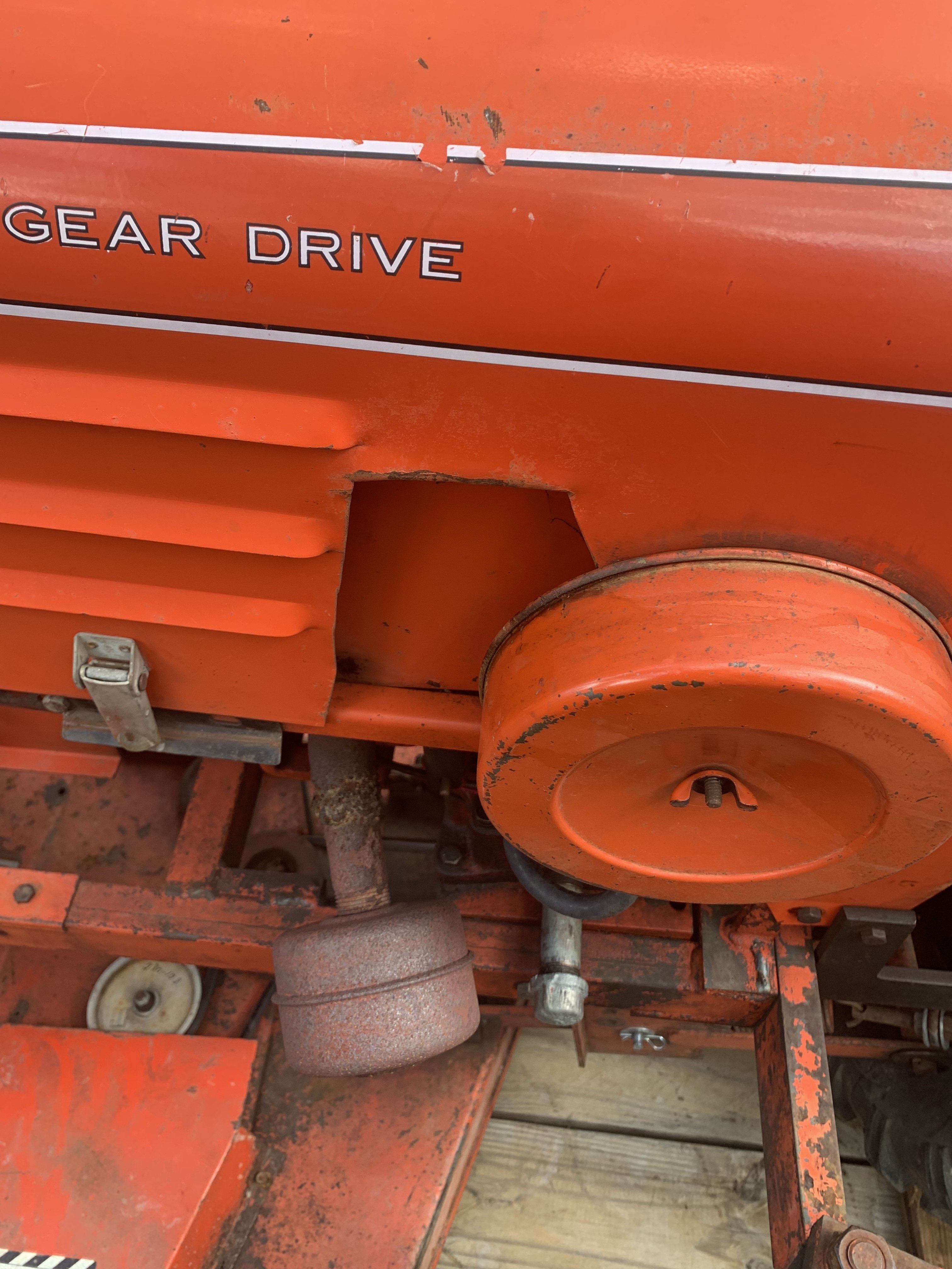

Looking for ideas
I welded autobody for over thirty years, as the years progressed the metal became thinner.
I can weld a soda can but it will distort the can badly.
For some reason someone cut section out of my hood, I have another hood that is beat to hell but this area is fine.
I’ll need to cut out a patch, weld it and have the least amount of filler possible front AND back.
I never was a hack, always did good work within reason but working for insurance companies you can’t be Picasso, you rely on fillers that set up quick and sand easy.
Being around the louvers makes me think I should cut out a large section including louvers and replace it all.
I’ve worked with louvers and heat and then body fillers, it typically doesn’t look factory new.
Again I need it to look like it never happened both sides with grinding and possibly a little plastic for porosity holes.
Anyone here have this kind of experience?

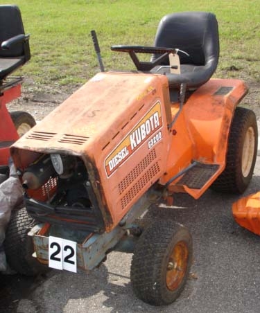

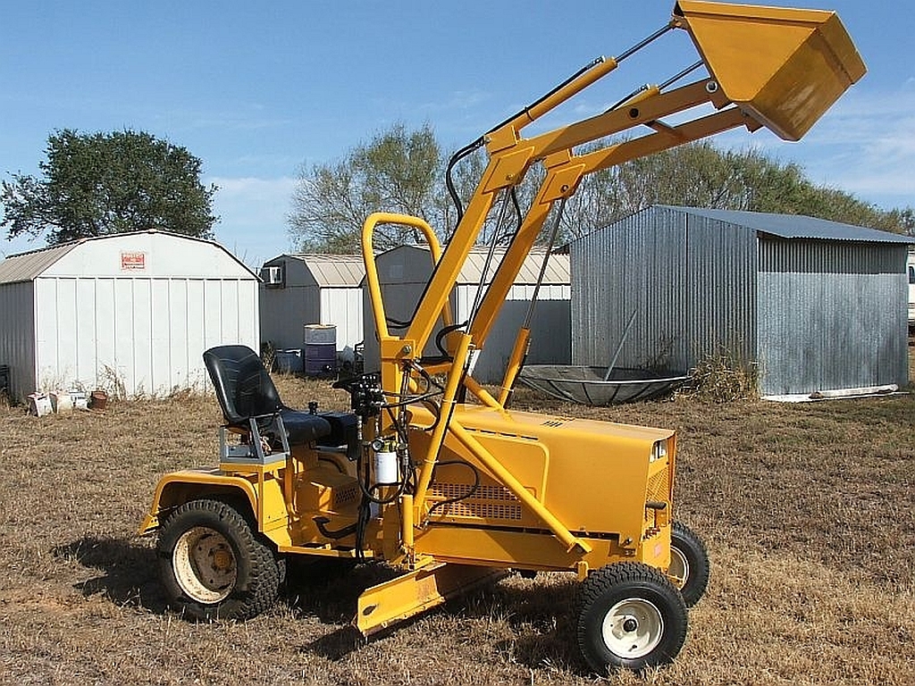

I've butt-welded a lot of sheet metal in my time. The trick is to skip around and have a hammer and dolly to work the welds. Skip back and forth from the inside of a weld line out. Don't weld the ends first--Not even tacks or you'll trap the expansion and warp the panel. If the panel was large, I used a wet rag to cool down a weld before moving to the next. Welds shrink. Some hammer and dolly work will stretch it back out. Don't be in a hurry.
The pictures below show the hood on the Kenbota as stock and after I added about 13-14" to it (I forget exactly). Absolutely no, none, zero, zip, zilch body filler was used. It's all metal work.
Original auction photo.
During the build.

Based on what I see, I'd be tempted to cut all the way back behind the louvers, and do all that as a replacement. That cut is so close to the louvers it's gonna be a helluva time trying to weld, sand, fill, etc. in there.
I've heard of guys clamping copper bars behind the butt weld on sheet metal; it absorbs the excess heat and helps keep the steel cool.
I would say a *thin* coat of body filler isn't anything to be afraid of- skim coatings of good quality material won't be an issue. They make heat resistant versions, flexible versions, whatever you want.
