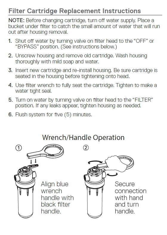

This is a new filter I have never delt with. I can't get the handle to move to shut it off. Is there a way to do it?

/ Water filter operation. #5
From the manual....
Where the manual shows a wrench being used I'm guessing it takes a bit of beef to turn the handle. Do you have the handle which is also used to remove the filter housing?

I can't turn the lever to shut it off...

That handle appears to be used to put the filter into bypass mode - it should be able to be turned with pressure in the system.
The manual page does show the wrench being used to move the handle - are you using the wrench to turn it?

I wound up turning the main off and releasing the pressure by the red button on top. I changed the filter that way. Still can't get the handle to move.

I have two almost identical to the one you pictured. And yes - it is so difficult to turn on/off that I'm always afraid of breaking the handle off. The only improvement I've come up with was soaking it with WD40 - with synthetic additive. That seemed to have helped a good bit, but it sure didn't make it easy.
If you decide to go with the WD40 solution, if/when you get it turned off, soak it again and work in the WD40.
