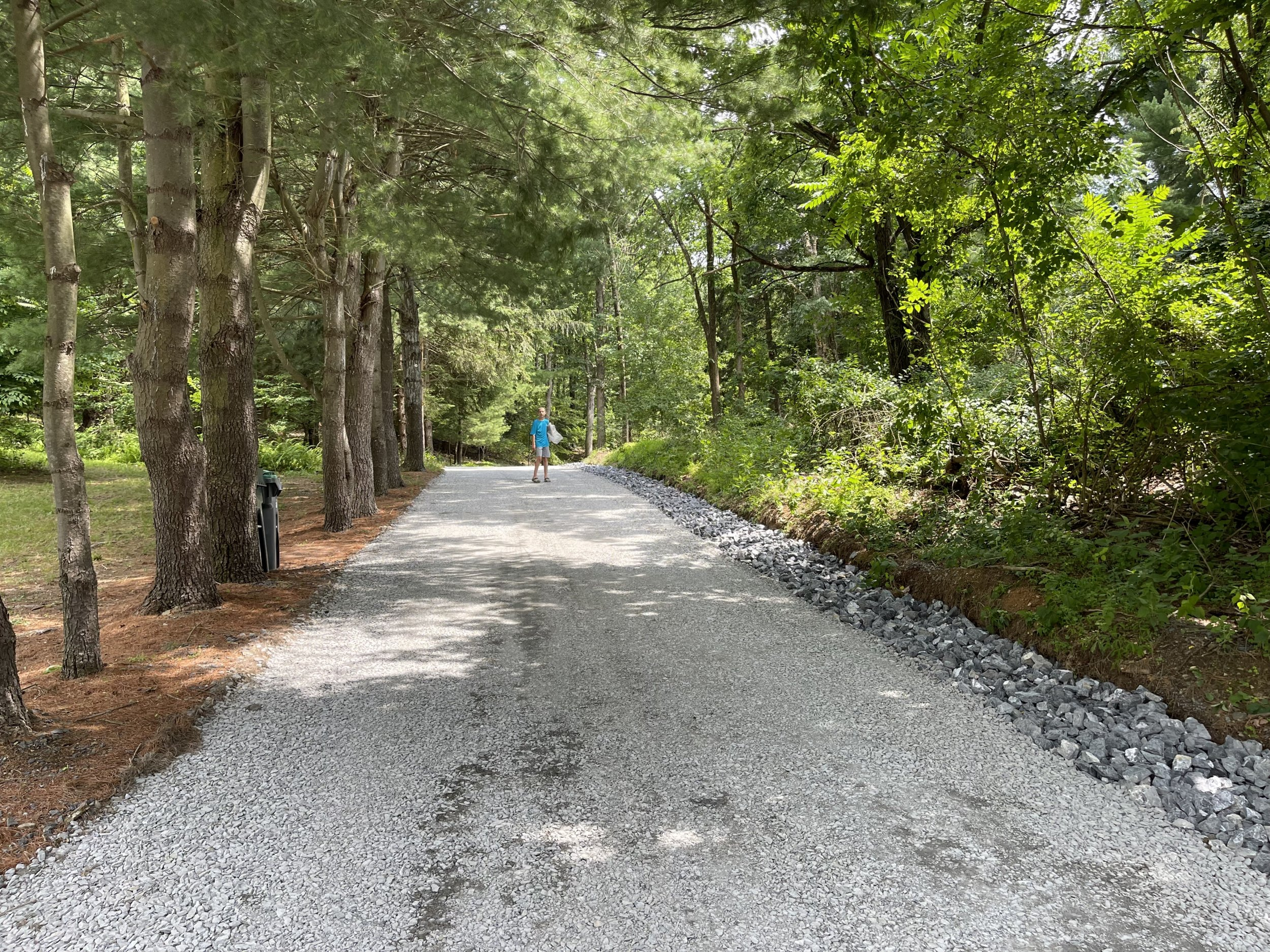

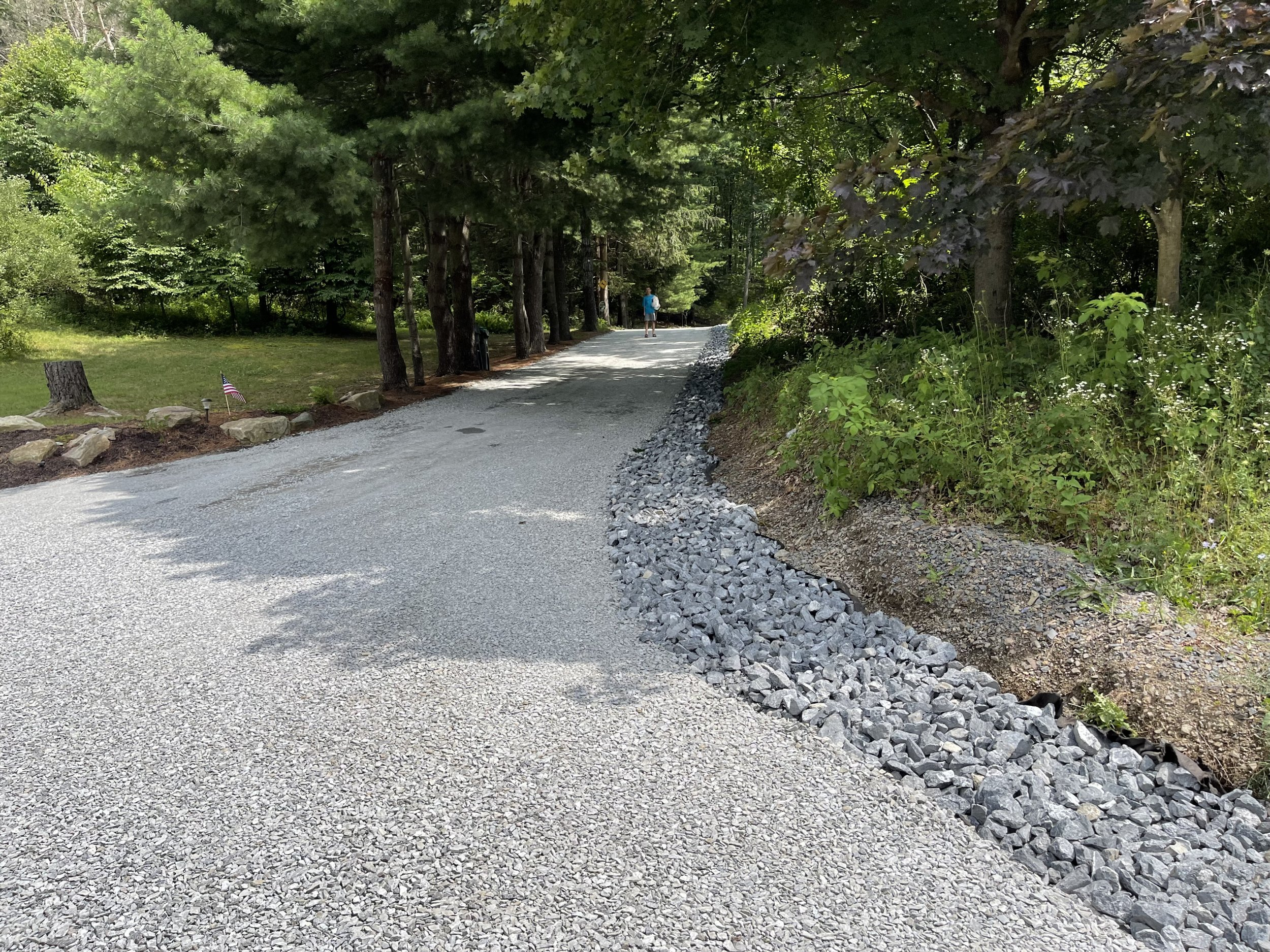

If you've got a picture of what a "rip rap" lined ditch looks like that might help.
Had similar problem on my steep driveway. Just had professional company come in and cut 2x2 ditch down the low side and fill with 4+ rip rap. Also lines it with fabric. Then regraded the lane to pitch that way and cut down the hills a bit. Then layed modified stone and compacted it thoroughly. Holding up great so far, but the real test will come next spring.

I hate riprap lined ditches. You can’t mow it. I’d rather have the erosion.
This is true! But with deep cut trenches from rushing water can you mow anyway? Not to mention if the sides of the ditch ate steep and depth of ditch may in itself prevent mowing. Each must decide which evil he wishes to endure. The rip-rap is hard on string trimmer lines as well.

The only three things you need to know about road maintenance are drainage, drainage, and drainage -- in that order!. The common solution is to line the ditch with stone, but first you need to be sure you have adequate cross-drainage. Check with AOT website or your town road commissioner for class three highway specs. Culverts should be a minimum of 15" diameter, laid an angle to the road, and at a proper depth--usually covered by same depth as culvert diam---15" cover for a 15" culvert. That may not be possible due to your ledge. Number of culverts and spacing is very important. It depends on grade of road. In VT rip-rap usually applies to big stone such as would be used to line an eroding stream bank--too big for your needs. See what your town uses, because they are going by State specs. Don't use stone from a gravel screening process, because it is round stone--you need crushed so it can lock together. Hay bales are only useful as a temporary solution--weeks or months, not years. Your principal objective needs to be diverting the water off the road, not just slowing it down.
