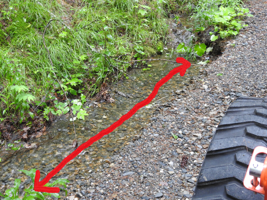

See attached photo, which unfortunately doesn't show the 10-12 vertical inch drop from driveway surface to water very well.
I have this drainage ditch along my gravel driveway feeding multiple culverts all in the hope it will keep my driveway from washing away.
Mostly it works. Most of the length of the driveway the bedrock is right at the base of the ditch. It probably is here too, the pebbles you see are the gravel it's constantly washing out of my driveway. So it's not something I can deepen with a tractor. I might be able to push it back a, but that probably wouldn't work unless I move the ditch back the whole length of the driveway, which isn't pragmatically feasible (trees, rocks, difficult spaces).
So need some way to line the driveway gravel so that the next rain won't just wash it out. I have no idea what to use. Cement / cinderblocks of some kind seems easiest, would that work? I'm looking for suggestions from people who have overcome this particular erosion problem.
I hate having to regularly throw more gravel (purchased by the truckload) at this problem.

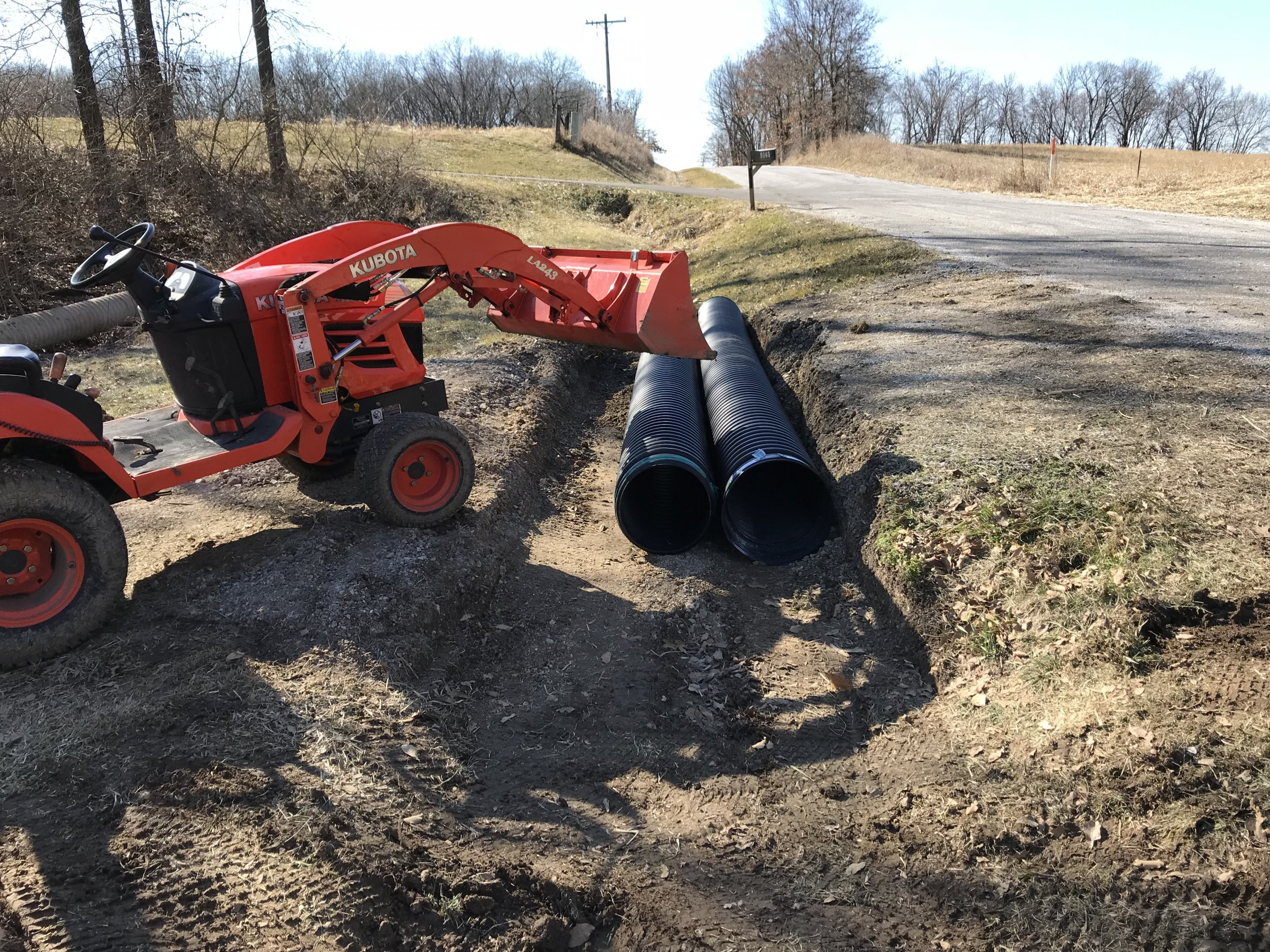

My solution after many years of the same problem was to install an 8" double walled corrugated pipe (whatever size as needed) down the driveway. Expensive but I installed 60 ft one year, 100 ft the next and so forth until it was complete. I found rerouting worked for a while.

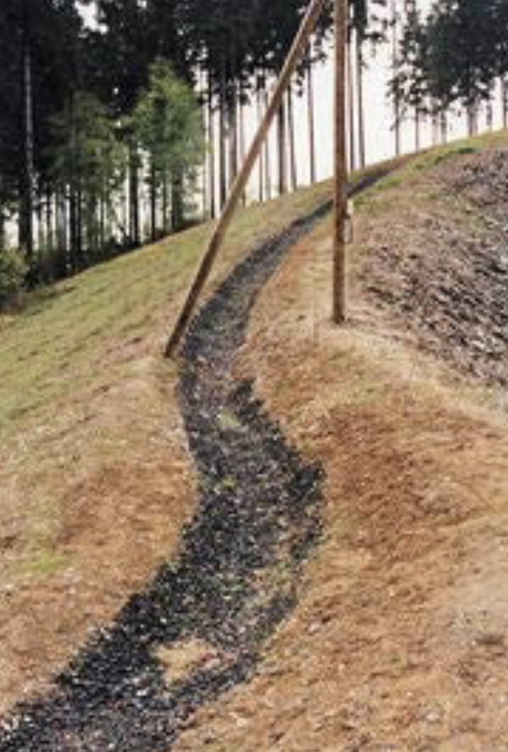

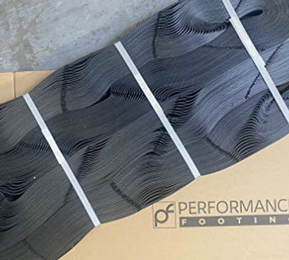

I have the same issue along one of my access roads that I’m about to rebuild. A few years ago I discovered a GeoTech Pocket product that comes in 9’x26’ segments that works for both roadbed and ditch purposes. It also allows water to migrate underneath the rock that drains well and really packs even better as it ages. My first use was putting a rock access driveway access to my 5th Wheel cover. It’s been in use for over 6 years and is designed for 20,000 lbs or more per squire foot. I used a 6” pocket, but for a ditch I would recommend 2” or 4” pocket. I’m going to us the 2” pocket on my 6% to 8% ditch grades and 4” pocket for the steepest 10% ditch grades. My water management ditch base design is 18” wide and 12” deep. Using 16” strip segments, I get 6.75 16” strips of 4” and 6”, or 175 feet of ditch lining per package. I have never lost gravel even at the swill entrance to a culvert or ditch turn location. Yes it costs, but so does the time and gravel lose I had beforehand. Hopefully this is useful. My first use was in TX, my new location is on a hillside driveway with lots of WA rain runoff. I’m attaching product images on design and layout.

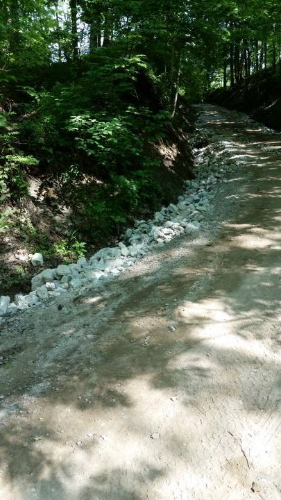

I spent 40 years building and repairing roads from dirt roads to superhighways and rip rapping sometimes by the mile and hundreds of tons. The bigger the rock, the better it will stay. On some jobs we individually placed huge rocks where you might get only 2 or 3 on a truck and weighing many tons. It all depends on the force of the water in flood conditions and how steep the slope is. The small stuff 4 inches and under are for dressing up that gently flowing brook in your backyard. Most of our jobs used man size that are up to 8 -12 inches. The step up from that are the large, up to 2-3 ft that must be placed with at least a backhoe. Most of the time we placed them on geo-textile to prevent erosion behind the rocks but if the slope is to steep the rocks can slide on the geo-textile. If you have vertical slopes you can use it against the bank and 2 or 3 feet into the stream to prevent washout and collapse behind the rocks. What we called shot rock, blasted from quarries is best because of the sharp edges and varying sizes locking together. Cobbles can be used and look nicer but can be moved easier under extreme conditions. Gabions are another option where space is limited and near vertical faces are necessary. They are large wire baskets in many sizes Seach gabions. Generally we used about 3 x 3 x 8 ft for road use, that are set in place and filled with smaller, generally 4" stone. I also saw but never built a used tire retaining wall that seemed to work well. You can search it online and find a lot of info.
Hope this helps with any size job you have.

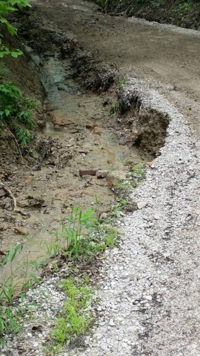

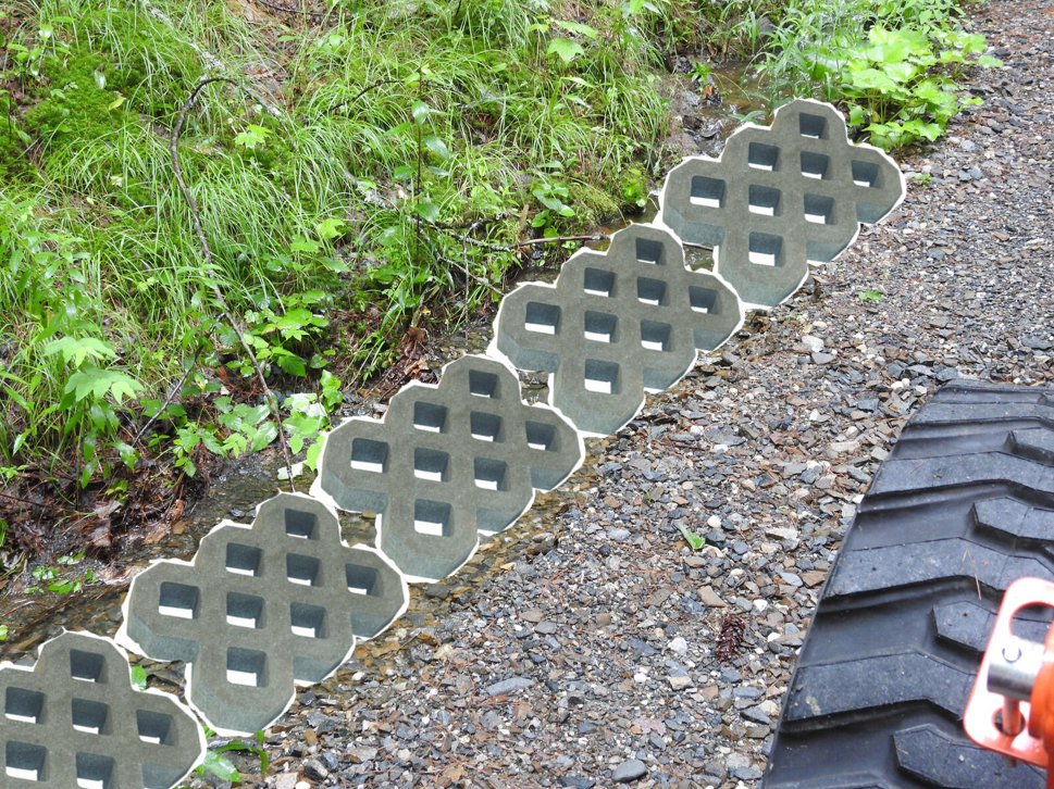

Your picture and description matches my driveway exactly. A friend [ who works for a concrete company ] suggested a v shaped curb that they often use along roads with big water flow. I haven't tried it yet, I'm saving up. It's a lot of concrete. Keep us posted.
