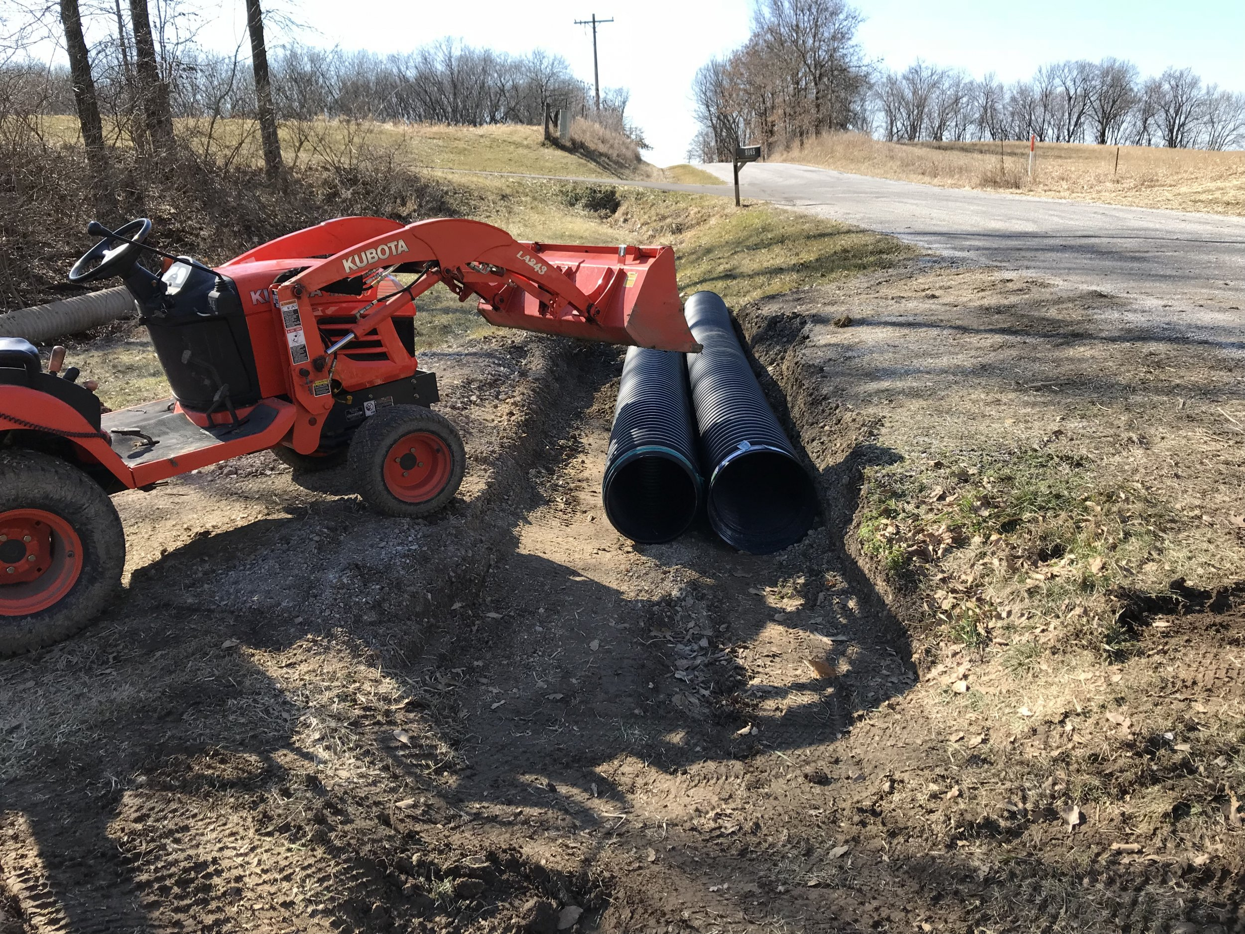

Sounds like you need bigger culverts or a second one. I have two driveways at my place. One paved and another gravel one that leads to a small storage building. The gravel drive had a single culvert that was to small and to short. People turned around in that drive and crushed the end. The water during a big rain would over top the culvert and run down the gravel drive and wash it out. I put in two new culverts instead of one and made them 10 feet longer.
In the pic is where I was installing the new culverts. They have handled the flow so far. The drive way runs left to right in the pic and our main road is on the right.View attachment 706644

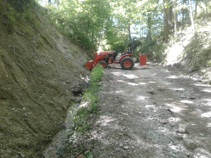

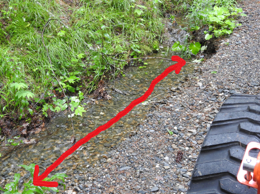

Just to better understand your problem, doesn't your washout show water running alongside your road - not across the road?
Washout across your road = undersized culverts.
Washout alongside your road = Water moving too fast / ditch too narrow/ ditch material not stable enough.
The problem I'm trying to solve in this thread is water running alongside the road. That is what does the most damage to my driveway. What I was hoping to find was a solution that would let me toughen up the face of the driveway material alongside which the water is running. So between your red arrow and the gravel on the right. Doesn't really matter how deep the ditch is if it continues to erode the material alongside it, undermining the driveway.
I did mention a "wash over" the top of the driveway in one storm, but it did relatively little damage, isn't a pervasive problem, and I'm, going to just chalk it up to the conditions of that particular storm (which occurred in december with ice, snow, & debris in the ditches).
From a cost & trouble standpoint, lining the driveway with these might be my best option: 4 in. x 8 in. x 16 in. Solid Concrete Block-30168621 - The Home Depot if I can make them stable. And I don't know enough about cement mixes to know if I can cement them together in a water resistant way. Cheaper and more solid than the paver blocks you suggested, but I'm looking at a vertical solution, not one on the bottom of the culvert which, when the little rocks are washed out (which all came from the driveway), is generally bedrock.

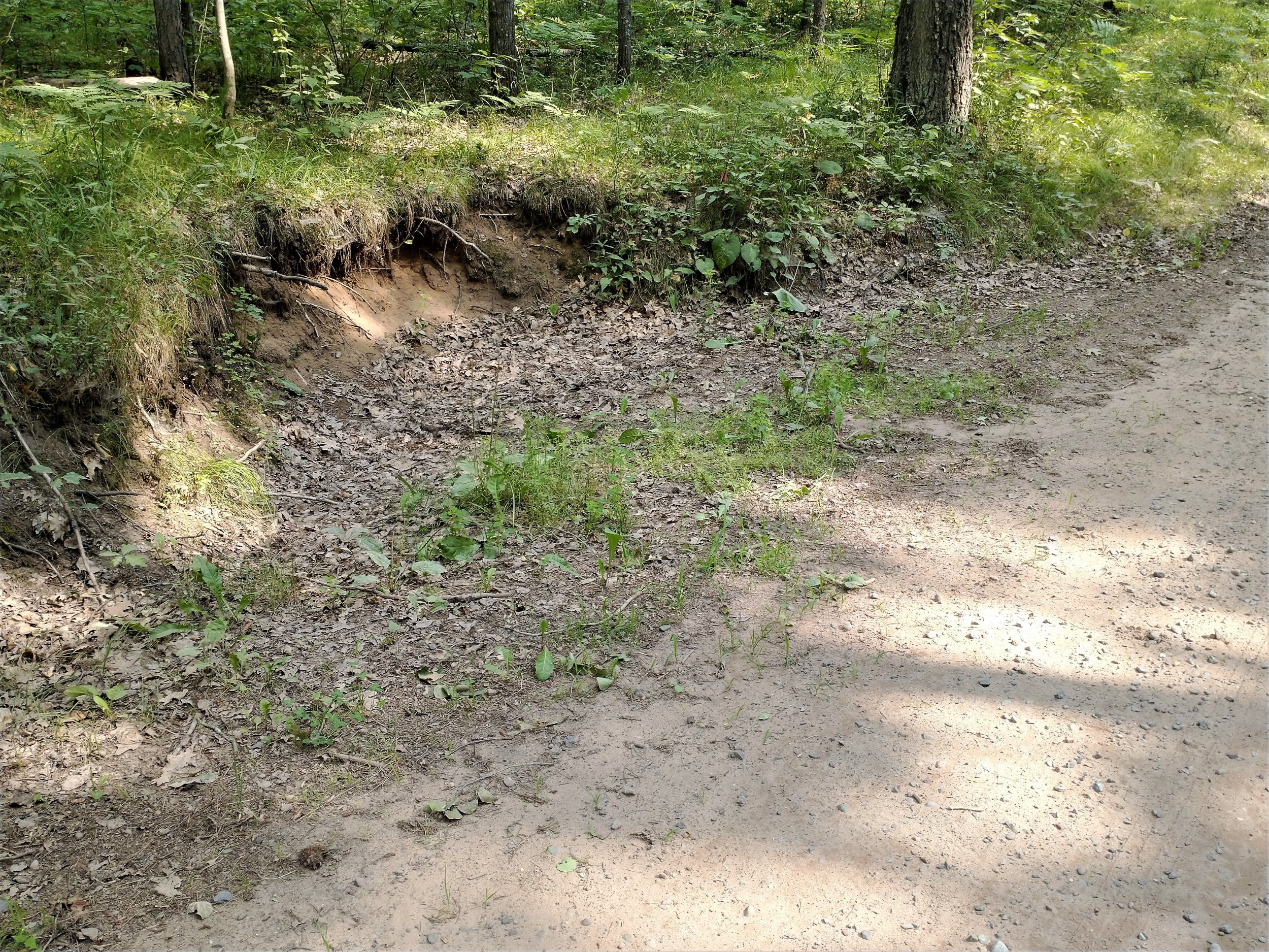

Myself, I've got a six foot high or more band of ledge on the high side of the road, with ledge defining the course, grade and slope of the roadway. Gravel was added OVER the solid rock to make the roadway surface, and it is anything but flat! Every rain washes away some of the small stone and fines that are there to hold it all together. It was all that could be done when the road went in. Short of blasting!

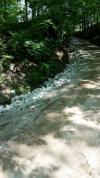

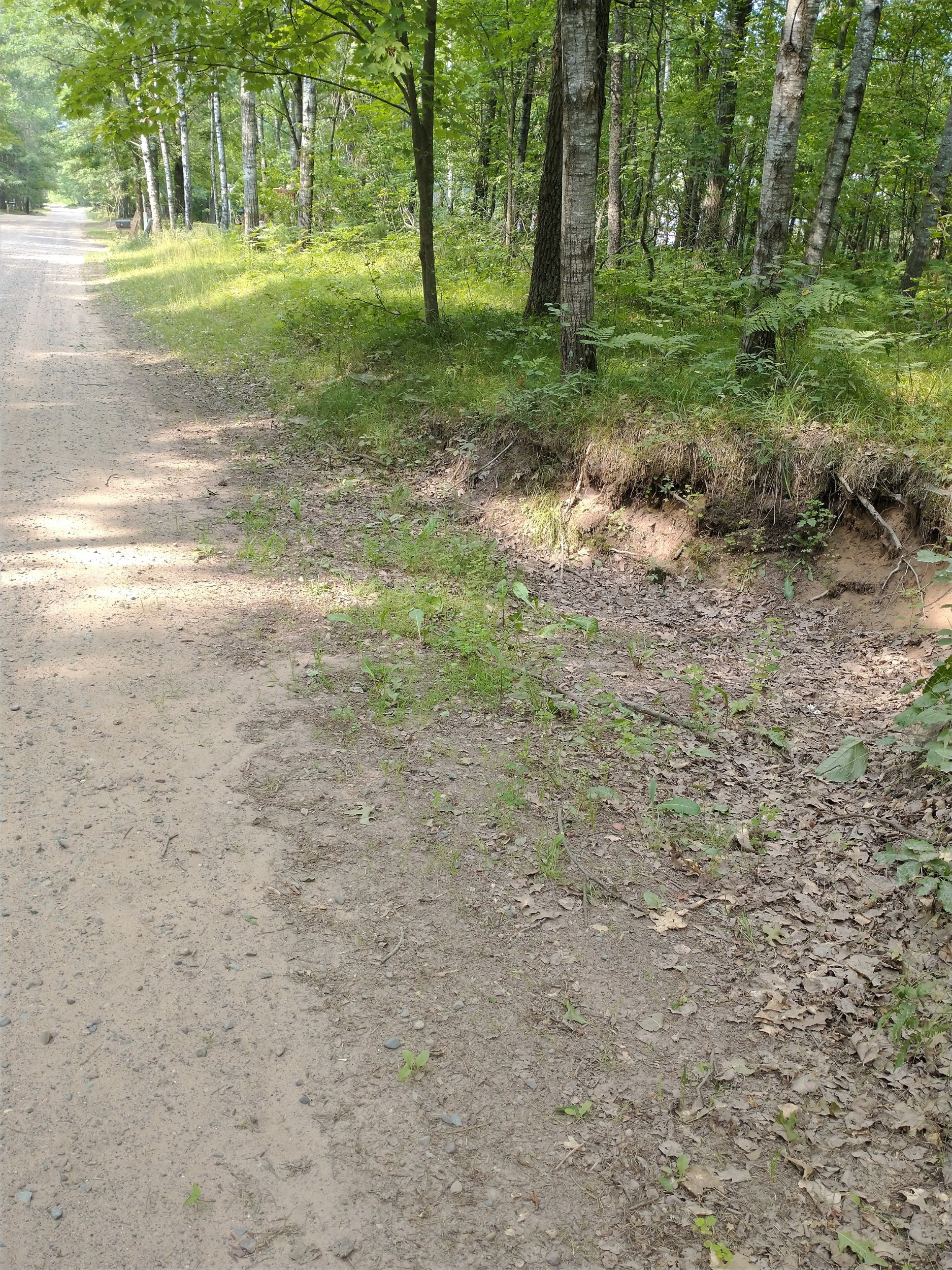

Had similar problem on my steep driveway. Just had professional company come in and cut 2x2 ditch down the low side and fill with 4+ rip rap. Also lines it with fabric. Then regraded the lane to pitch that way and cut down the hills a bit. Then layed modified stone and compacted it thoroughly. Holding up great so far, but the real test will come next spring.

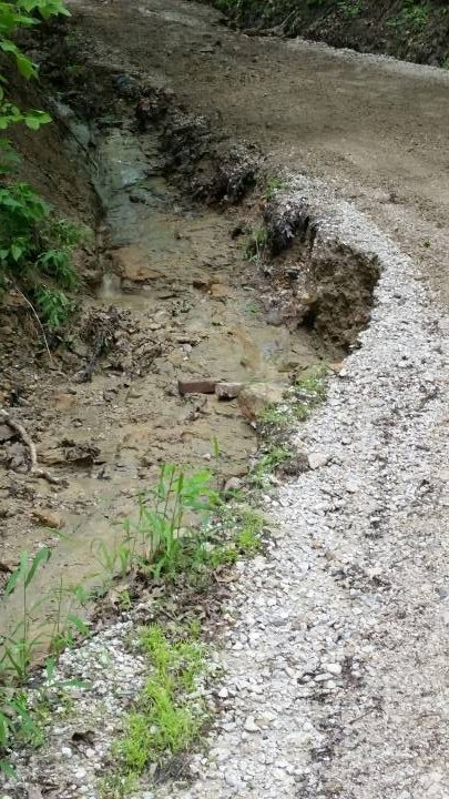

See attached photo, which unfortunately doesn't show the 10-12 vertical inch drop from driveway surface to water very well.
I have this drainage ditch along my gravel driveway feeding multiple culverts all in the hope it will keep my driveway from washing away.
Mostly it works. Most of the length of the driveway the bedrock is right at the base of the ditch. It probably is here too, the pebbles you see are the gravel it's constantly washing out of my driveway. So it's not something I can deepen with a tractor. I might be able to push it back a, but that probably wouldn't work unless I move the ditch back the whole length of the driveway, which isn't pragmatically feasible (trees, rocks, difficult spaces).
So need some way to line the driveway gravel so that the next rain won't just wash it out. I have no idea what to use. Cement / cinderblocks of some kind seems easiest, would that work? I'm looking for suggestions from people who have overcome this particular erosion problem.
I hate having to regularly throw more gravel (purchased by the truckload) at this problem.
Around here the county/state folks have used a cement poured liner over a 3/4+fines gravel lined ditch. On the steeper sections they make a kind of water slalom course in the cement (think poured cement brick shaped structures @ a 30-45 angle facing down slope) to slow down the water. So far the only thing really "trapped" in the slalom course are larger (4"+) branches, leaves etc, go through to the bottom where the culvert is. I doubt this would be an inexpensive fix, but our gravel roads haven't washed out since they put this system in place.
