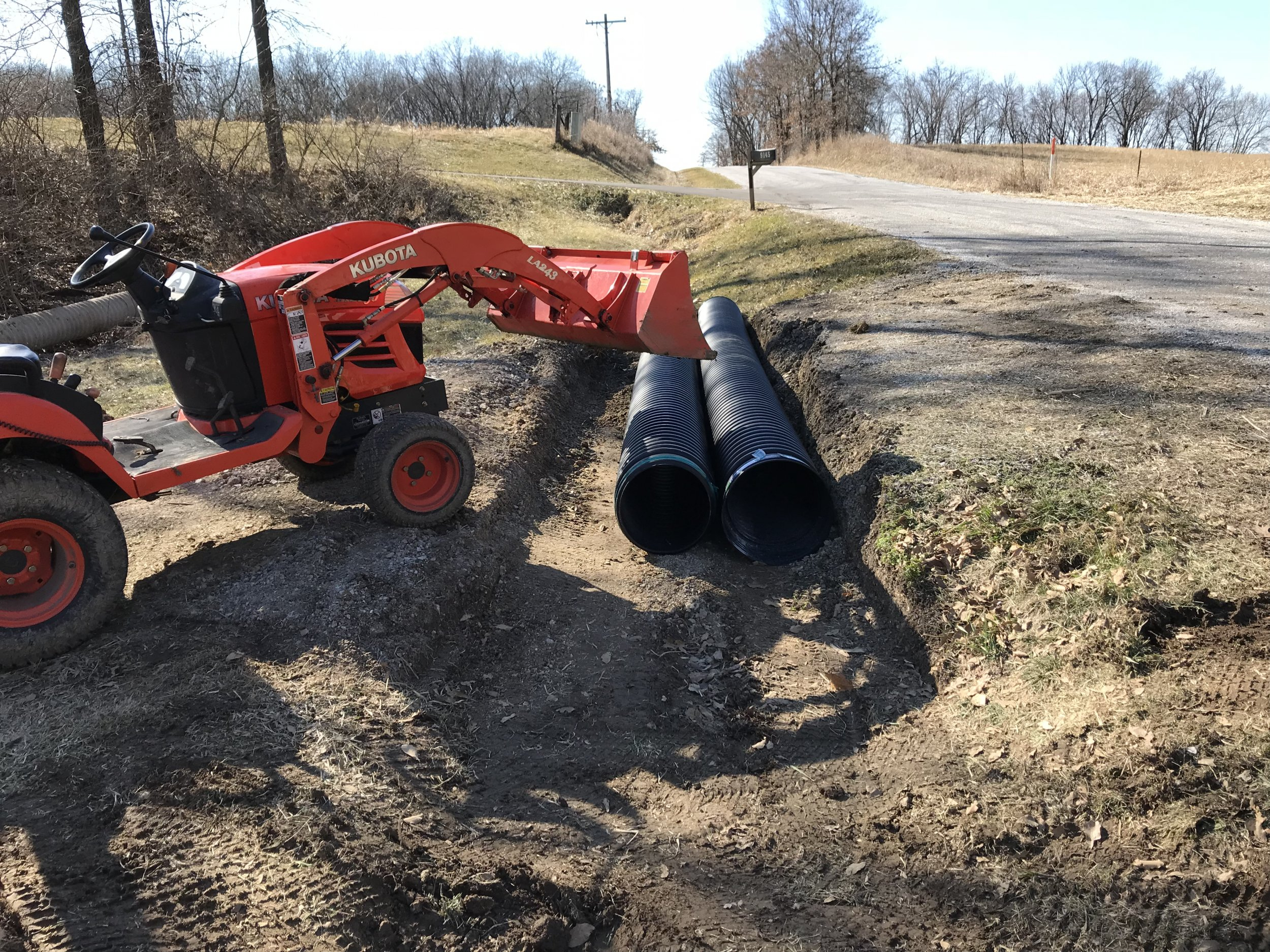

Sounds like you need bigger culverts or a second one. I have two driveways at my place. One paved and another gravel one that leads to a small storage building. The gravel drive had a single culvert that was to small and to short. People turned around in that drive and crushed the end. The water during a big rain would over top the culvert and run down the gravel drive and wash it out. I put in two new culverts instead of one and made them 10 feet longer.
In the pic is where I was installing the new culverts. They have handled the flow so far. The drive way runs left to right in the pic and our main road is on the right.View attachment 706644

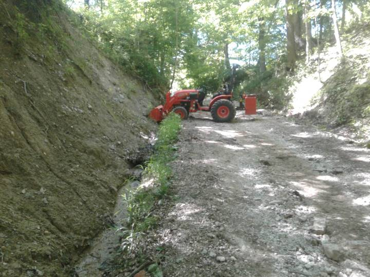

Ah, wide open space and unencumbered tractor operations in three dimensional space. You're living the dream!

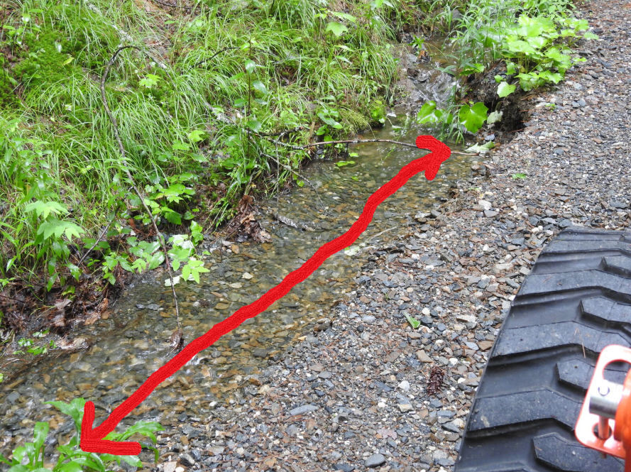

Just to better understand your problem, doesn't your washout show water running alongside your road - not across the road?
Washout across your road = undersized culverts.
Washout alongside your road = Water moving too fast / ditch too narrow/ ditch material not stable enough.
The problem I'm trying to solve in this thread is water running alongside the road. That is what does the most damage to my driveway. What I was hoping to find was a solution that would let me toughen up the face of the driveway material alongside which the water is running. So between your red arrow and the gravel on the right. Doesn't really matter how deep the ditch is if it continues to erode the material alongside it, undermining the driveway.
I did mention a "wash over" the top of the driveway in one storm, but it did relatively little damage, isn't a pervasive problem, and I'm, going to just chalk it up to the conditions of that particular storm (which occurred in december with ice, snow, & debris in the ditches).
From a cost & trouble standpoint, lining the driveway with these might be my best option: 4 in. x 8 in. x 16 in. Solid Concrete Block-30168621 - The Home Depot if I can make them stable. And I don't know enough about cement mixes to know if I can cement them together in a water resistant way. Cheaper and more solid than the paver blocks you suggested, but I'm looking at a vertical solution, not one on the bottom of the culvert which, when the little rocks are washed out (which all came from the driveway), is generally bedrock.
Isn't a nightmare also a dream?

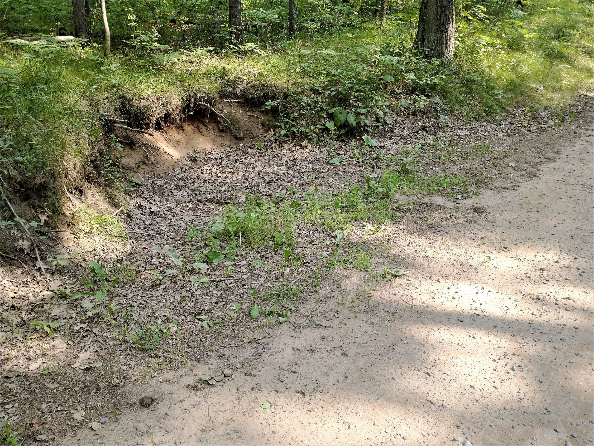

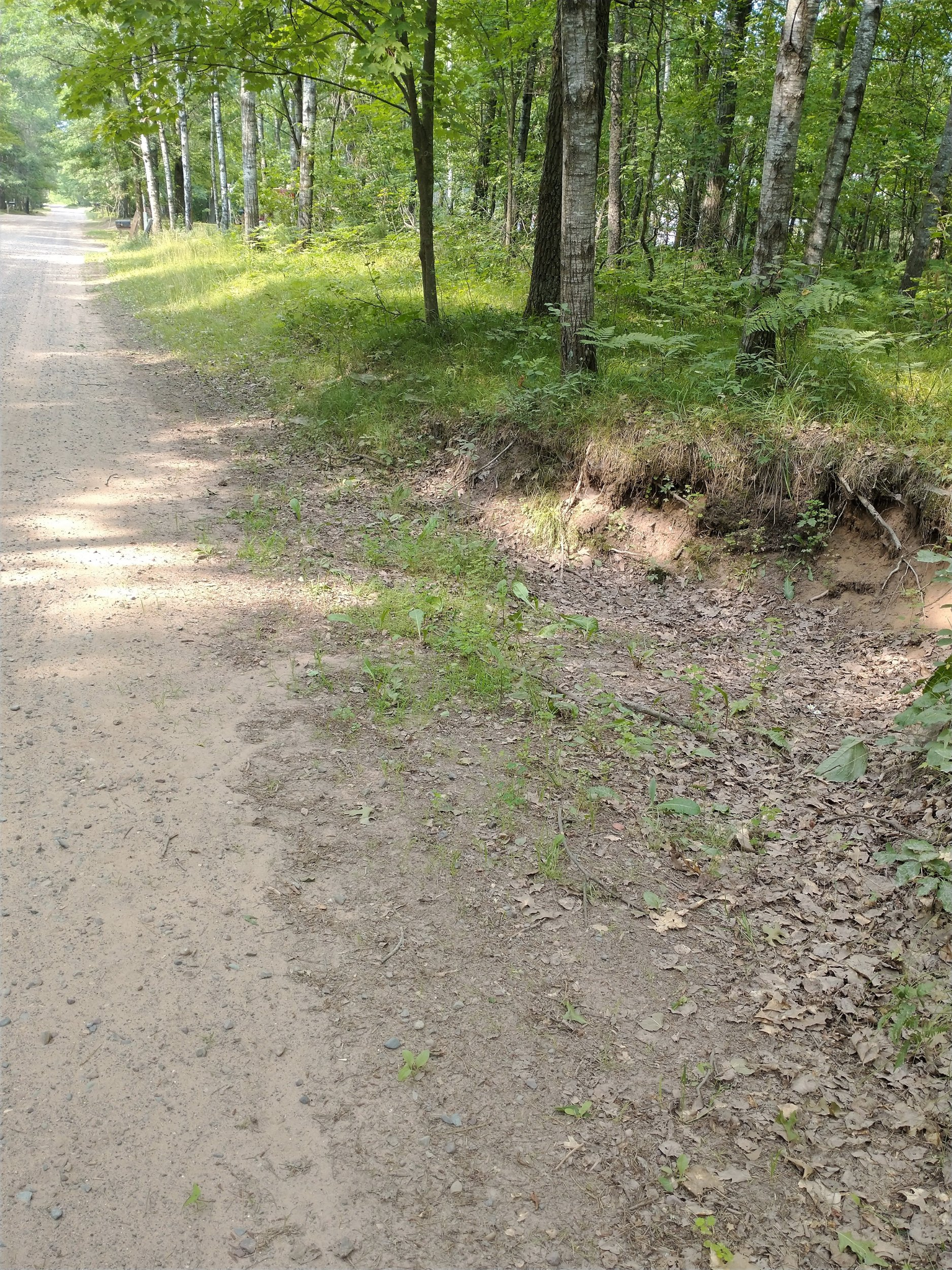

You don't have to widen all of the ditch - just bump out a swale here and there to slow and capture the water.
You are so fortunate to have such flat, level and open lands.
My situation, and it seems to be that of the OP, is much less available to such accommodations.
Myself, I've got a six foot high or more band of ledge on the high side of the road, with ledge defining the course, grade and slope of the roadway. Gravel was added OVER the solid rock to make the roadway surface, and it is anything but flat! Every rain washes away some of the small stone and fines that are there to hold it all together. It was all that could be done when the road went in. Short of blasting!
