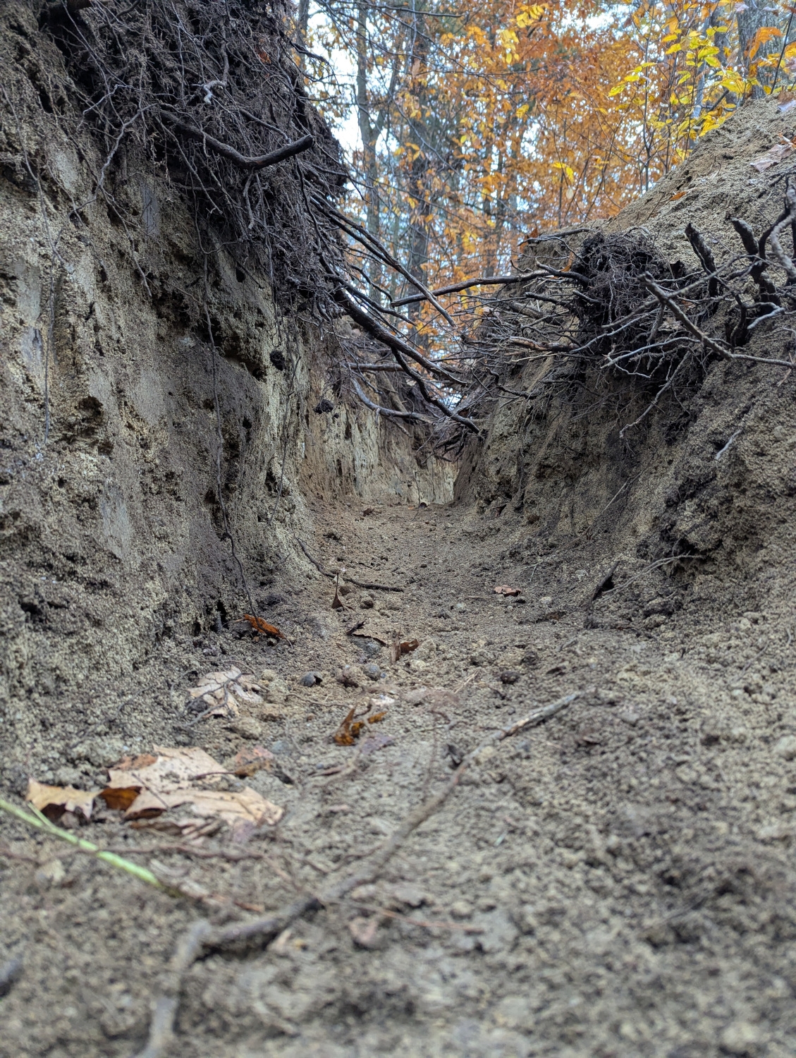

Wish I could did a trench in 45 minutes. Tractor backhoe and the path just doesn't allow for that

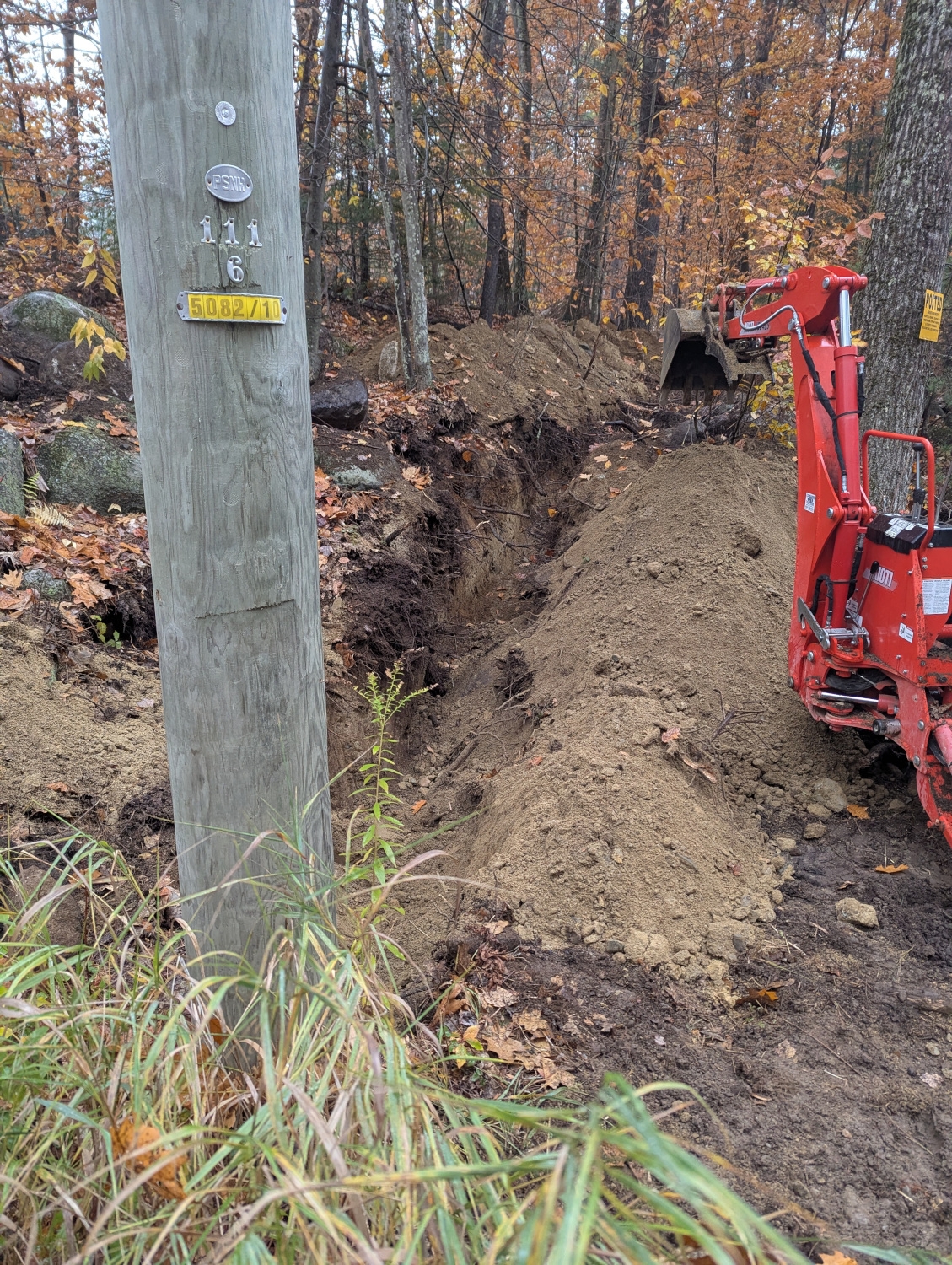

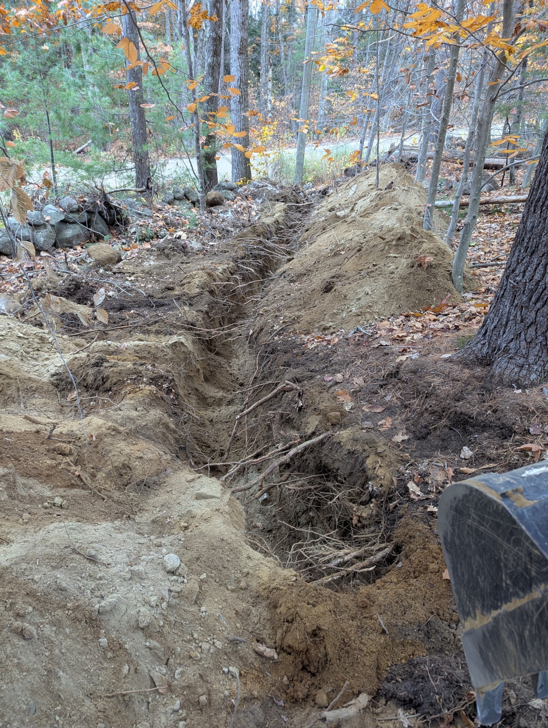

A couple other image. Working at the pole was challenging.
