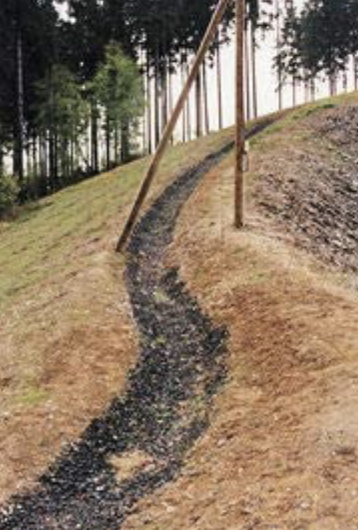

I don't know if this will help your issue but I had a a problem holding a pond over flow. I took old car tires cut out one side wall and bolted them in a grid cut out side up and filled them up with rip rap. The tires kept the rip rap in place and silt filed in and Bermuda grass took over and now you do not see the fix.

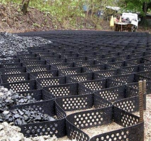

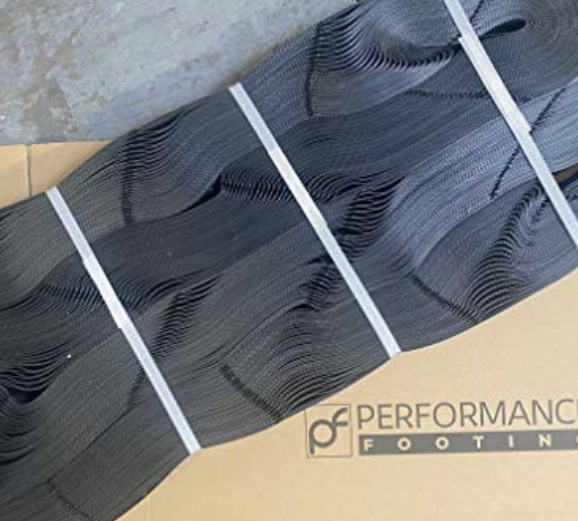

I have the same issue along one of my access roads that I’m about to rebuild. A few years ago I discovered a GeoTech Pocket product that comes in 9’x26’ segments that works for both roadbed and ditch purposes. It also allows water to migrate underneath the rock that drains well and really packs even better as it ages. My first use was putting a rock access driveway access to my 5th Wheel cover. It’s been in use for over 6 years and is designed for 20,000 lbs or more per squire foot. I used a 6” pocket, but for a ditch I would recommend 2” or 4” pocket. I’m going to us the 2” pocket on my 6% to 8% ditch grades and 4” pocket for the steepest 10% ditch grades. My water management ditch base design is 18” wide and 12” deep. Using 16” strip segments, I get 6.75 16” strips of 4” and 6”, or 175 feet of ditch lining per package. I have never lost gravel even at the swill entrance to a culvert or ditch turn location. Yes it costs, but so does the time and gravel lose I had beforehand. Hopefully this is useful. My first use was in TX, my new location is on a hillside driveway with lots of WA rain runoff. I’m attaching product images on design and layout.
