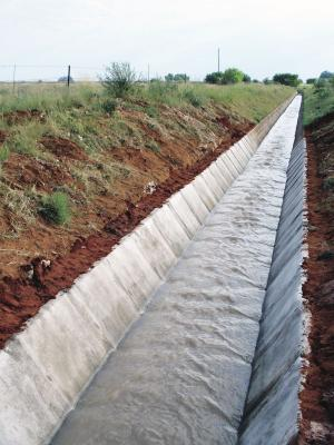

A commercial product we have used on a number of road and highway projects is becoming widely available in the US. It's known as Concrete Cloth or Concrete Canvas. Essentially a roll of two layers of fabric (usually geosynthetic or canvas) with a layer of cement/fiber/sand sandwiched between. It comes dry and wrapped up in a roll, and comes in several thicknesses depending on expected conditions. You roll it out, either in overlapping transverse sections if it is a wide ditch or channel, or longitudinally if it's a narrow ditch. You should toe it in at the top of the ditch or channel. Once it's in place, you wet it down. The cement mixture sets up, and you have an impervious "relatively" quick concrete ditch lining. It comes in various widths and roll lengths. There used to just be one supplier in the US, but I see that a number of companies are now producing and selling it. You can probably find it at a commercial building materials supplier. Be aware, it's not cheap (placing a cast-in-place concrete ditch is slightly cheaper), but it's quick to install, and pretty much instant and permanent. You can do a search on Youtube for Concrete Canvas or Concrete Cloth for videos to see how it's installed and used. The British have also used it to make "permanent" inflatable shelters for military and medical use - pretty cool stuff!

Looks like it may be a great but expensive solution for bank stabilization.

Seeing as you're in Wisconsin, I have to ask - how does this stuff hold up to frost-thaw cycling and mud season?
Winter in New England is a whole-nother aspect of road and drainage construction that has to be solved to get a result that works and lasts.
