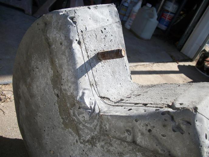

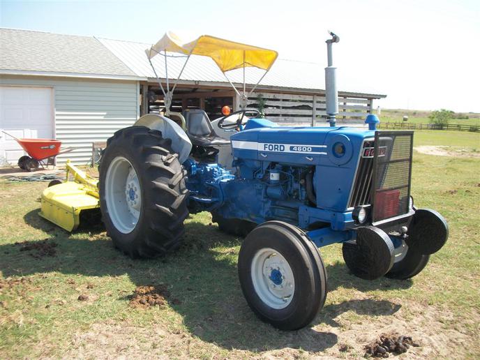

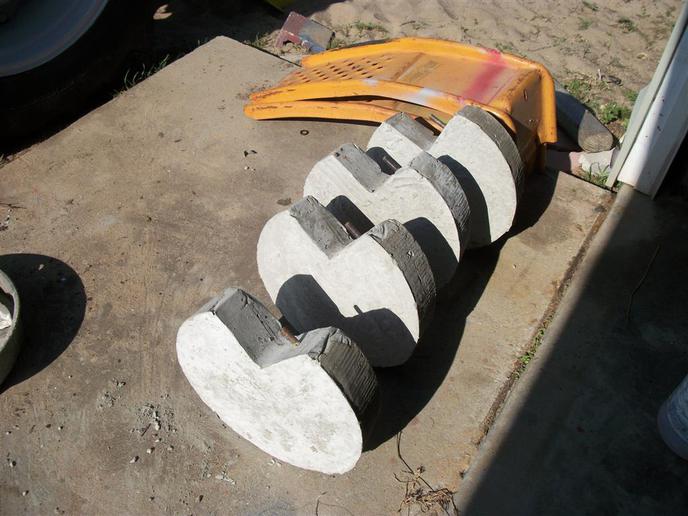

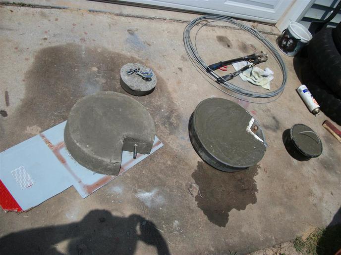

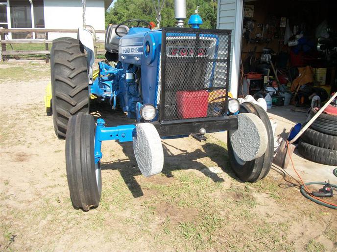

if I loaded with water / methanol..e tc.. and needed 200 more pounds, vs not being able to afford beet juice, or wanting to risk the cacl. I'm sure some cast concrete weights on the axle or frame could be made up cheap.
I cast some front concrete weights for my ford 4600 for mowing I have a real HD and hvy hog behind her, loaded the fronts with water and rv af, and put on front wheel weights, AND hung 2 concrete 'plate' weights on her I made and now she is stable walking up the beaver tail on my deckover gooseneck with mower lifted to clear everything. before she was a teeter-totter..
weights cost me less than 10$ in concrete.. used old fence wire and old bolts as studs..
soundguy
