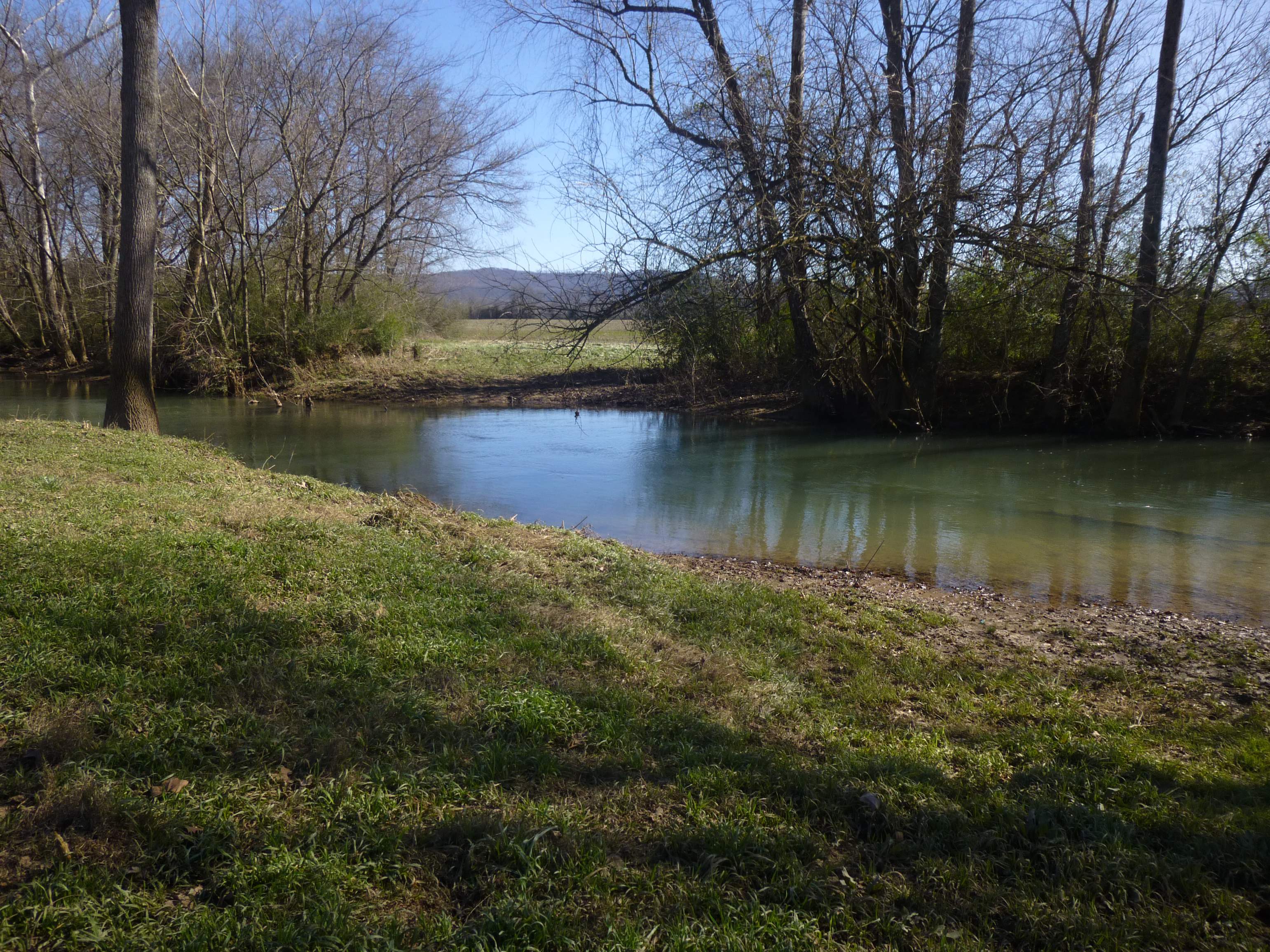

Hi Guys,
We've got a fairly large creek that runs thru our property that varies in width and depth depending on time of year. It has been dry lately so it is about 30 feet across and about 1 and 1/2 to 2 ft deep. Much of the year it is impassable due to rain.
When I can I put gravel down this time of year just to keep it from getting too muddy so my tractor doesn't get stuck crossing. I save a lot of time crossing at the creek - but I can go down the road to access the other side of our property... just takes a lot longer. A old farmer and friend of the family came by yesterday and said that a lot of times sand will get in the bearings when crossing the creek and I would do better keeping it out of there. I had not considered that before.
I've crossed the creek plenty of times on our Massey Ferguson 1080 with no problem - but I've just started doing it on the MX5100 Kubota 4wd that sits much lower. I'm now thinking maybe I need to be more careful. I'm kind of bummed out about it since the kubota has a front in loader and I can maintain the crossing with it much better.
Whats the risk of damaging my tractor if I just do it occasionally?

I'd have concern about that contamination in the bearings. It's probably safe enough, as long as the water is below your axles but that would be my limit.

I would get some coarse rock and backfill the creek with enough rock to make a low water crossing so that the water flowed across but not up past the axles of the tractor. That is what I did on the creek thru my place. Just make sure that the water is not backing up on someone else due to the damming. This shouldn't be a problem with raising the ground level a foot or so.
I don't think you would have any issue with crossing that as is occasionally as it seems to be clear flowing water so not likely to have a lot of sand in it.

As others have said I would not worry about crossing the creek as long as you keep the water below the axles. Remember the front end if four wheel drive. Farmers years ago forged streams all the time with tractors.

Water should be avoided. Seals keep lubricating fluids where they need to be and help to prevent outside contamination of the lubricants. Water is much thinner than lubricants and the seals simply are not designed to keep water out when submerged. The tolerances required for the seals to seal the lubrication in and dirt out isn't not as tight as would be required to keep water out. To seal against water would require tighter tolerances and would wear faster.
Every manual for every type of gearbox I've read whether it's been a differential in an axle, or a transmission, or a transfer case; they've all said to change fluids after having the gearbox submerged to a certain level. With axles it is generally anytime water reaches the hubs.

I would be more concerned about going over the vent tubes on the differentials. A warm differential will let in water easier than a seal. 4 wheelers usually relocate the vent tubes to avoid this. Water in the pumpkin is real bad, especially in the winter when it freezes and expands.

I wouldn't bother with the expense or hassle of building your own bridge if you can just drive down to a perfectly good bridge already there. Since you are only concerned with crossing the creek when the water is low, I would just make sure that you have vent lines from your axles up higher then the water will ever get to. If you have greasable bearings, most tractors don't, then grease them after crossing the creek. Water in the bearings or in the oil inside your axles and differentials would cause excessive wear. If you can keep the water out, then it's nothing to think twice about.

How much do you cross?? If it is just an occasional crossing I would not worry about it if you do not go above the vent tubes. Water may be thinner than oil but It's not like you are parking it in the middle of the stream and leaving it there. How much water can enter a theoretically sealed unit in the very short time it takes to cross it. Like Eddie said check out the vents and know where they are. If you can raise the tube higher, all the better.

As covered, getting water into differentials and other powertrain components is never good.
For things with grease fittings, consider a good marine grade of grease, if you aren't using this already. It is formulated to resist water washout and contamination more so than general purpose grease.
