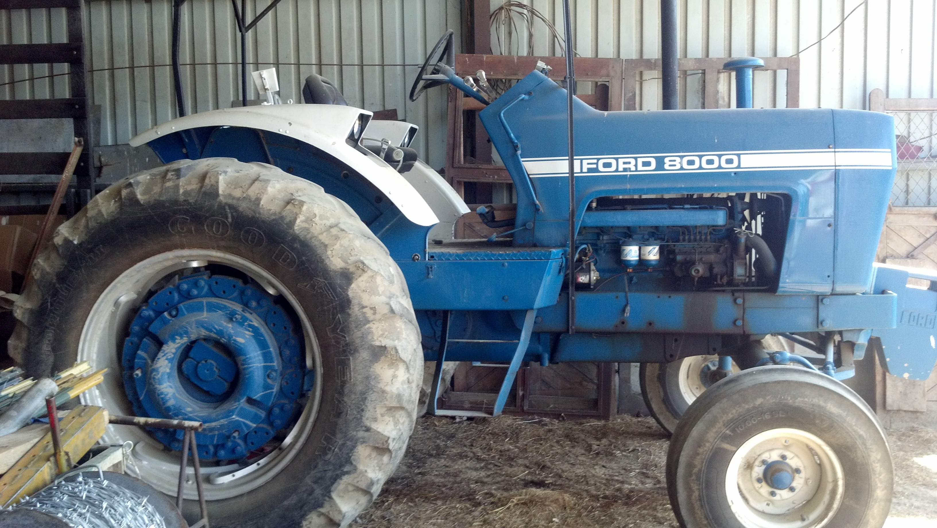

Got a soft spot in my heart for the older Ford 8000's we got ours in 1968 brand spanking new, full rack of front weight and a large stack of rear wheel weights along with a 5 bottom 18" moldboard plows with the hydraulic side hill hitch (2 point) semi-mounted.
And she's still on the farm and even gets used a bit.
View attachment 4382585View attachment 4382586
I'm a little late to the dance Lou, but that's a really nice old Ford 8000 . . . (y)
