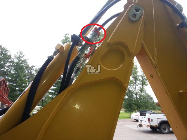

If the hoe doesnt have a thumb or hydraulic hose connectors for a thumb etc., does that mean there isnt a plumbing for it on the tractor end? Im looking at one that has a top and tilt and hydraulic ripper teeth (i assume with the small switch on the joystick), so does that mean the plumbing is there for the thumb? Seller says its not plumbed for a thumb, but it has the top and tilt with rippers.
/ Used JD 110 vs everything else #89
How underpowered is the 110? Does the 42/33HP rating feel that low? Someone just mentioned putting a 7ft Gannon box blade on the back. Can the 110 actually handle the blade? My Massey is 47/36HP rated... And there are times when plowing, grading, and stump grinding when I start to run low on power (but in fairness, I tend to grade/disc in medium range HST, so staying in low would help)... In theory, could I replace my Massey with the 110 and have comparable power? Or is the 42/33 pretty accurate?
/ Used JD 110 vs everything else #90
The tractor can have 3 FEL functions and 3 rear SCV's. The joystick diverts the hyd functions back and forth as well as controlling the 3rd function on the loader.
Total hyd functions would then be six. As Steve mentioned, the thumb function on on the backhoe would be the 7th hyd connection.
So, just having the rear hyds (topntilt) would not necessarily mean that the tractor is plumbed for a thumb. It's been my experience if the hoe is plumbed for a thumb you can readily see the hard lines and the quick couplers on the top of the boom near the dipper stick.

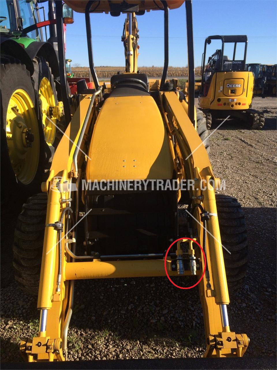

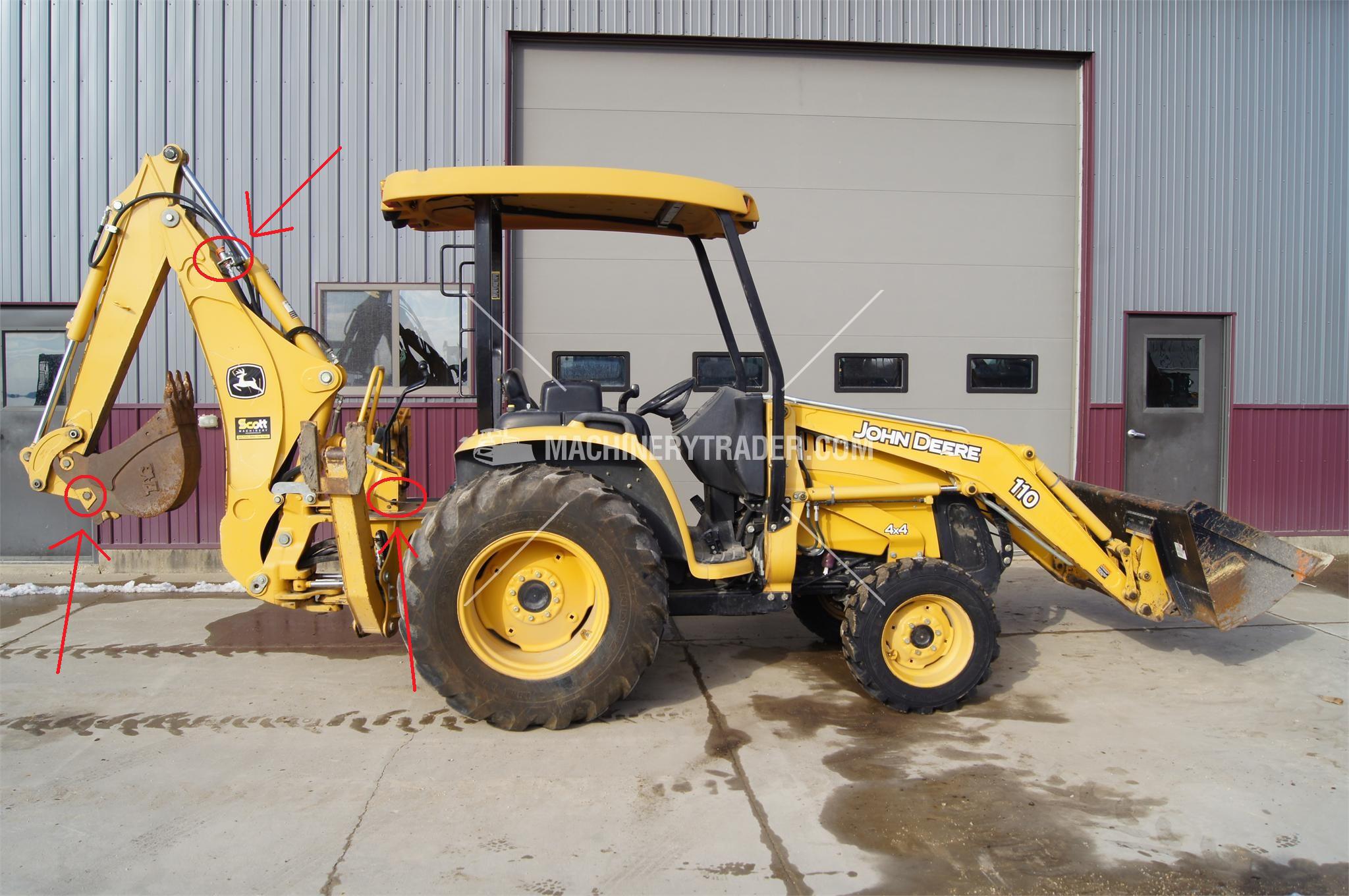

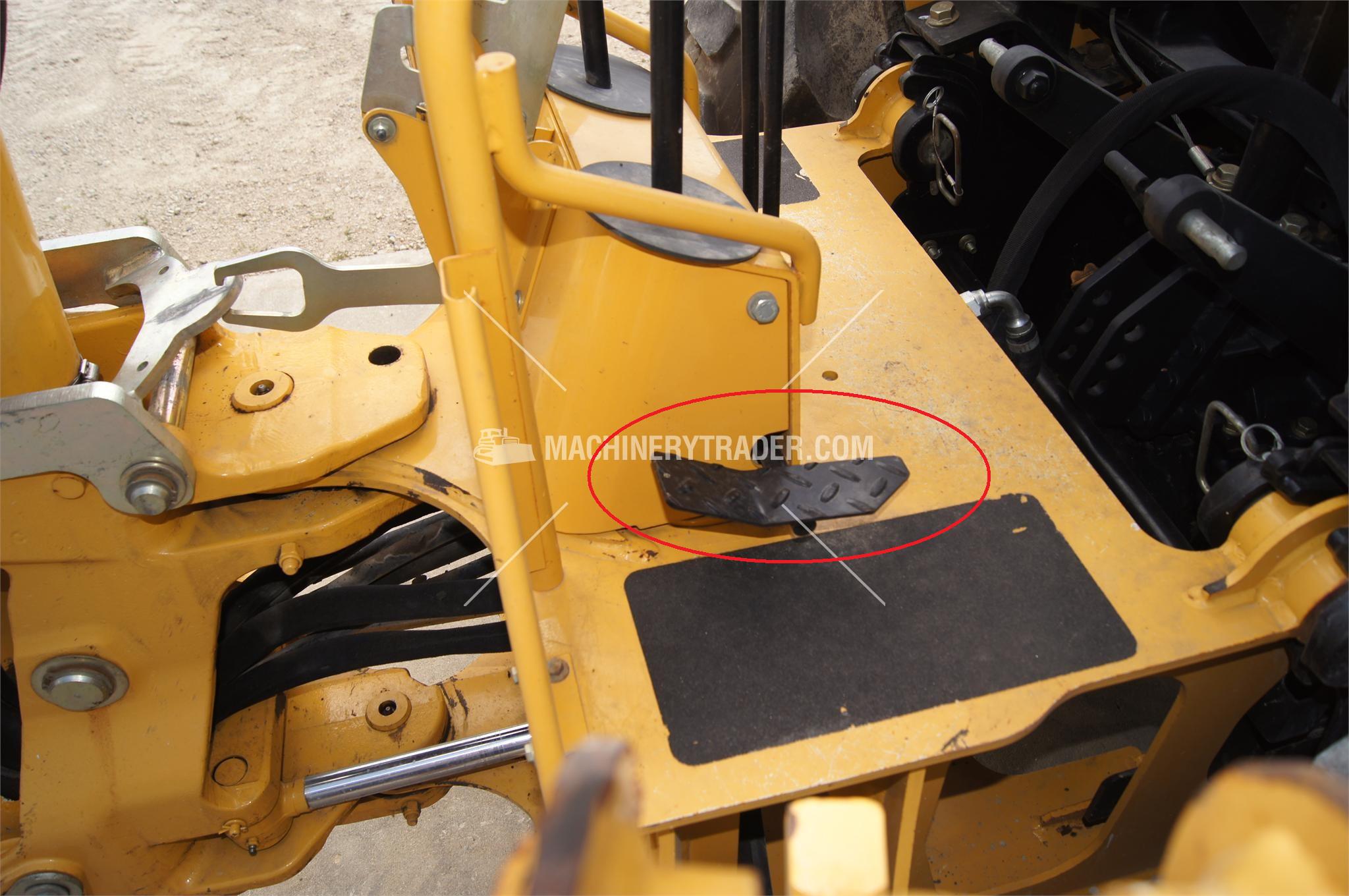

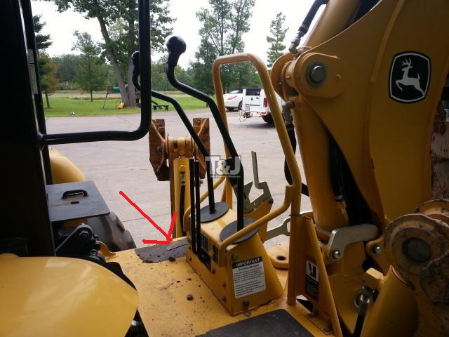

If you look at the 1st photo you can see this 110 is set up for a thumb, it has the quick attach bucket, the foot pedal control and the quick attach couplers.
3.jpg the quick attach couplers on the top of the boom near the dipper stick
謬op & Tilt Cylinders on 3 point hitch.jpg aux hydraulics (for top n tilt)
0.jpg front hydraulics
