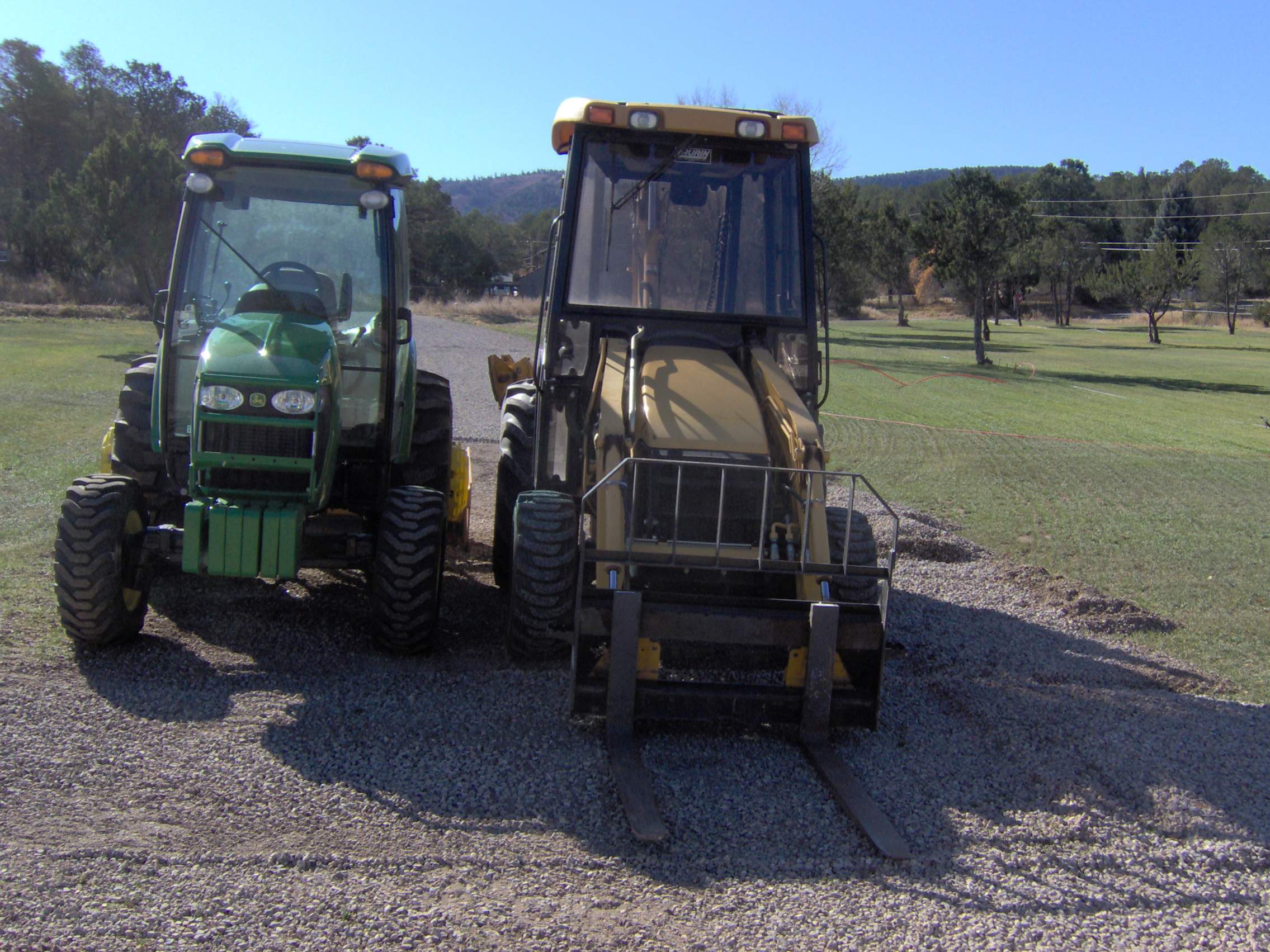

Those of you with experience with the 110, how capable is the backhoe in regards to small excavation work like digging out stumps and general lot clearing / site prep?
I'm not talking about clearing 10 acres, but I do work for some developers clearing residential lots, up to an acre usually.
Thanks in advance.
Deere no longer builds a 110. IMHO - if you're seriously considering a small, commercial grade TLB - look for a Kubota.
Guys in the business - with enough work - have gone to skid steers and a mini-x. That's a big investment that starting out of the blocks is darn hard to bite off!
What you've described appears like a L45 Kubota fit.
If I ever sell my 110; I'll be lookin' for a Kubota.

I've compared the specs between the L39/45 & the 110... & they seem pretty close.
I wouldn't be able to buy new right now anyhow, so I'd be looking at used. There are a couple reasonably priced used 110's in my area (high hours tho) and the older L48's as well. The plus side to Kubota is that I have a dealer about 3 miles up the road, and the JD dealer near me, only 5 miles, appears to sell just green JD, so I'm not sure how capable they'd be at servicing yellow.
What are your thoughts on the older L48's ? And, what would make you choose am L45 over a 110 anyhow, considering they were both used with comparable hours and price?
The complaint that I recall about the L48 had to do with the transmission speeds. Specifically, low was too low and the 2nd range was too high.
That alone would steer me towards the L45. I sat on a L39 and felt it was too "small". I know it doesn't look too bad on paper.. But, I just couldn't get past the sense that it would not measure up to the work.
I don't think I would "choose" a L45 over a similarity equipped 110 - every thing being equal. But, I'd be very surprised that you'll be able to find a mid-hour 110 with all the options that I consider to be a "deal-breaker" if not present, for much less than $36-38K.
That puts the whole deal into striking range for a new L45. Especially, with good financing terms and warranty.
(But.... I have NOT priced out a well-optioned L45, either. Could be $50K!)
