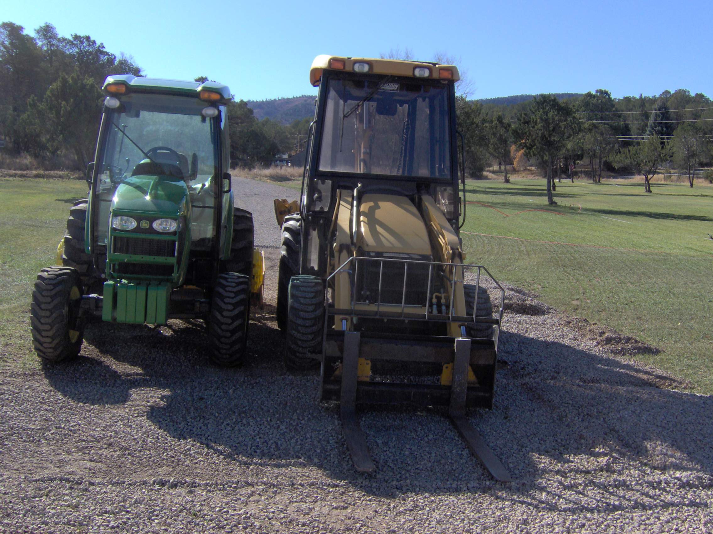

I agree with Larry on all of the above. The 110 is very great for tlb use and is a good stand by tractor with the 3ph. The 4520 is better for pto work and other jobs requiring more hp.
Cabs in both cases were a good decision imo.
