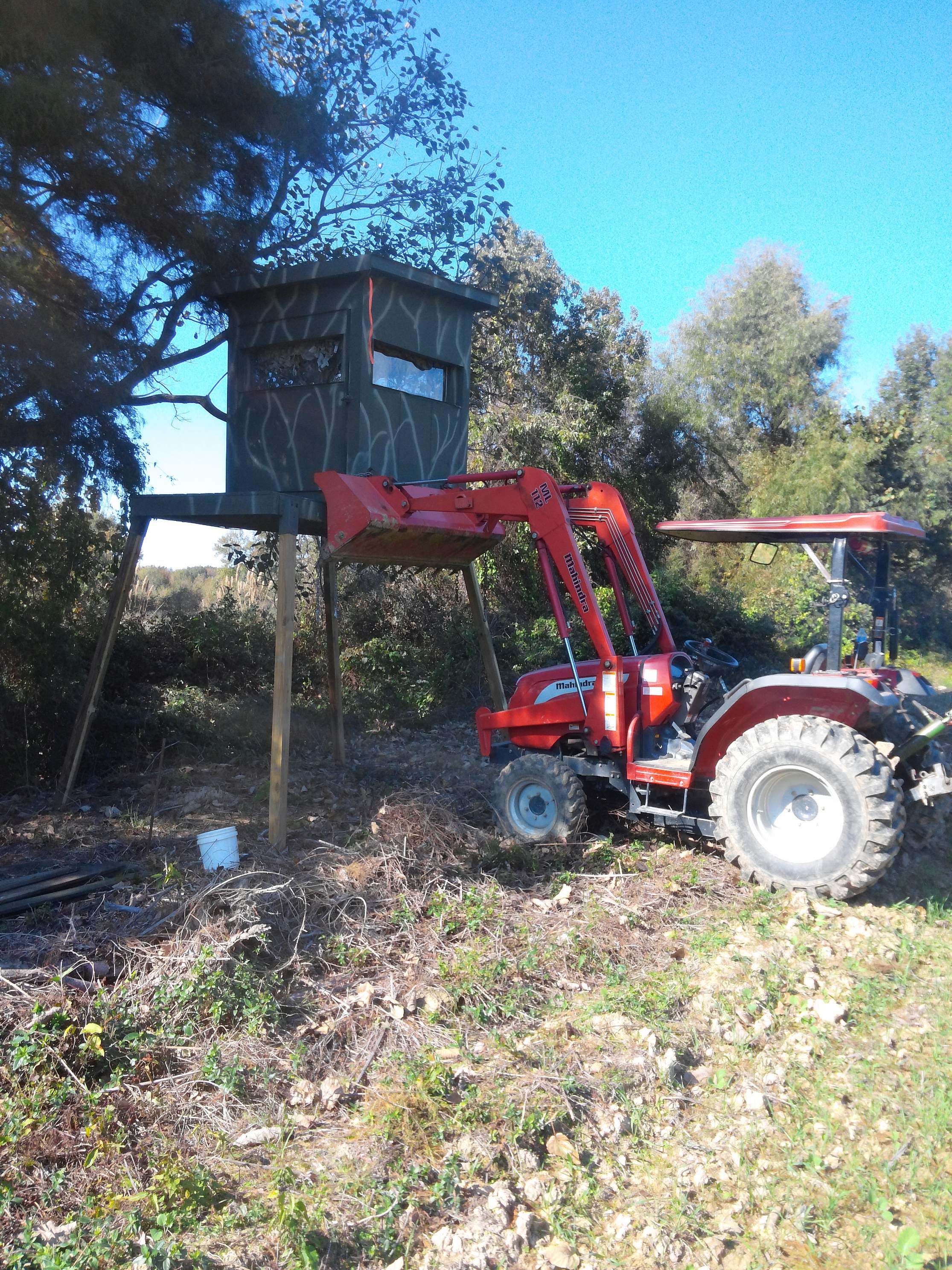

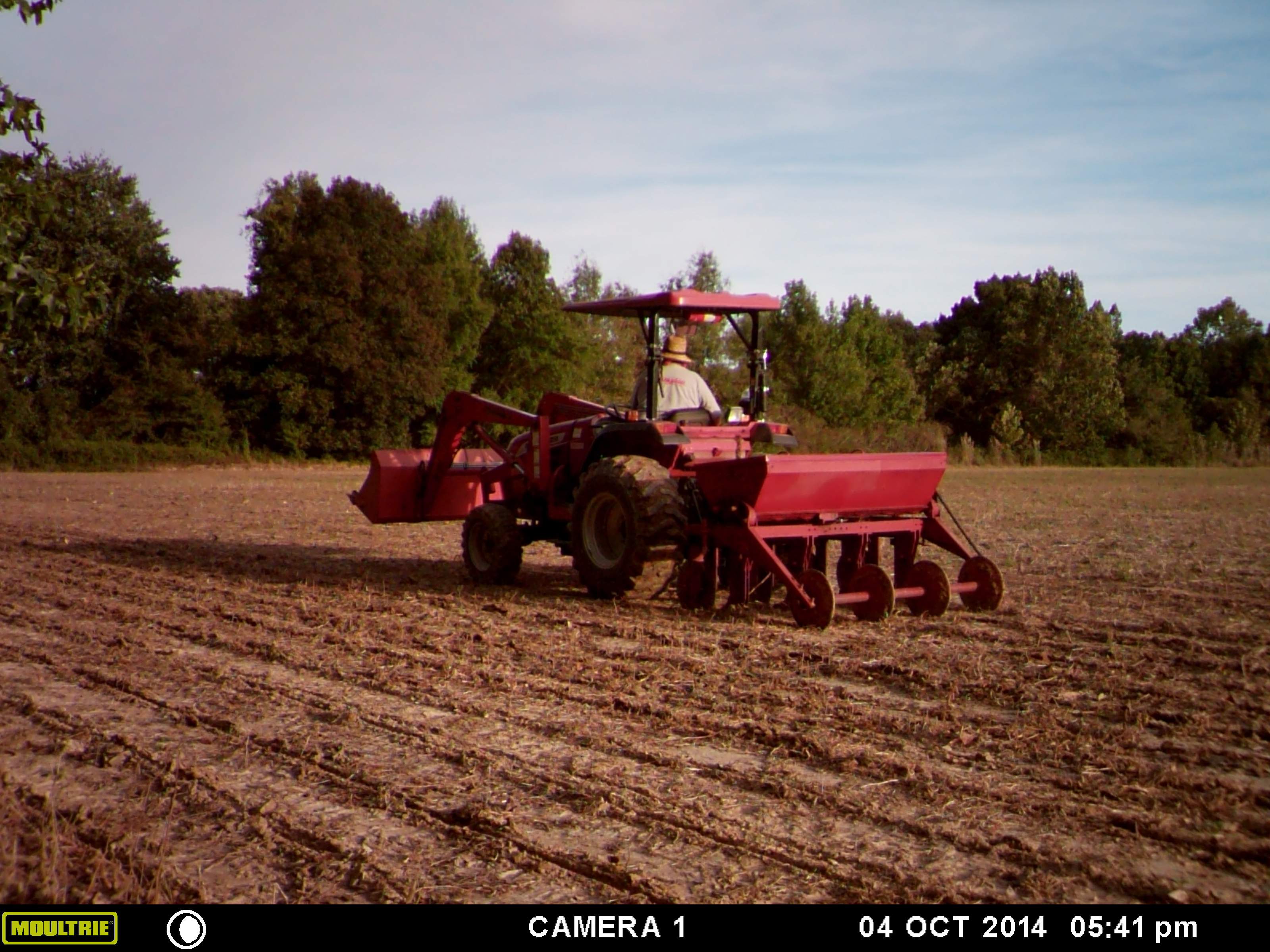

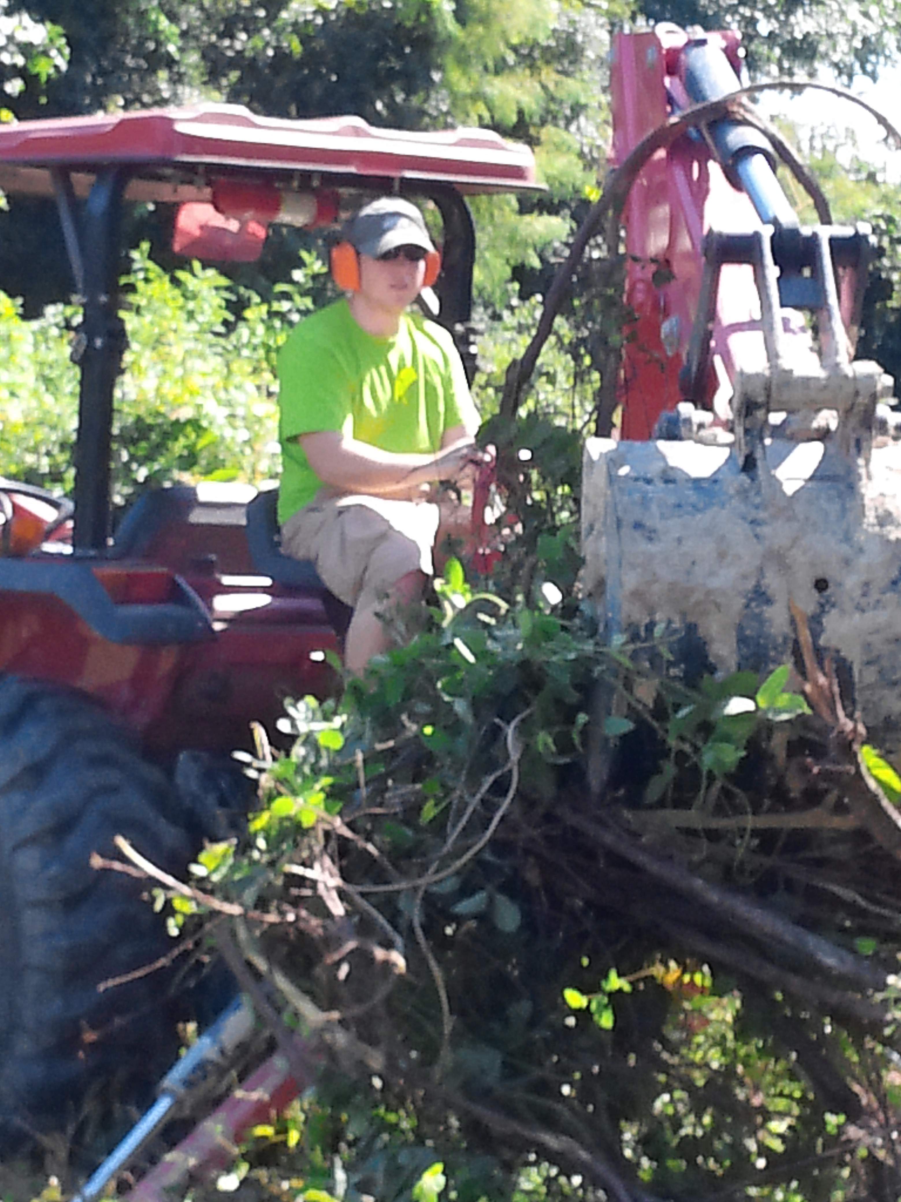

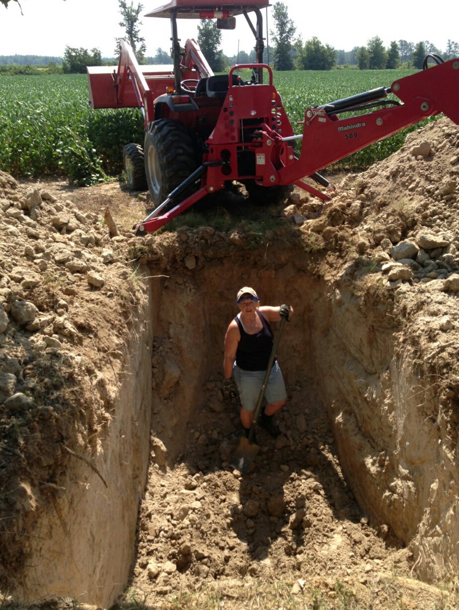

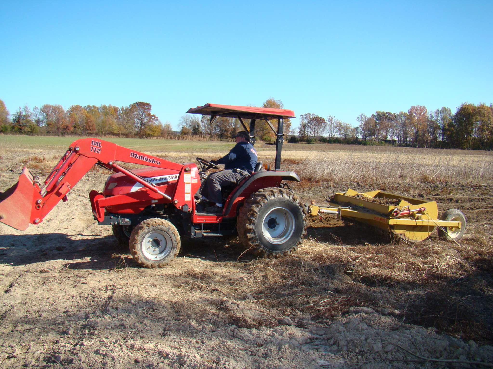

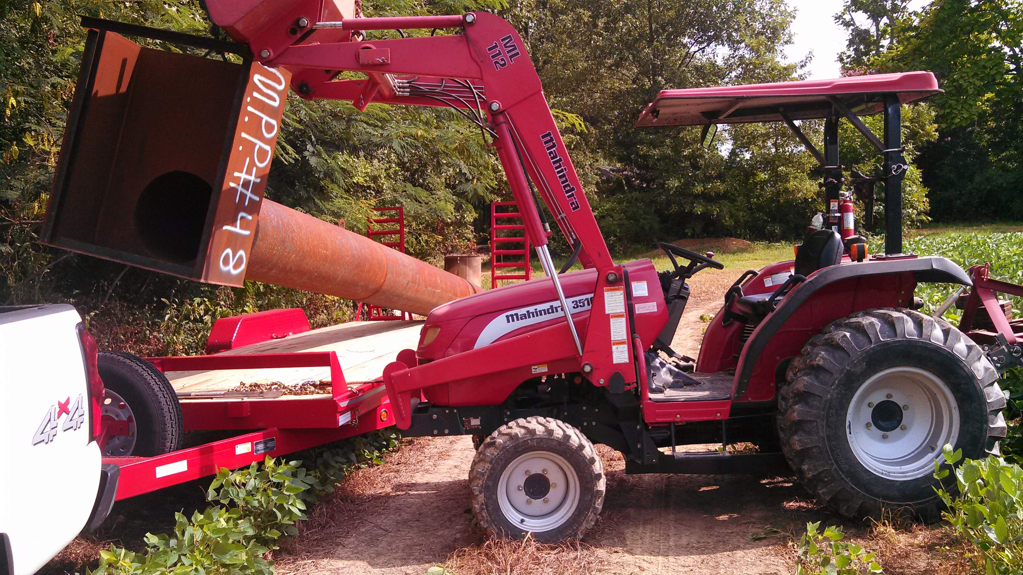

Any good Tractor mounted BH will install leach fields, water lines, etc if you keep digging till its done!
The 509 Mahindra on a 3510 will do everything I need done AND take it off- hook up implements and mow, disk, seed, blade, lift, plant, etc.
For 5 acres, A TLB would work of any make. I personally like Mahindra. Good dealer close and parts available at any dealer.

View attachment 407879View attachment 407880View attachment 407881View attachment 407882View attachment 407883View attachment 407884
Pretty brave person in that 5th picture .
