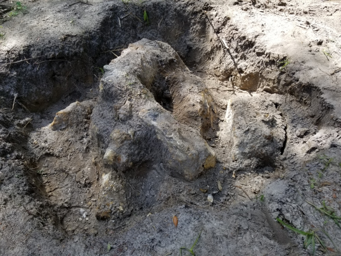

I still have two rocks that don't want to move. Wondering if I should drill deep holes in them, epoxy eye bolts in place, connect a come-along to a nearby tree, and pull.

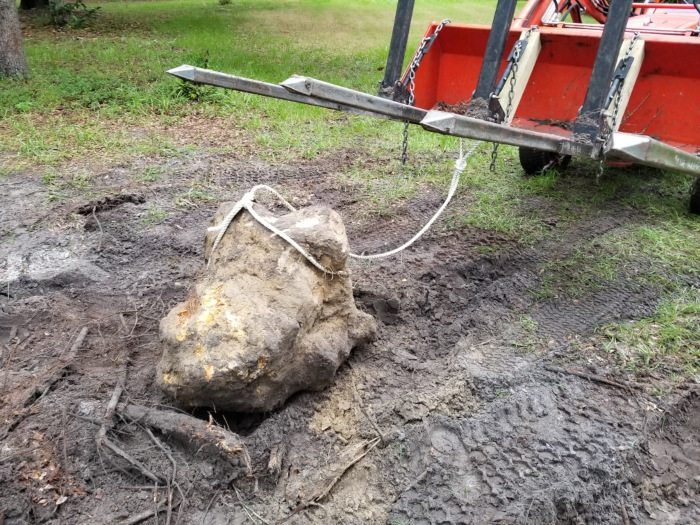

#25
The problem with that is that you're stuck with two big boulders anchoring each other in the ground. They would still have to be lifted out, and the tractor does a bang-up job of that without splitting them. As it stands, I have to dig around the rock, loop a strap around it, and pull. To split it, I would have to dig around it, get down in the dirt with a rotary hammer and drill holes in it, beat wedges and feathers into them, and then pull the still-large pieces out. You can see that's a lot more work, and when it's over with, I have disfigured rocks I can't sell or use for landscaping.
I could see splitting a rock too big for the tractor, but it doesn't seem to make sense for rocks like the one in the photo.

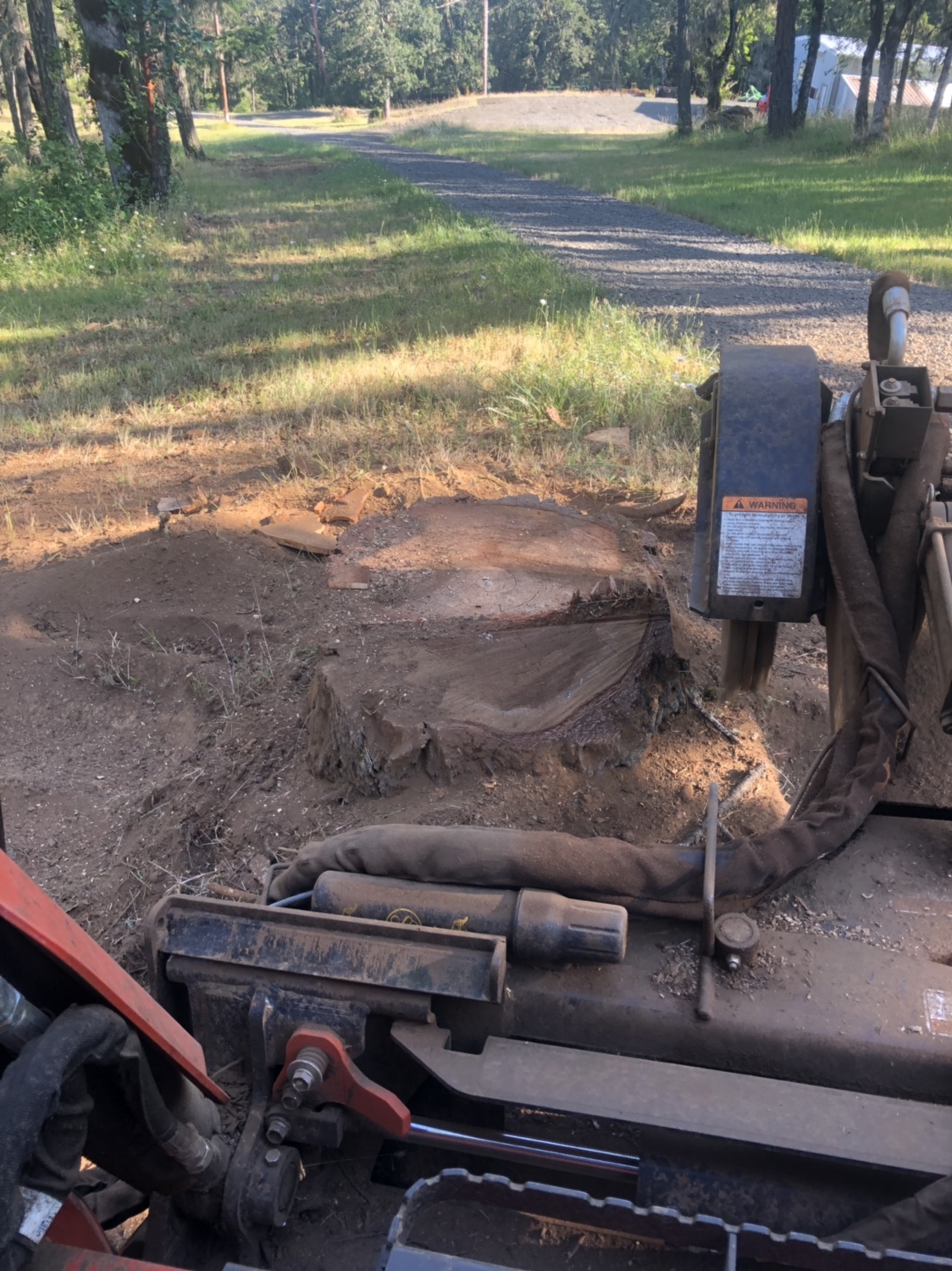

I have a LOT of stumps. I have a dozer, an excavator, and now a stump grinder.
By far, the stump grinder has proven to be the best weapon for making these nasty things disappear. If I were the OP, I’d see about renting a skid steer w/ a stump grinder for a weekend and go to town.
The stump in the picture was from a 100 year old Douglas fir tree. I didn’t measure it, but it was about 3ft across. Including grinding the roots, this was gone in about 35 minutes. I ran my landscape rake over the mess a couple of times and it’s ready to throw grass seed on.
