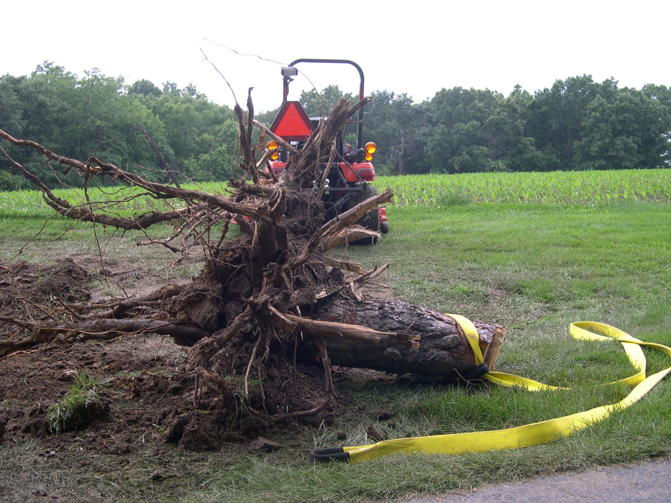

/ Tractor Newbie pulling stumps #42
Like this?
/ Tractor Newbie pulling stumps #43
Restating me original question: Will it damage my tractor hydraulic system by maxing out its lifting capacity using a box blade to pull upward on the stumps?
They have been rotting for the past 5-7 years so the roots still attached are relatively short.
I have pulled a few up already this way, but then began to question whether it is wise.
No. Maxing out lift capacity or hyd relief valve wont do much damage if your not continously doing it for hours on end.
Next time leave the stumps 6'+ tall or just push the whole tree over. A stump is alot harder to get out with out the leverage of the tree still attached.
/ Tractor Newbie pulling stumps #44
No. You will not damage the tractor by using the 3pt lift to its max as long as the tractor is not also moving. Just sitting there attached to the stump and lifting with the 3pt is fine. At max pressure and lift there is a hydraulic relief valve that you may hear chatter and whine as it limits the hydaulic force. That is what it is there for and it keeps anything from being damaged.
So you will NOT hurt the tractor by trying to pull the stumps with the 3pt lift while you are sitting there and not moving...
BUT ! If you try to lift the stump while also pulling with the tractor then you stand a real risk of causing the tractor to rear up. That is very dangerous and happens really fast. Whether it rears or not depends on how much weight out front that you have, and the factory setting on that relief valve, and just how you are hooked up to the stump.
So be ready for that. Using any tractor to pull on something that won't move may lift or lighten the front end of the tractor and cause it to rear. It's a major hazard with any tractor. Go very slow with any pull and watch for that. Do not snatch the chain slack. And always use a chain instead of a strap.
If it starts to rear, quickly stop the lift and just set the front down easily.
And if you just feeln like you have to pull on something by driving forward, run the pulling chain to the drawbar instead of the 3pt. The drawbar is lower down and built for pulling forward.
Luck, rScotty
