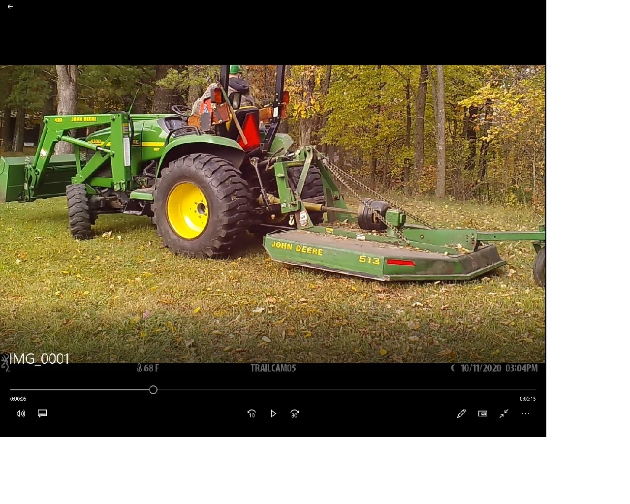

Pics would help. I have the Deere 513 rotary cutter and don't find it is too big for my '98 4300, handles with no problem. Trying to picture yours that the 4300 struggles with. My 513 is almost 30 yrs old, pulled it with my JD 420 2-cyl for several years.

Thanks for the reply. I'm not near it now and I don't have any pictures currently but it looks like a regular brush cutter, not that different that what you have in your picture.
