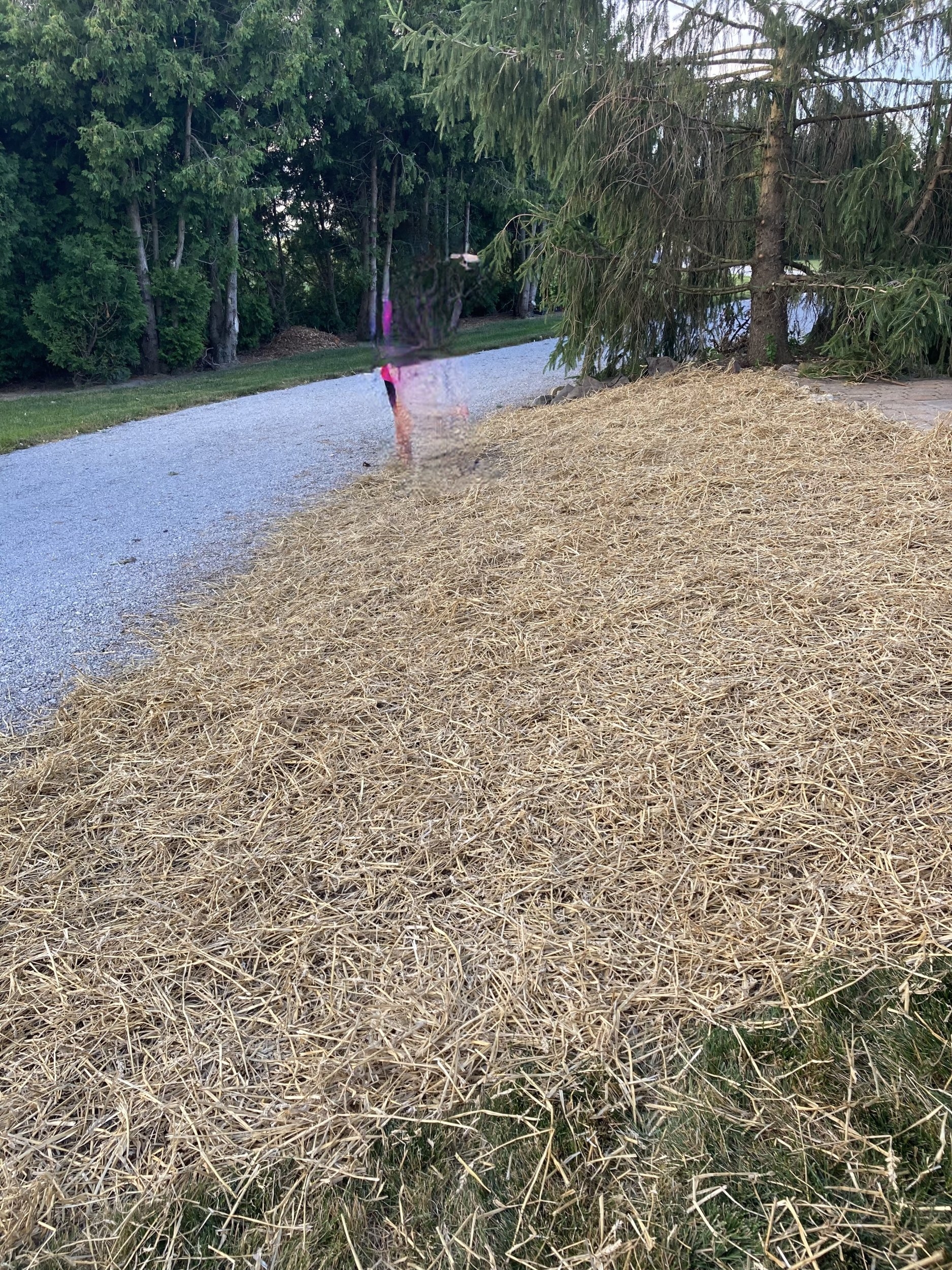

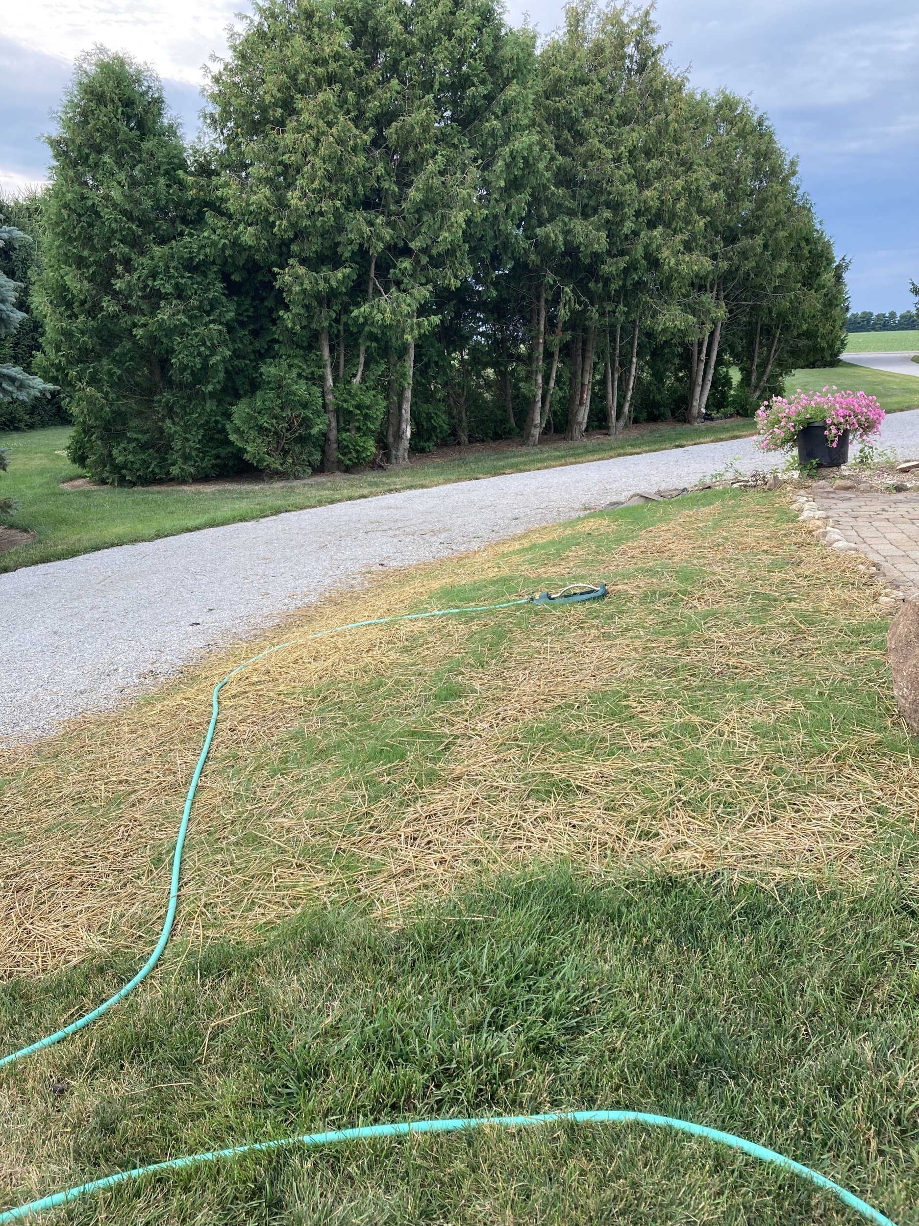

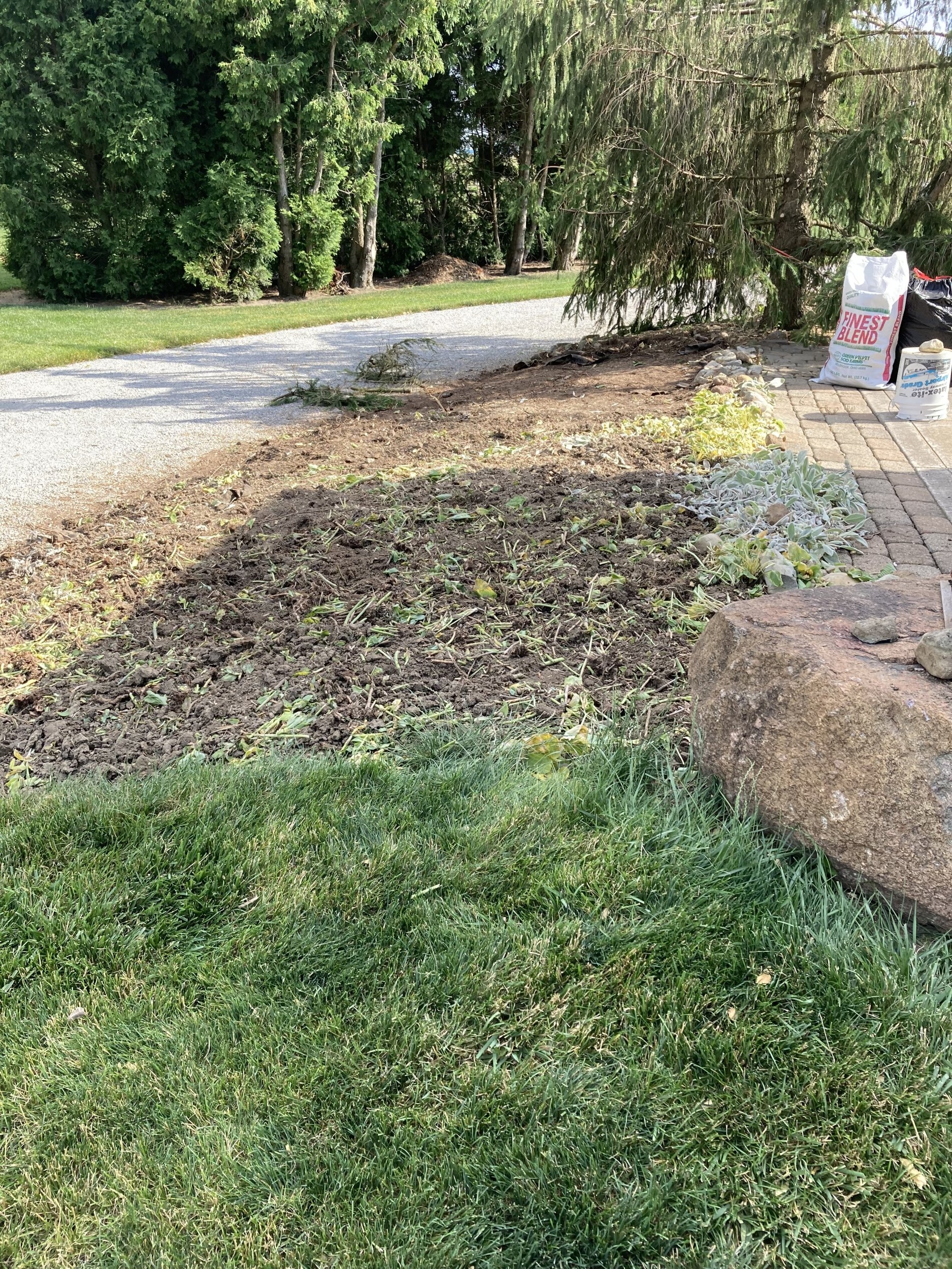

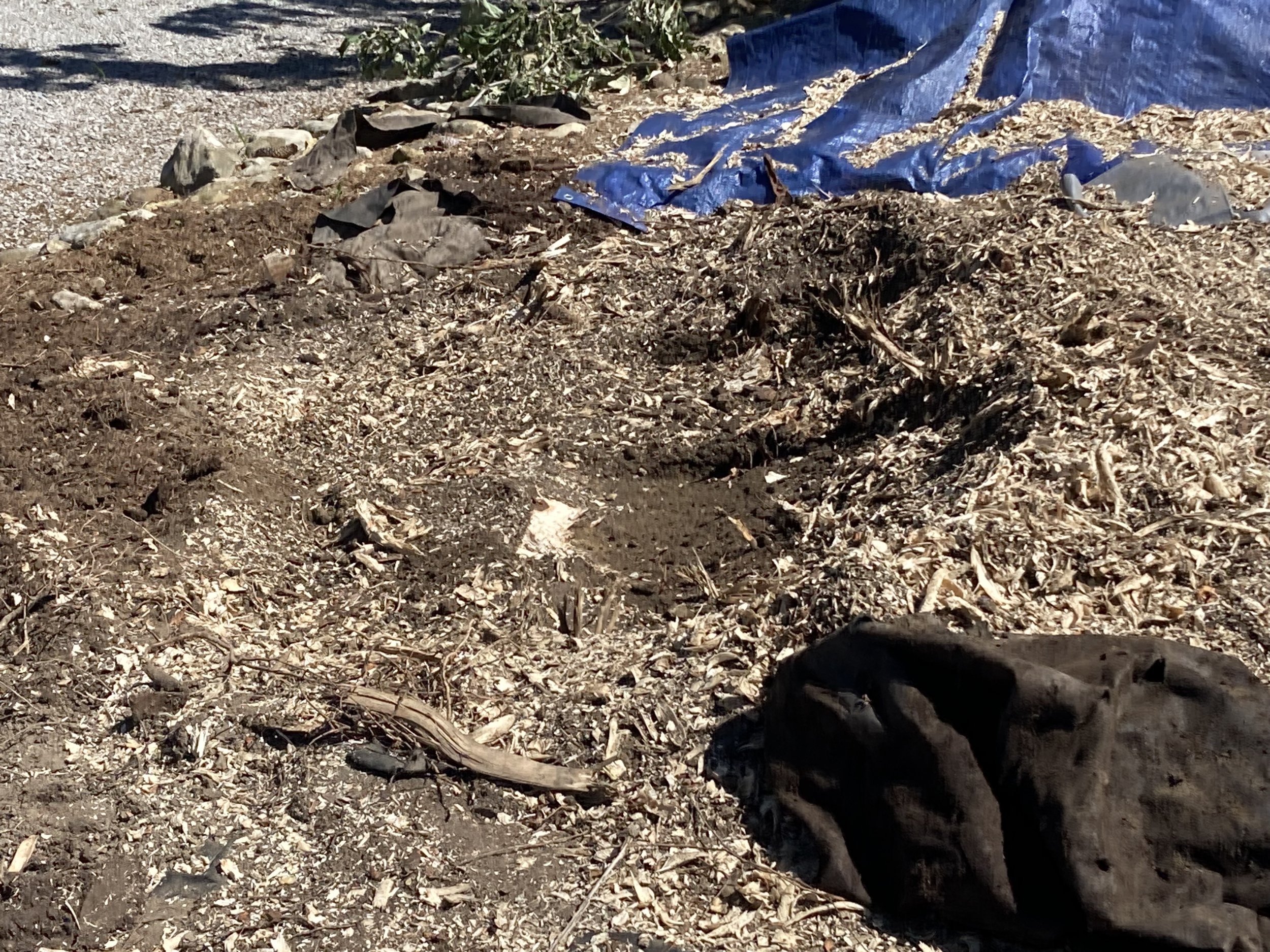

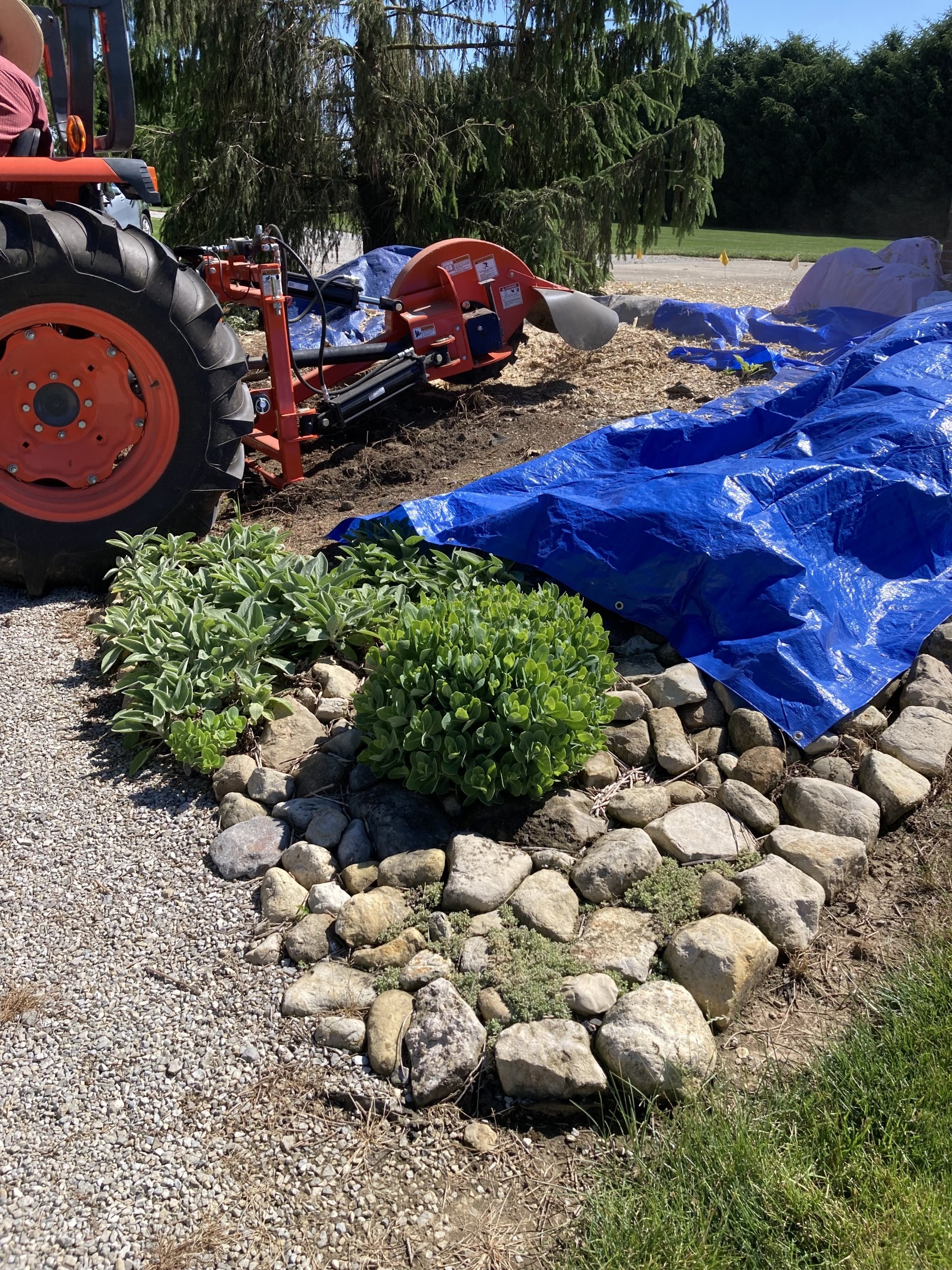

I've done everything possible to get rid of tree stumps for over 40 years. I've burned, cut flush, backhoe, bulldozed and nothing was fully correct.
Finally, I bought a 3 pt hitch stump grinder and in my first few hours I satisfactorily ground 10 meaningful stumps below grade. And on top of that, I believe I could sell the grinder for more than I paid.
Recently, I ground a 16" softwood stump that was close to the house. Below grade maybe 5" is all that I wanted.
Then, I spaded the ground, added a little fill, seeded and strawed. I set the sprinkler on top, watered multiple times a day and six days later the grass is popping through. From annoying large stump in a bad place close to the house to a week later almost green grass and no one is the wiser. I've ground stumps in the woods as well.
Of all the ways to deal with stumps, buy a stump grinder--I have a LandPride--grind everything and save 99% percent of your time for the wife and kids.

EDIT--Here's pic of my stump grinder
EDIT--Below is the green grass growing where my sump used to be and it's only been a couple of weeks from inception to grass. I raked out most of the chips after grinding and added dirt to fill the hole. I've been stump grinding for decades and there is no better way to get rid of stumps.
