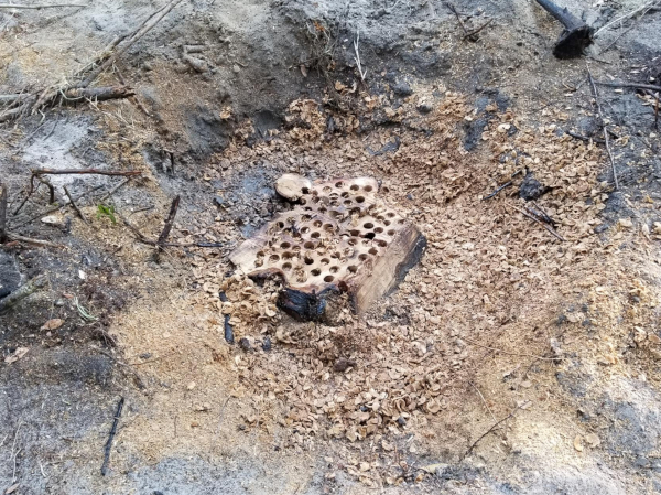

Twisting the stump with a pry bar and garden tractor didn't work, but I had to cut a slot in the stump to try it, and that gave me a place to pry. I put a chainsaw in the hole and cut horizontally through the stump. Some bits needed prying. Others fell out. I ended up with a wood platform maybe 9" below ground.
Realizing my drill removed wood much faster than a chainsaw, I drilled a bunch of deep 1" holes through the remains of the stump. Didn't take long at all. I may bop it with a maul and see if any of it will break off. There isn't much holding it together now.
I think the tap root is only under a small part of the ball, because the drill hit dirt quickly in every part except for one little area.

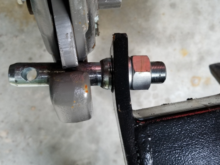

If anyone cares, I got three stumps out of the ground this weekend. I waited for a rainy period to loosen up the dirt, and I tried again. It makes a big difference.
I ran the subsoiler around the stumps to yank or at least locate roots branching off from them. When the subsoiler couldn't cut them, I drilled holes in them and then cut them with a Sawzall. Eventually, the stumps loosened enough for the subsoiler to get them.
I bent the tabs that hold the hitch pins on the subsoiler. That surprised me. I didn't think this little tractor could do that. I would guess the tabs are 7/16" plate. I doubt I can bend them back.
I don't care if I ruin the subsoiler. It's way cheaper than paying someone to remove stumps. I could buy three of these things every year and still come out way ahead.

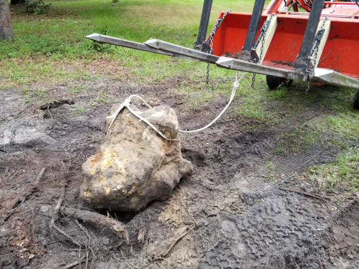

I also ran into a hidden boulder while I was working. I don't know what it weighs, but my FEL's limit is 1500 pounds, and there are probably 300 pounds of forks on it, and the FEL was not totally happy lifting the boulder. I put a rope around it and tied it to one fork. It wasn't until the boulder was just about to leave the ground that I realized it was going to swing! Luckily the Kubota has a very sturdy bumper.

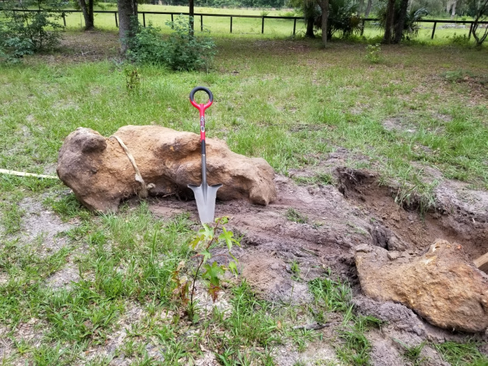

I've been having more fun with the tractor today. I had two large rocks next to each other, and I started digging around them trying to find out where the separation was. I hadn't been able to move them with the subsoiler, so I figured I'd find a way to move one of them, and then the other would go easier.
I found a projection I could tie a strap to, and I pulled with the tractor. A piece of ground the size of a yoga mat started to rise out of the yard. Turns out there was only one rock. I got it halfway out, propped it with a 4x4, fastened the strap in a better position, and dragged it out. I had no idea the little Kubota could pull like this. Lifting the rock with the subsoiler didn't work, but the strap uprooted and dragged the rock without hesitation.
Now I'm stuck with a huge rock.
