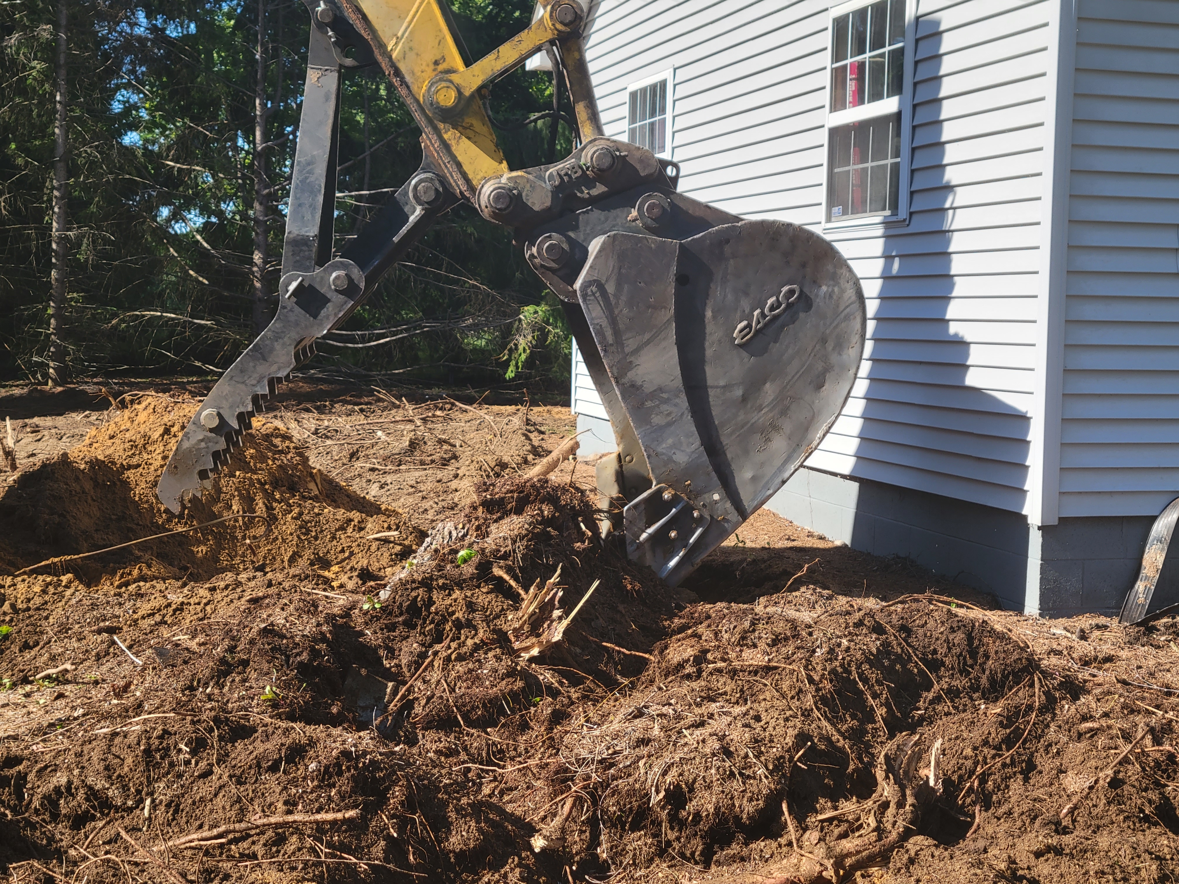

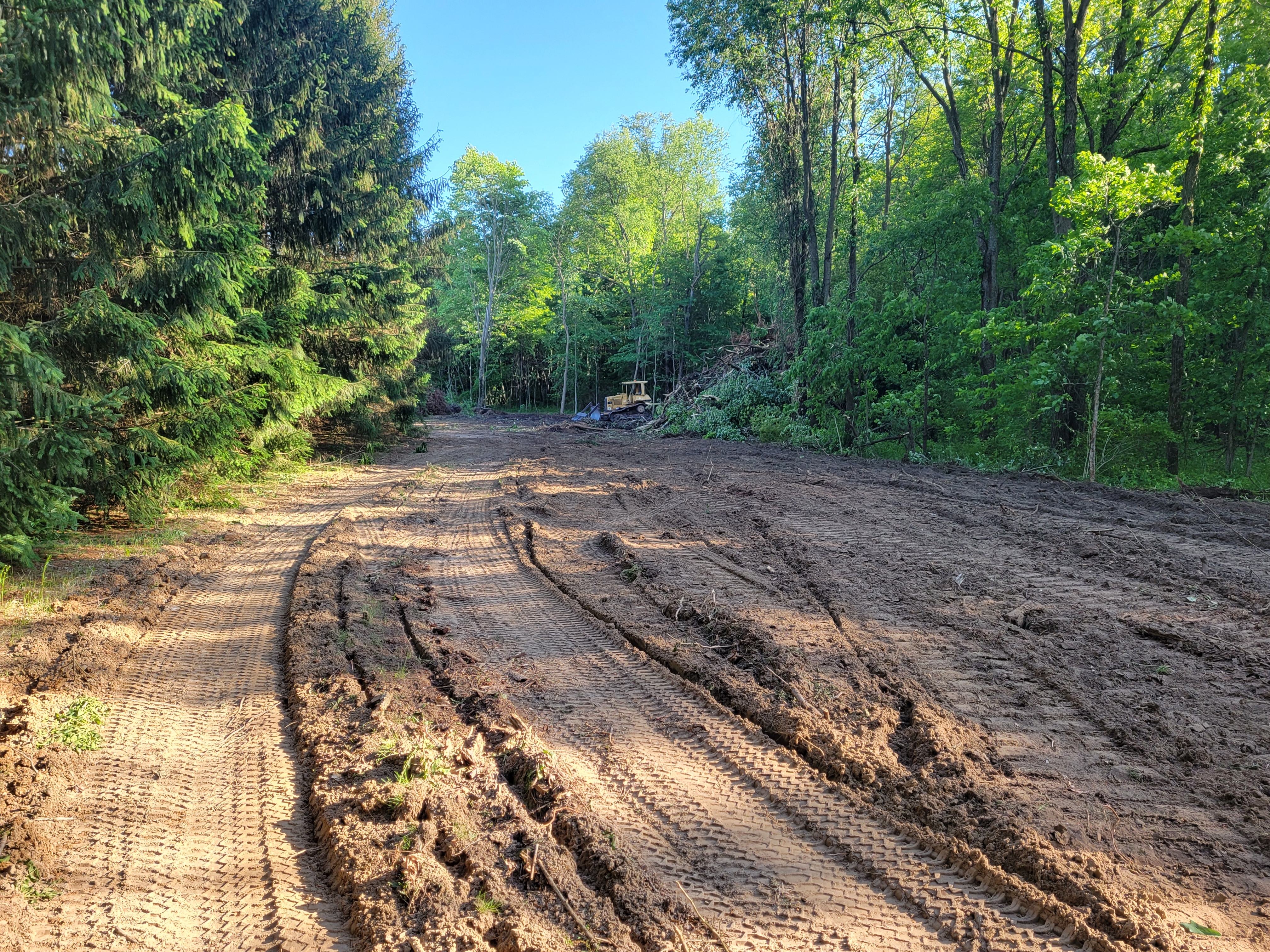

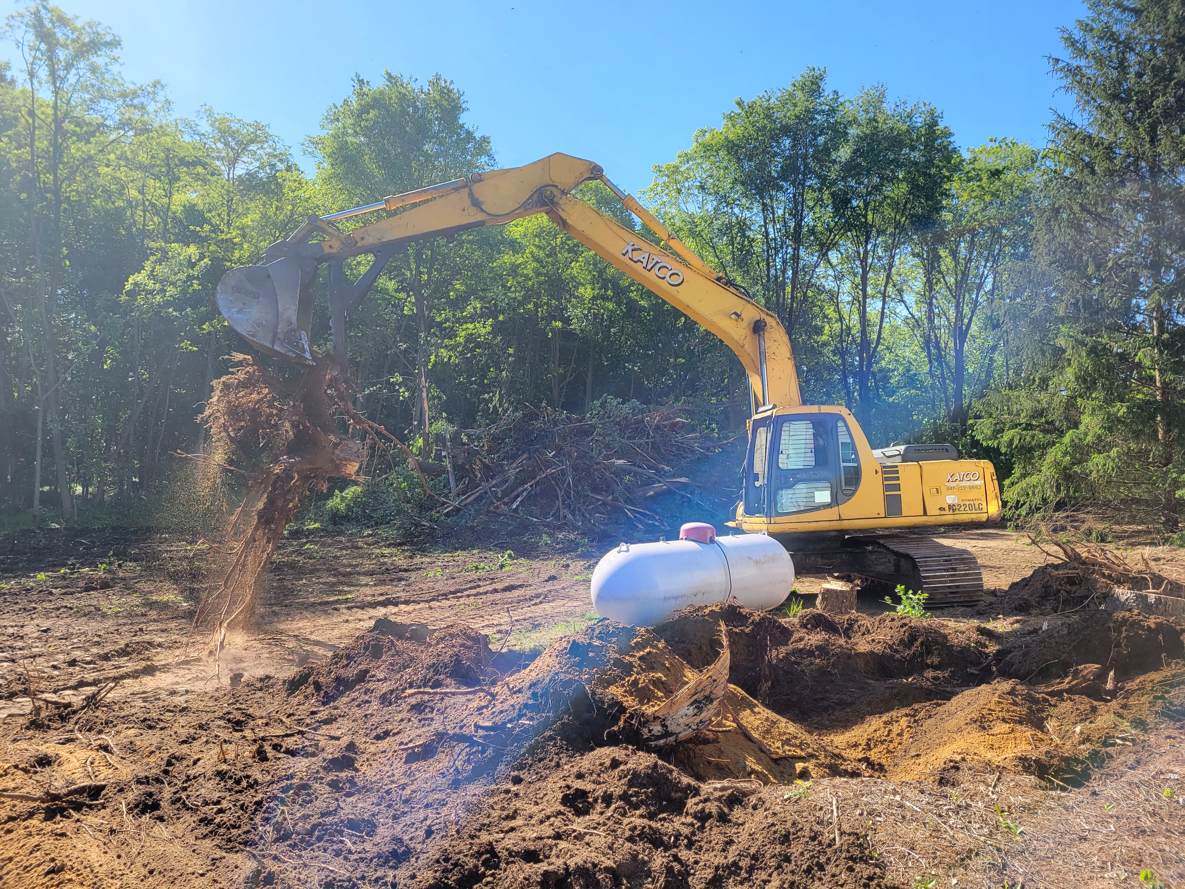

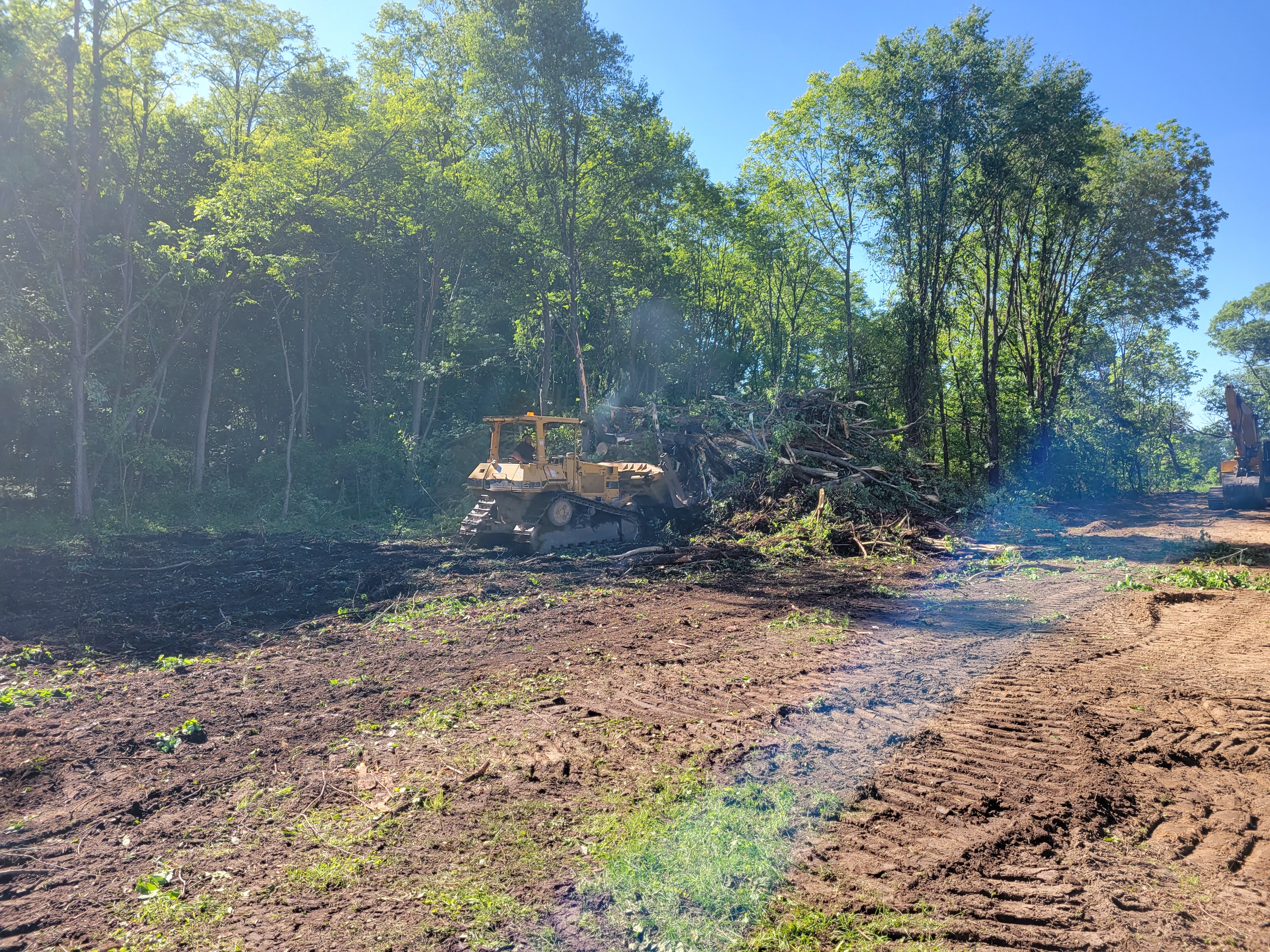

/ Mini X vs. Skid Steer vs. Tractor backhoe #3
I went a bigger route and hired a guy. Was cheaper and faster than me renting and/or buying..
Good call! I did this on one section where I needed to get a circular driveway put in quickly. I have always said, ‘there is no substitution for the right tool or chemical’ and also need to keep services to just get things done quickly in mind. I watched a guy who spoke very little English work a big excavator, bull dozer and skid steer remove a dozen larger tree trunks and put in 6” lifts to raise a low section in that driveway 5 feet. It was impressive and he had it done in a day and a half. Even with the right equipment, it would have easily taken me two weeks and a lot of frustration.
I was figuring renting would have cost me close to $5k for 2 weekends after delivery from the closest place 30miles away, and fuel for a 20k lbs excavator and dozer. I paid this guy $3k plus tip and took less than 2 days. And he sawed the trees to more manageable sizes (removing stumps and tops) helped move some bigger stuff around the property for me, and some other stuff that was easier to do with a large machine. Couldn't pass it up.
You got an amazing price for all that! I’m just glad in hindsight that I decided to check my ego and pick up the phone for that part of my property.
