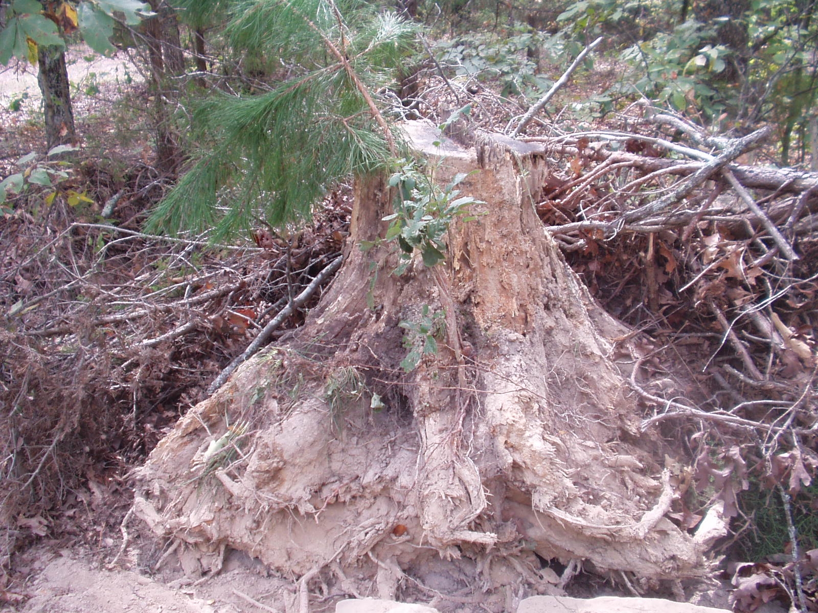

Just had a few old stumps removed on Monday by a friend that has a near new E60 Bobcat Ex. (~13,000lbs) here in my area of the Ozarks. The largest was about a 16 inch, with a 12 inch right next to it, old lightning killed white oak. He really fought to get it out of the dry rocky soil. Was not sure that it would come but after a 1/2 hour he managed to get first the 12 inch and than the 16 incher out.
It took over an hour and a half to pull 9 stumps ranging from a 6 inch Hickory to the big 16 inch. If the OP's land is similar to my area of the Ozarks stumping is no easy task. Since I stood by with my skid steer to remove the stumps once he dug them up it would take longer if more than just digging them up and moving on to the next one did.
