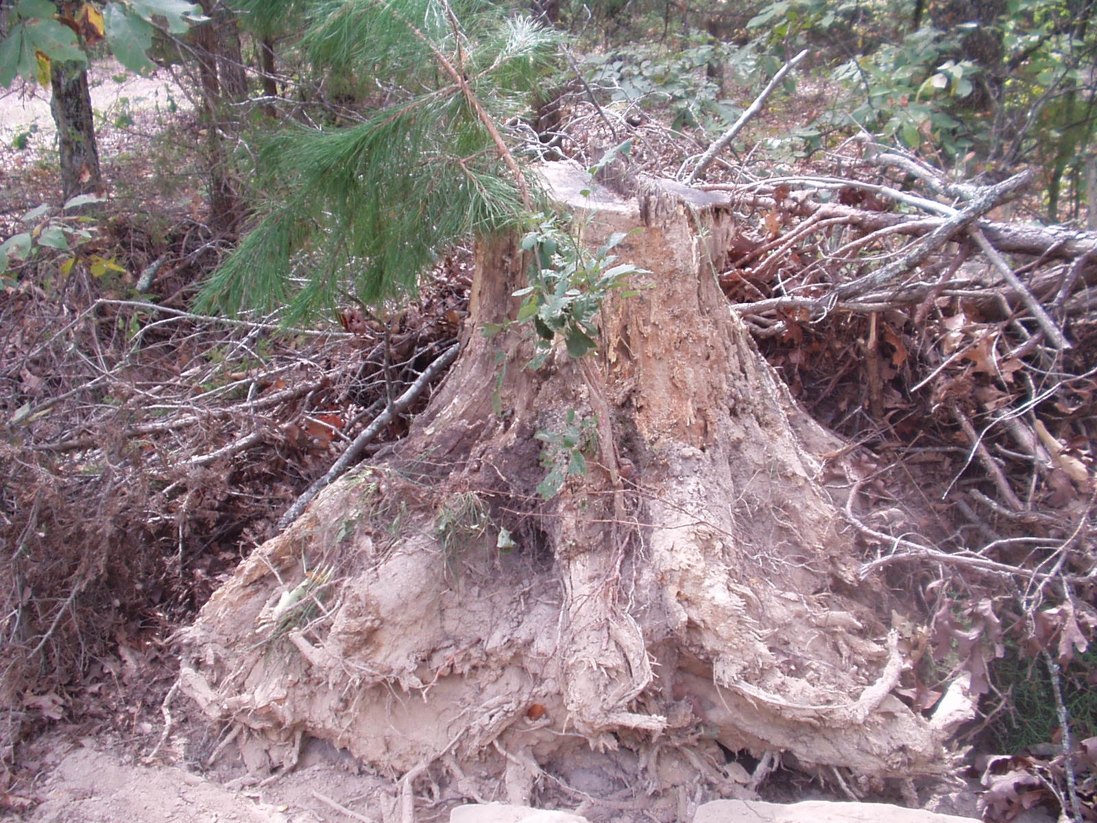

Just had a few old stumps removed on Monday by a friend that has a near new E60 Bobcat Ex. (~13,000lbs) here in my area of the Ozarks. The largest was about a 16 inch, with a 12 inch right next to it, old lightning killed white oak. He really fought to get it out of the dry rocky soil. Was not sure that it would come but after a 1/2 hour he managed to get first the 12 inch and than the 16 incher out.
It took over an hour and a half to pull 9 stumps ranging from a 6 inch Hickory to the big 16 inch. If the OP's land is similar to my area of the Ozarks stumping is no easy task. Since I stood by with my skid steer to remove the stumps once he dug them up it would take longer if more than just digging them up and moving on to the next one did.

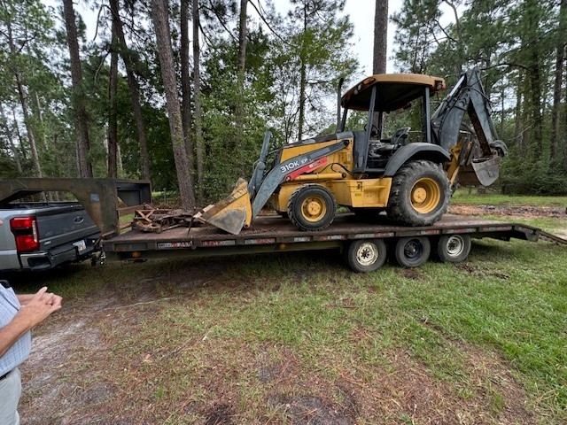

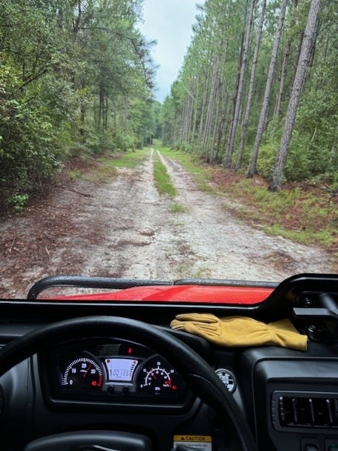

I somewhat went through a similar scenario on our 60+ acres. I built some internal roads where trees had been planted fence to fence. The ground is a mix of sand in some places to clay in others. The trees are all southern yellow pine. I put in close to 2 miles of roads using a John Deere 310K and a lot of time and patients. Took me about 6 months of weekend work to get it done using the approach of pushing trees over and digging up the stumps. The yellow pines develop a long central tap root but these were still small enough to deal with. On the bigger, older trees, you might have to dig a 10+ foot deep ring around the tap root to get them up out of solid clay. Then its a long ordeal to ever get that hole to refill and stay solid. LOL

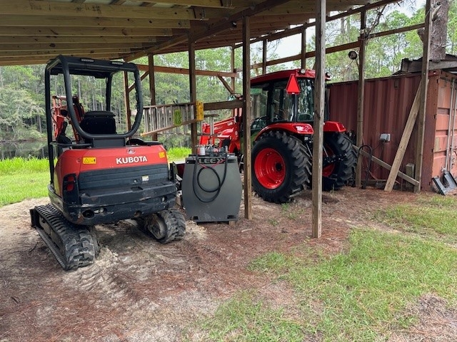

Anyway, I just literally got rid of the backhoe and picked up a Kubota KX71-3S excavator. Small 3 ton unit but perfect for lighter weight chores around ponds, drainage ditches and the like. Plus, I can get to places with its 6,300 lbs that the 14,500 lb backhoe couldn't.
I put about 400 hours on that backhoe over the course of 3 to 4 years. Had I rented it, there is no telling what those hours would have cost. I now combine the smaller excavator with a larger tractor for the loader and the two currently meet my needs. If truth be told, I may eventually look to go slightly larger on the excavator to something around 4 to 5 tons for stability and ability to use a flail mower on it. I also want a cab, but the 3 ton one is currently working fine. As someone mentioned above, you can always buy something for the job and then sell it to change to something different if needed. Good luck.
Backhoe leaving
The little 25hp excavator with the 70hp tractor/loader
Roads cleared and grubbed with that backhoe

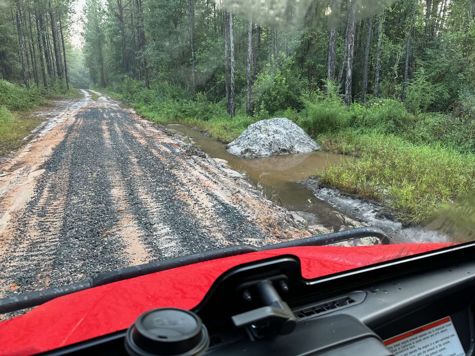

Drainage work alongside road where the backhoe was too heavy to access. It's own weight would make it sink but the little excavator glides right over the top without issue.
