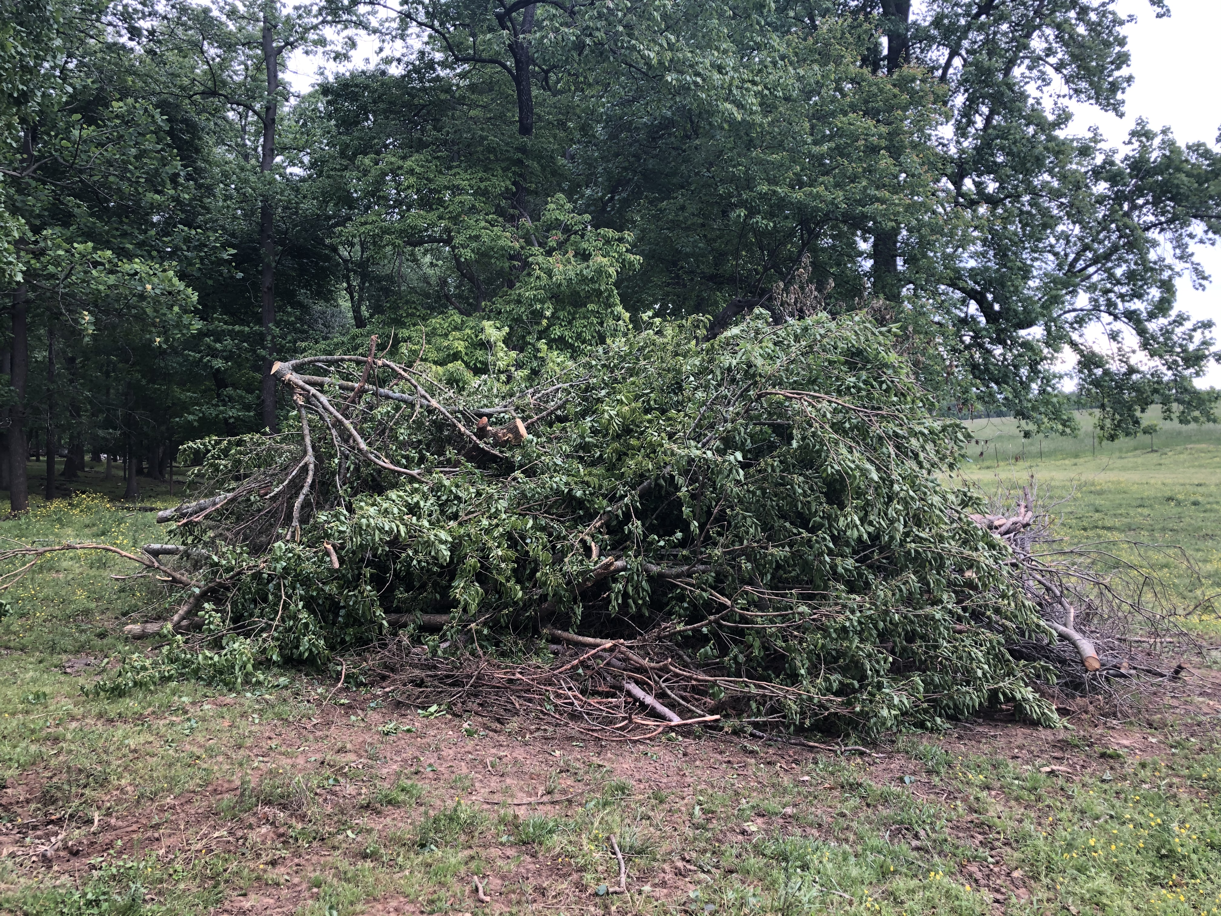

Thanks for the tips. Sorry but no pics. I should have taken some before and after but didn't think about it at the time. I'll post a pic of the mountain of brush.
I can see that I'll be using this attachment quite a lot. It sure makes the work easier and faster.
