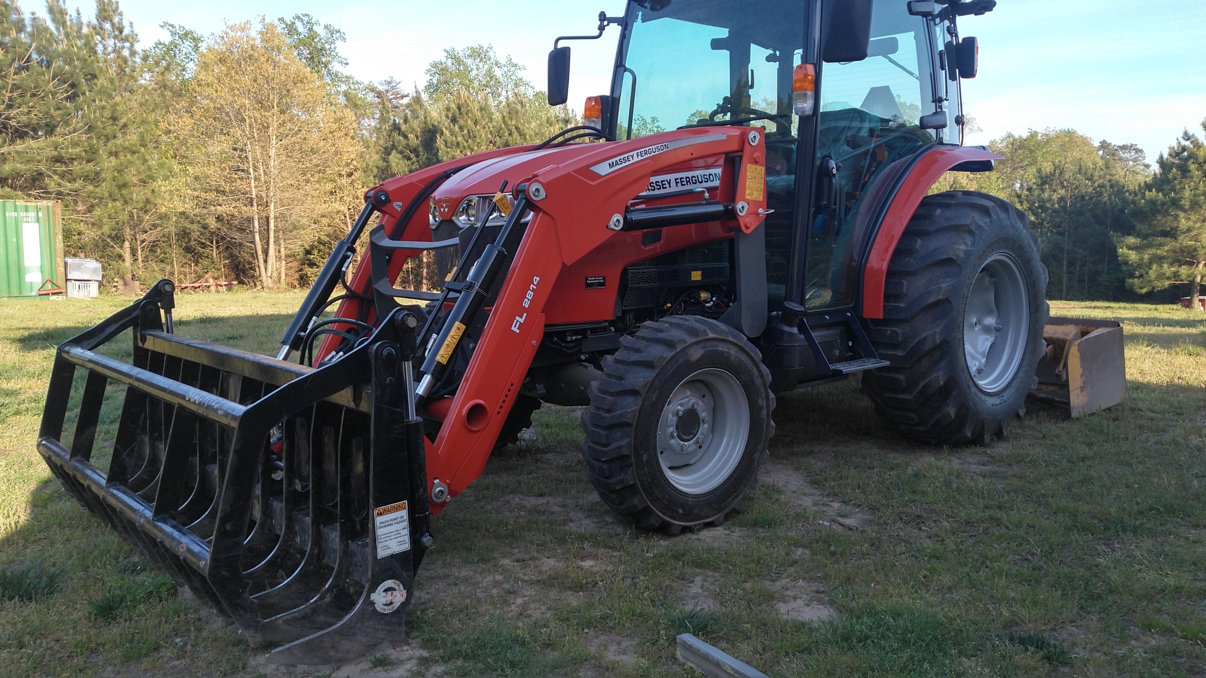

Keep it light so you preserve lift capacity and have a heavy ballast for the back.
Something like this:
The 55" is light and more than enough. It's made of hardox so it should be durable as heck.
I have an EA Wicked 55 (pre-implosion) and the current Homestead looks crazy close in build and weight.

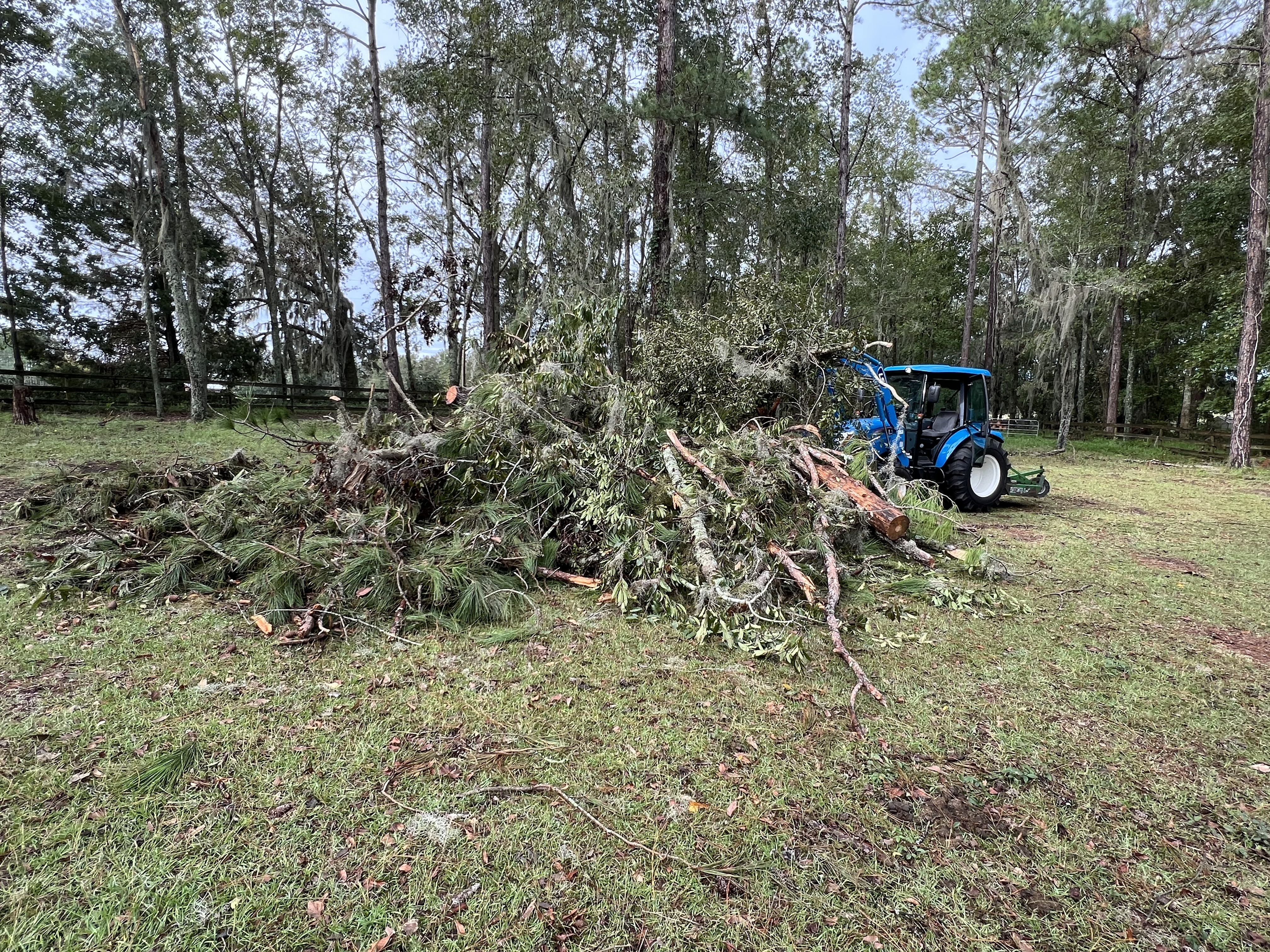

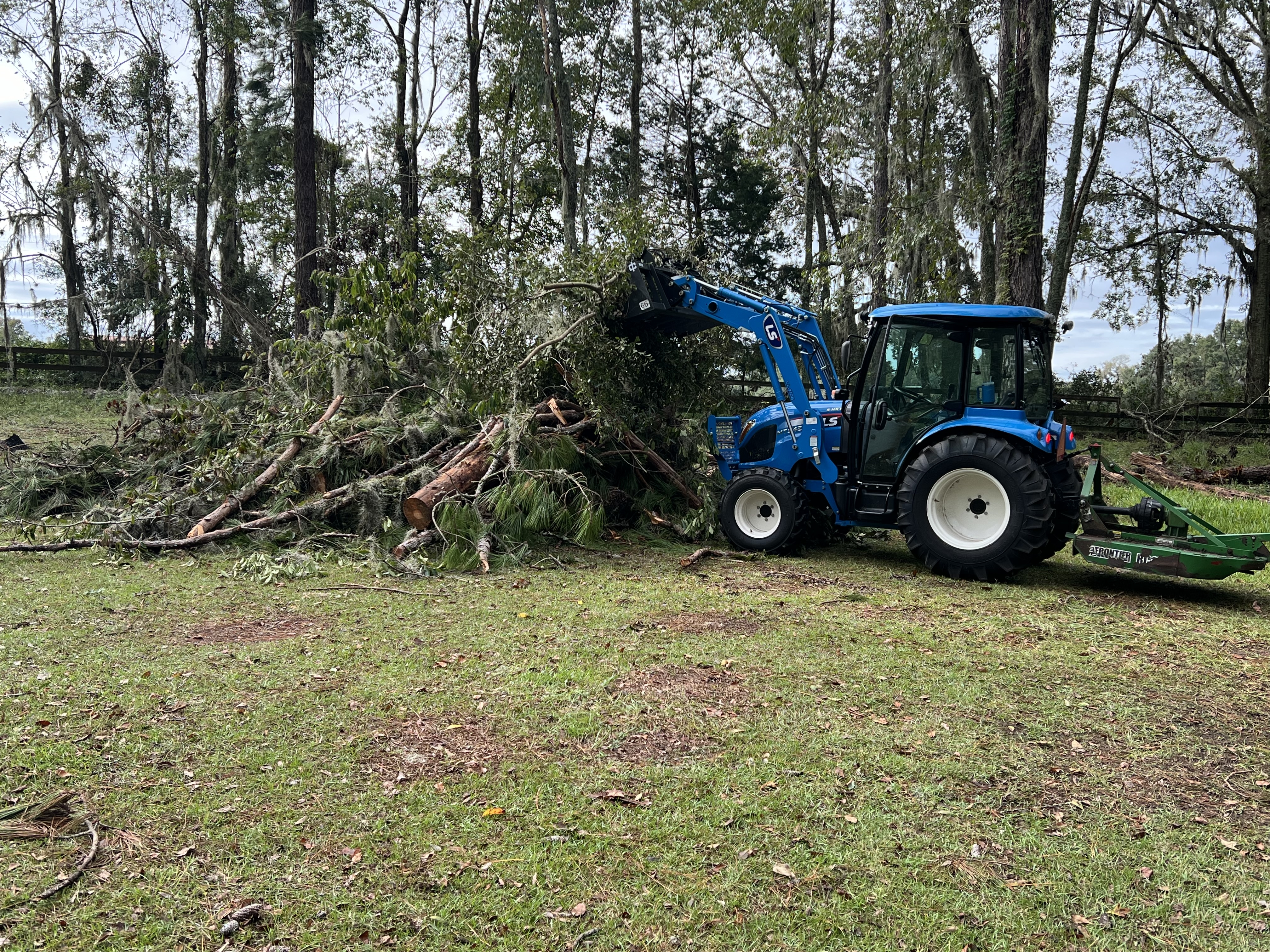

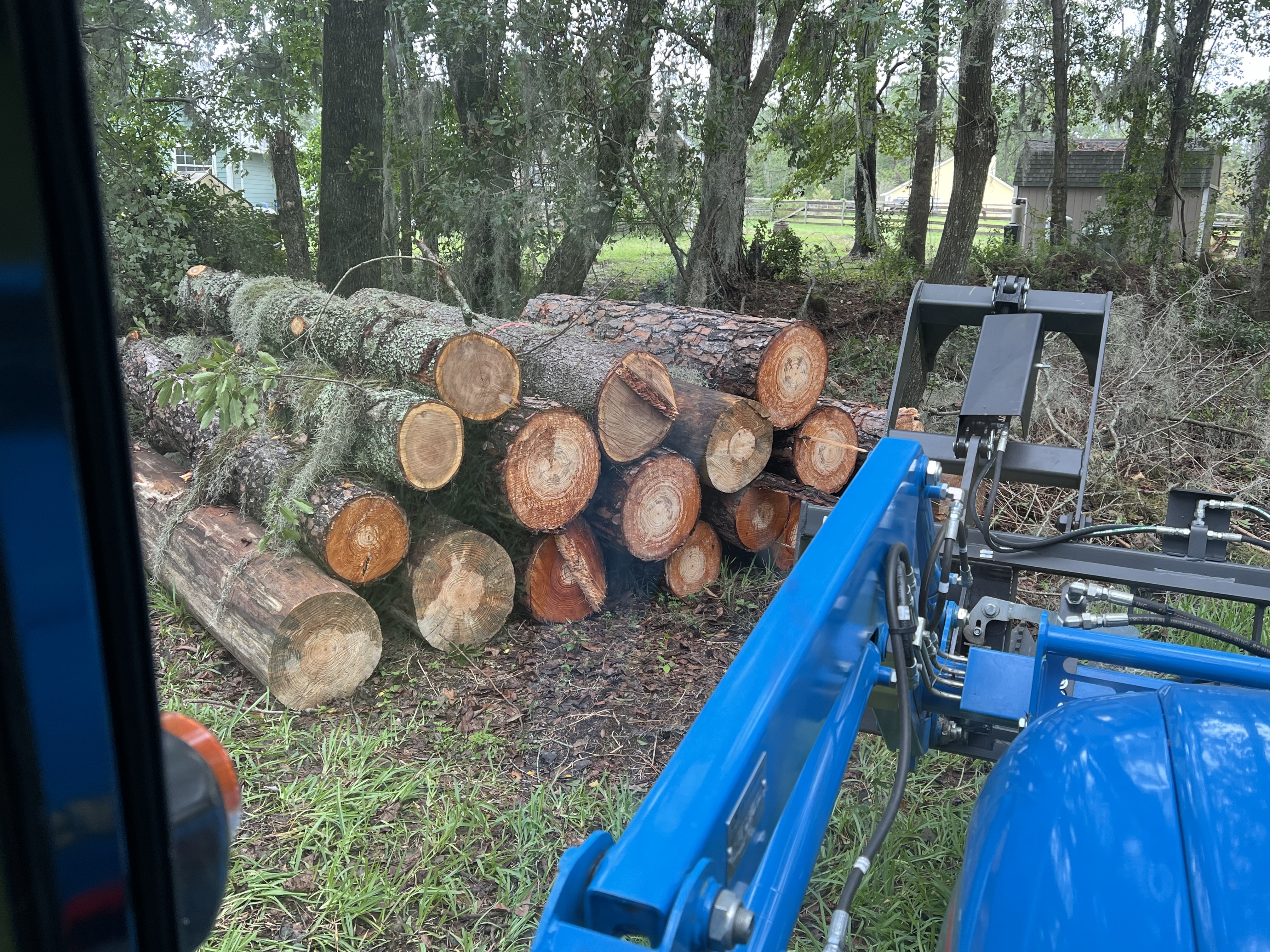

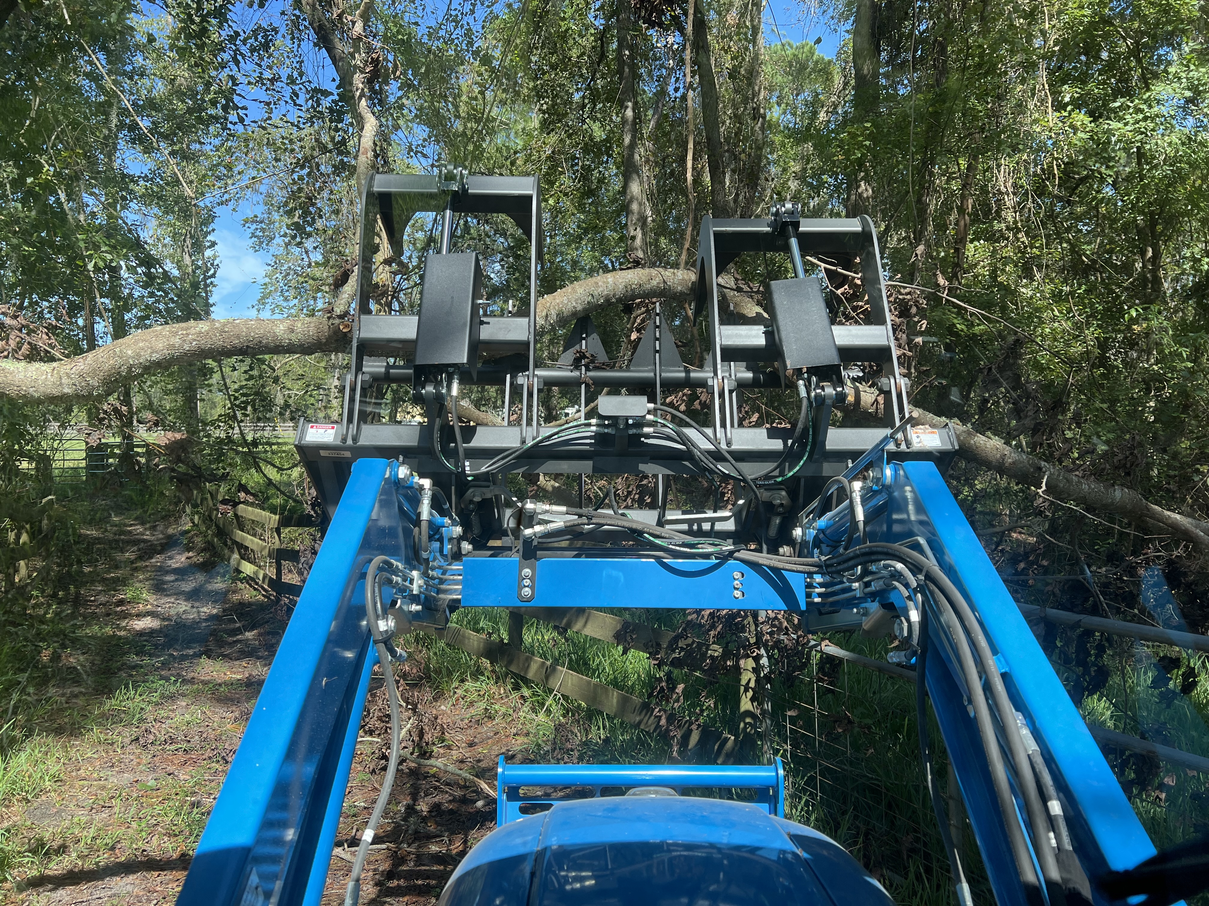

Mine came in quite handy the last week with storm cleanup from Hurricane Milton and Helene (even a little from Debby).
That is 9 trees plus multiple branches from other trees. 5 were 20 to 24 inches, the rest 14-16, maybe a little smaller for the smallest.
About 12 hours spent chainsawing and hauling. Some of the trees were either leaning or had fallen. One was hung up against another tree. But the majority we took down before they became a problem. Grapple is a 66” dual cylinder Iron Craft grapple. Paid less than $1500 after tax.

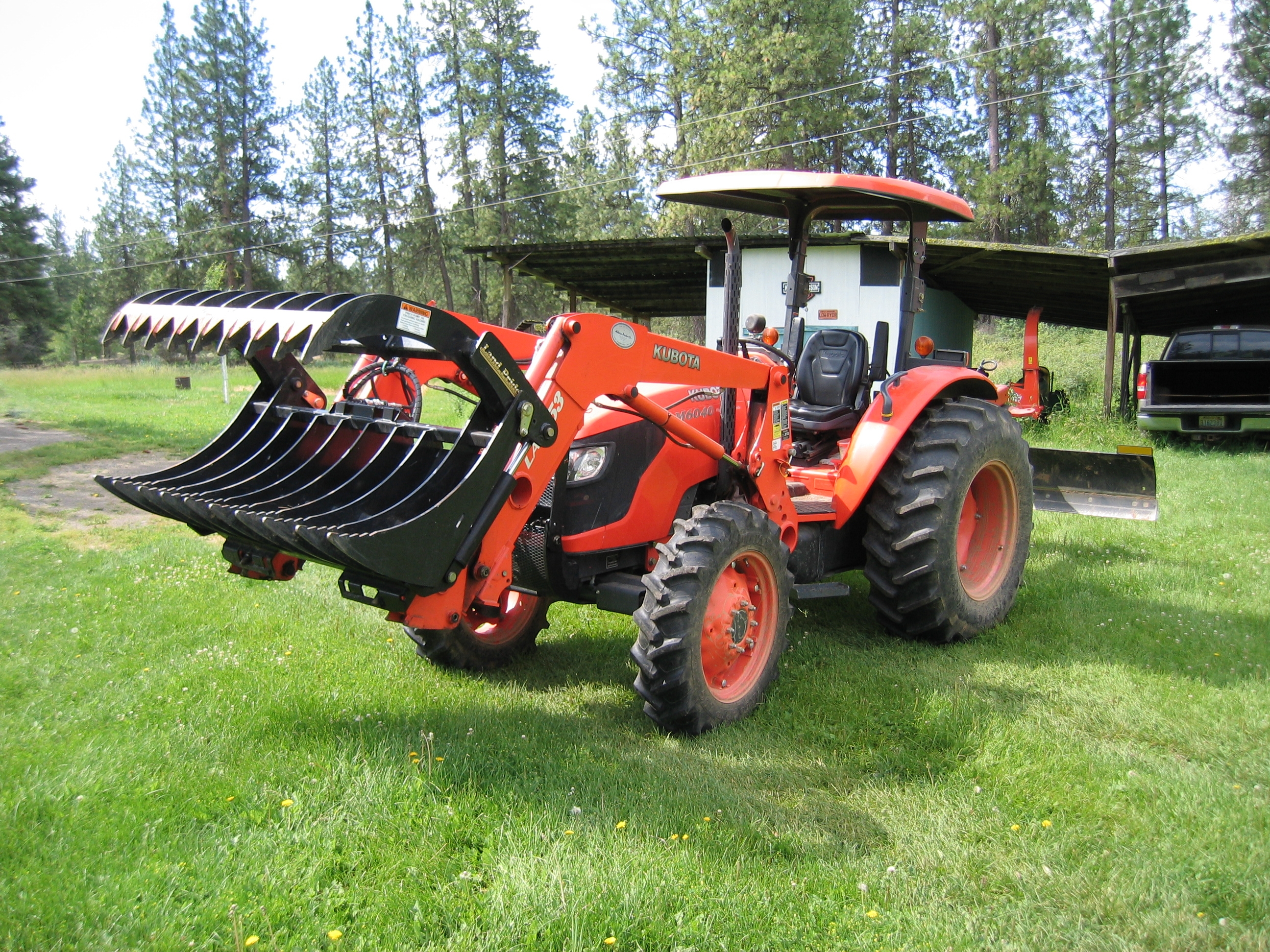

I have a 60 inch grapple on my Kubota M6040. Almost, exactly as wide as the front wheels. As Advil says - you do not need a wide grapple to get the job done.
Another factoid - the lower you keep the load, when you lift, the more your FEL/grapple can lift. I lift very heavy rocks/boulders and large diameter chunks of pine tree trunk. Most often the load is lifted just enough so I don't leave drag marks in the dirt. I have 1550 pounds of RimGuard in the rear tires and a HD 1050 pound Rhino rear blade on the 3-point.
My grapple is quite heavy - 820 pounds of AR400 steel. I've learned that heavy duty implements is the way to go out here on my 80 acres. They do the job and don't crumple up when asked to go to the max. This is my Land Pride - SGC1560 grapple. It is powered thru a WR Long 3rd function system.
