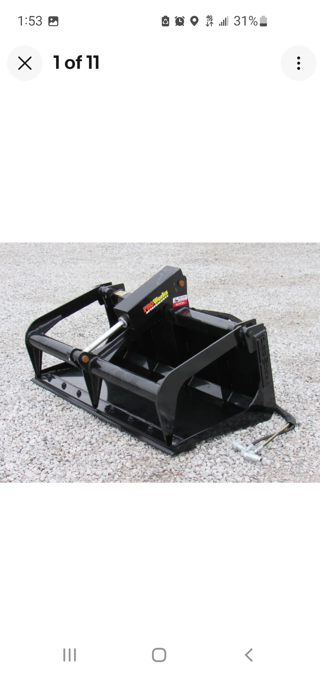

I'm considering the purchase of a grapple bucket and looking for input on a solid bottom grapple.
Uses: primarily will be used for moving brush, logs, and split firewood.
A solid bottom seems like an advantage for me in that I can still haul my chainsaw, gas, oil, chains etc easily.
My tractor has a lift capacity of 1400lbs so lightweight and 48-52" max width. Anyone have experience with this grapple or one similar?

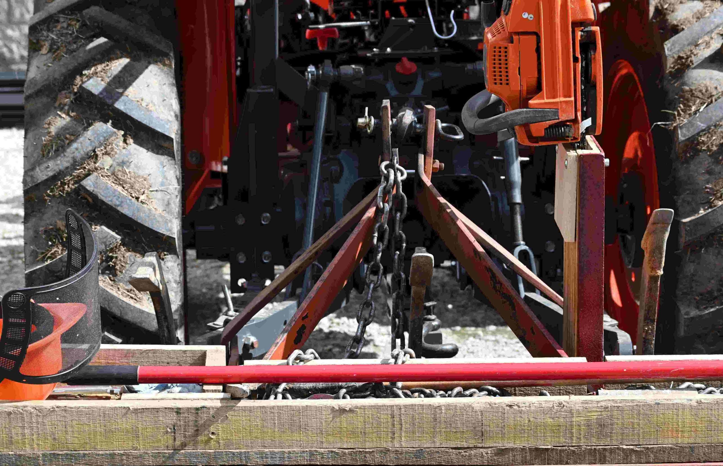

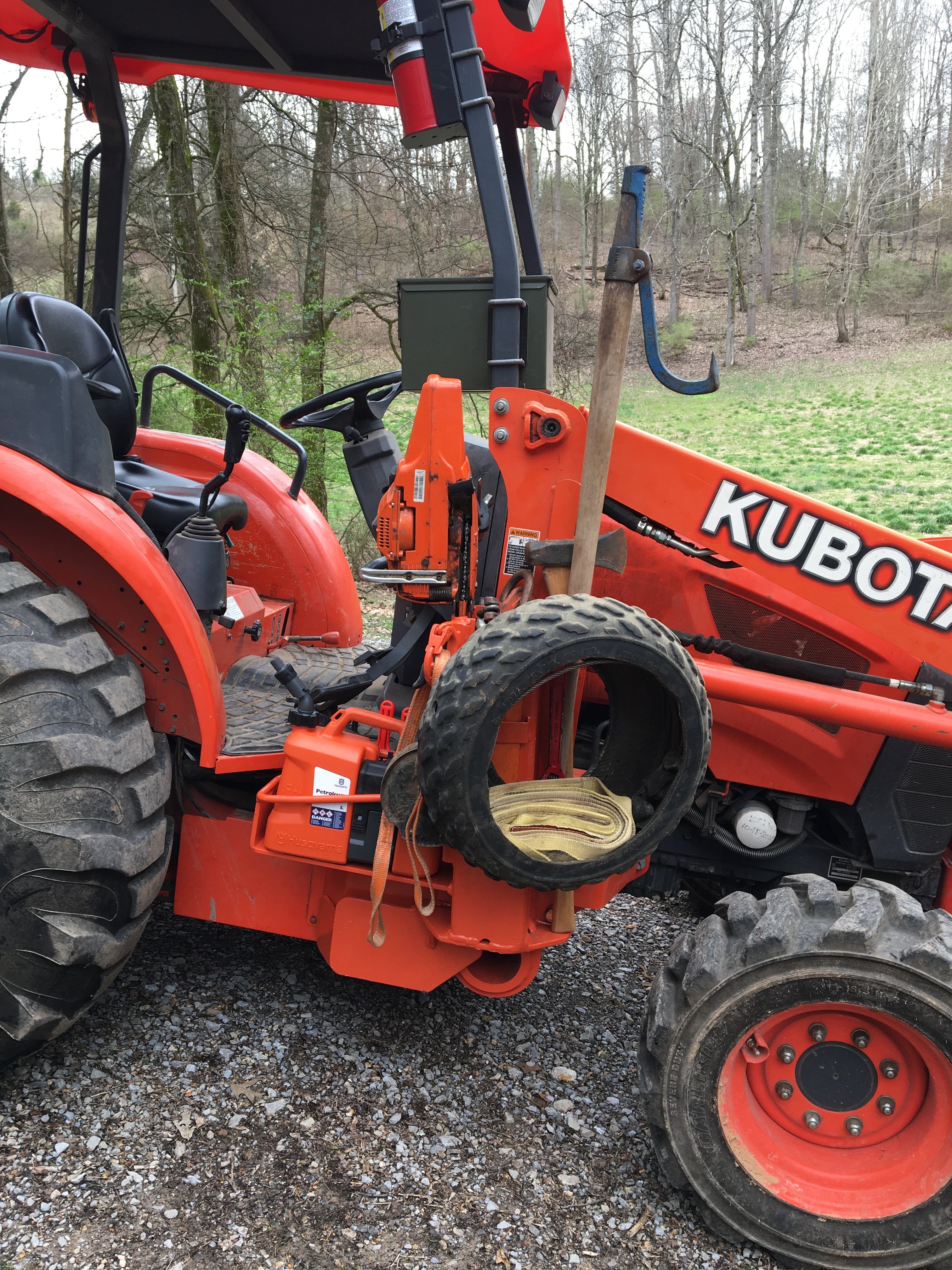

A grapple that has openings between the tines allows minor debris to fall out. I keep my landscape box on the rear as a counterweight and built a carrier on it for my chainsaw, etc.
I don't use it for woods work, but I also built a heavy wooden box insert that fits in my grapple to carry stones and cement for masonry work. You could use it to carry a chainsaw, but I'd suggest you consider building some kind of carrier to fit on whatever you plan to use as a rear counterweight.

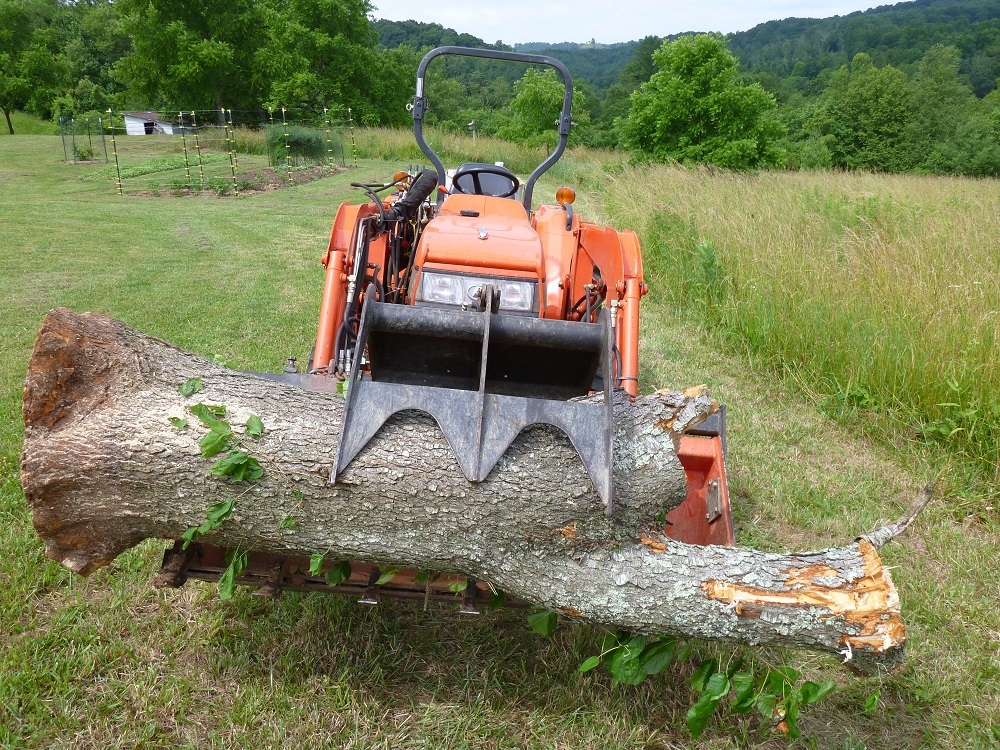

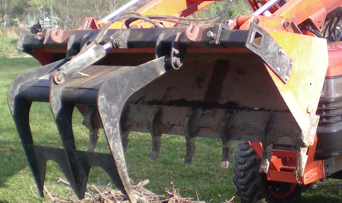

I use mine to move dirt also. Straight down - clamp up - lift & move. Even with the open tines - I loose very little.

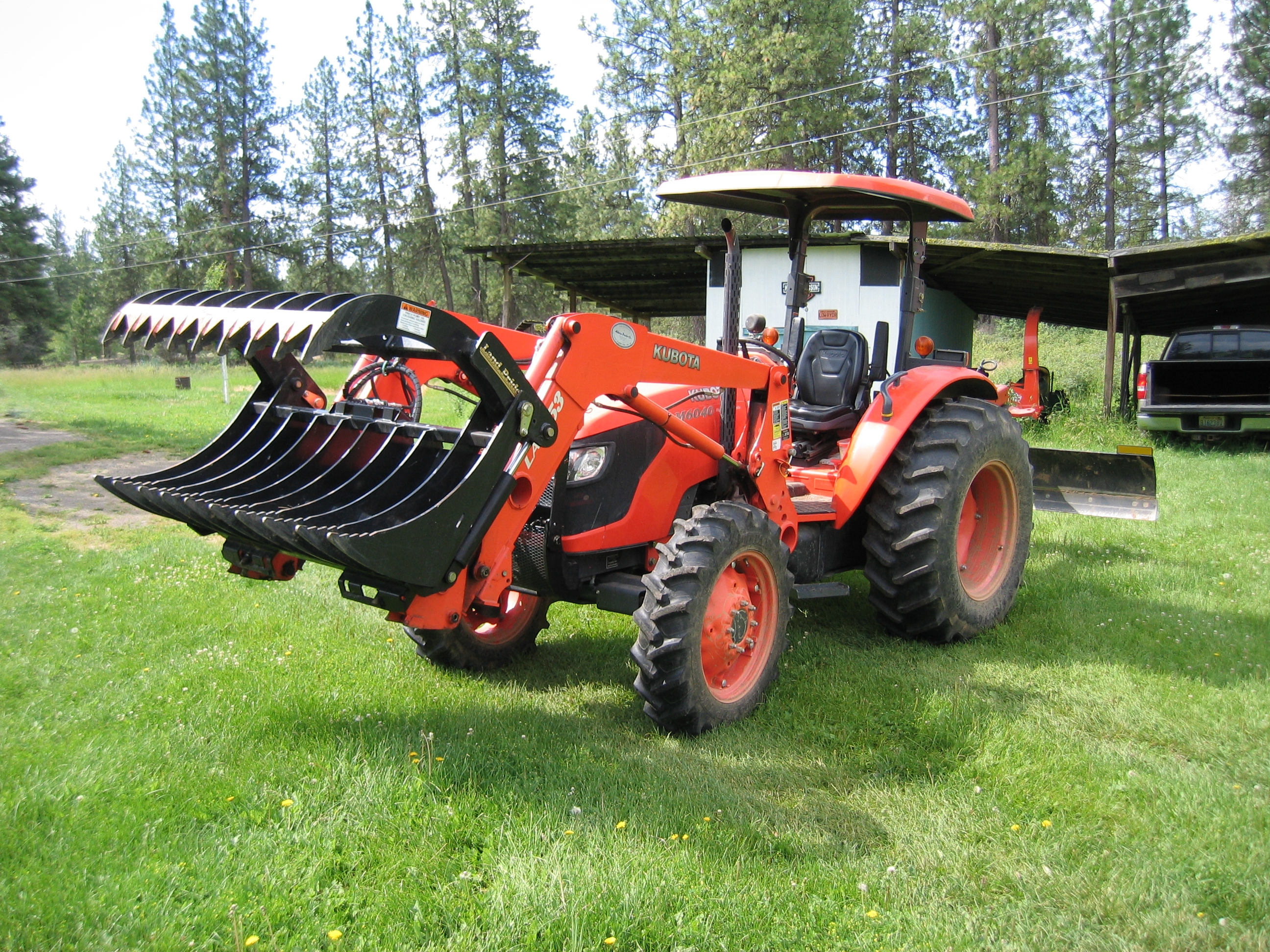

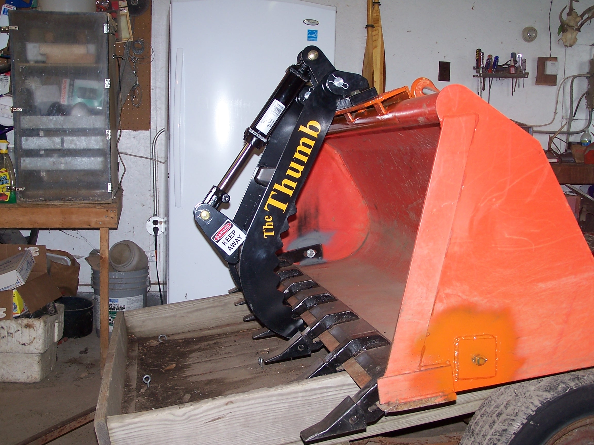

I have had a Green's Machine Thumb for at least ten years;very usefull and a lot cheaper than a full grapple.Limited opening but have used for logs,brush ect.
Mine bolts on and is removeable if ever needed.

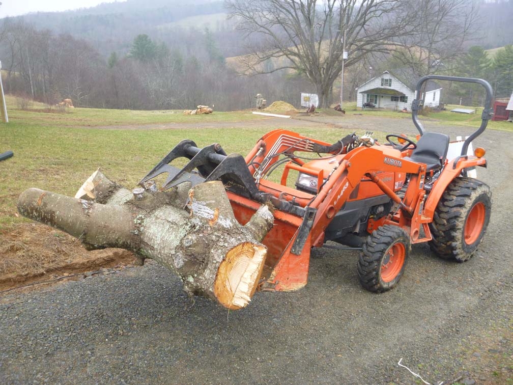

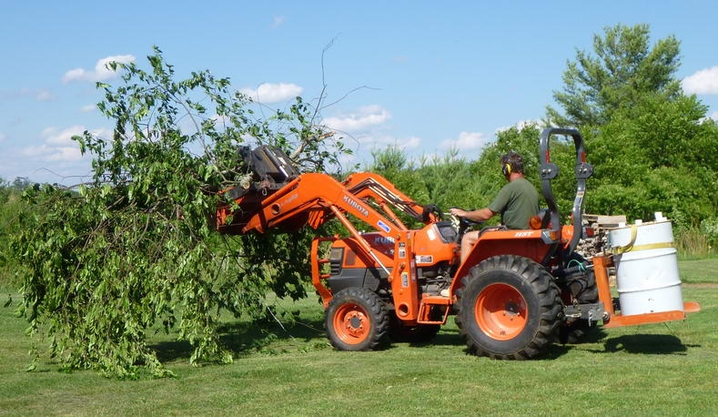

A clamshell style is superior for brush movement imo. That's what I have. I don't see utility in the other style of grapple. In fact, my fil and my uncle both liked my grapple so much, that they both bought the other style like you show, but neither of them use it. My grapple still sees use. They didn't think about the difference in style, they only bought what was locally available to them and it turns out the utility of the clamshell is far higher in my experience.
/ Solid bottom grapples #17
This is how you rake brush towards you and then roll the stationary part of the grapple forward to trap brush and logs. I can pick up big logs too.
