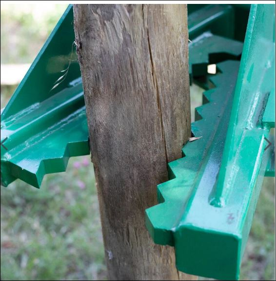

Just ordered a Titan Tree Puller, should be here tomorrow according to FedEx. I thought that a tree shear is really what I wanted and considered making 1 from some target steel. Then I saw the Titan add for a 'puller' and went for it. Picture is from the Titan site. The idea is to sharpen 1/2 of one side of the jaws nearest the hinge to get a shear action there. I can still grip with the far jaw teeth. Yes or No ?
Ideas? bolt on a hardened knife blade?

I run a mtl puller on my L3901, and from the start the teeth were sharp enough to mash smaller trees apart in a close appearance of shearing. Leaves a mess of a stub or stump but anything less than 2 inches across is most likely not going to be pulled and instead gets mashed in two.

I don't think that would work for me. To get the most lift power I want the tree closer to the tractor, thus hinge point. I would get quickly frustrated every time I sheared a tree I wanted to pull.

There’s a big difference in the clamp strength in the shear and a puller. I don’t think you’d be able to shear much beyond 2” and at that size you might as well pull it.

Yea, I think clamp strength would be lacking. And if you do shear a larger tree with that thing.....what control the sheared tree? What prevents it from coming back on you?
But as far as steel and material go.....I dont think you need to get too exotic....Wood is ALOT softer than even mild steel. Most logsplitter wedges are just mild steel and seem to do just fine

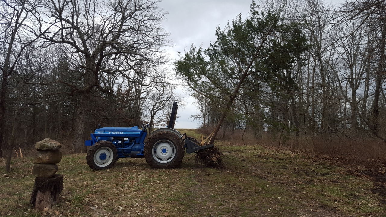

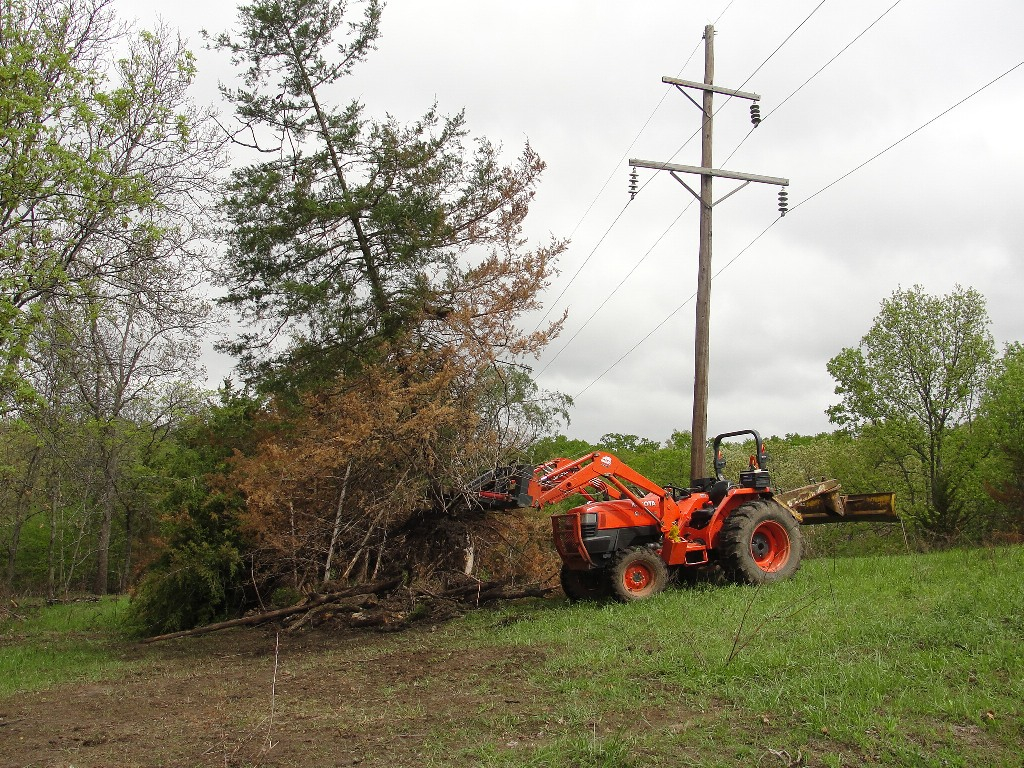

Good point on controlling the pulled/sheared tree. If pulling a larger tree I always push on the tree and lean it away from the tractor before dislodging the root ball from the ground.
I built my puller from mild steel. The jaw teeth haven't distorted at all.

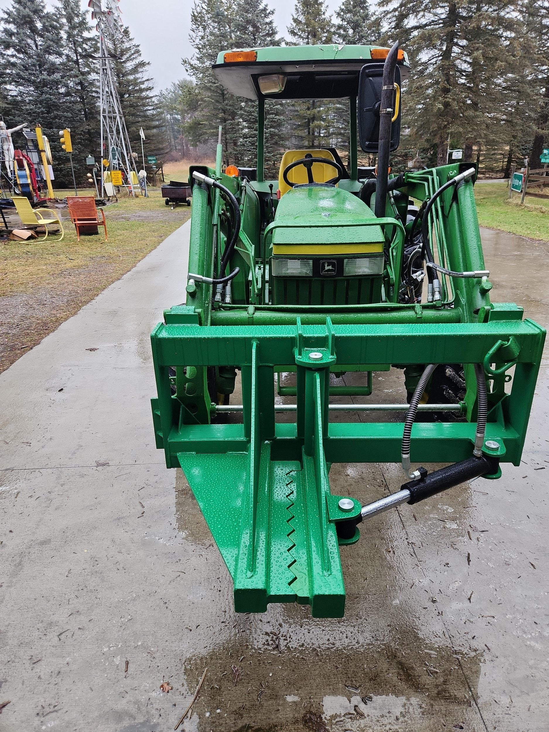

I agree 100% based on your assessment and also that of others. Here is the outcome: I have an 80 loader and easily converted it to the JD Hook & Pin Quick Attach system. Then I acquired a 7' snow pusher, forks, changed the bucket over, adapted a hydraulic motorized PH digger, and even rigged up a truck snow plow to the QA plate on the loader arms. BTW: I'm using a Summit 3rd Function diverter slung off
the tractor frame instead of the loader. This means I have selectable 3rd function options with the loader off for other applications

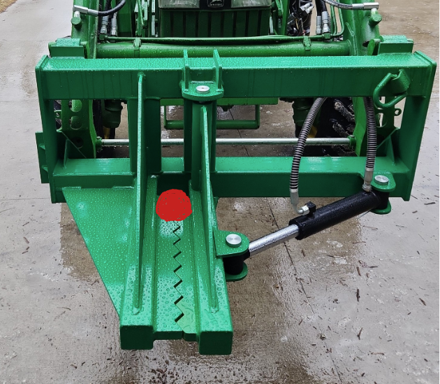

I agree 100% based on your assessment and also that of others. Here is the outcome: I have an 80 loader and easily converted it to the JD Hook & Pin Quick Attach system. Then I acquired a 7' snow pusher, forks, changed the bucket over, adapted a hydraulic motorized PH digger, and even rigged up a truck snow plow to the QA plate on the loader arms. BTW: I'm using a Summit 3rd Function diverter slung offView attachment 777042 the tractor frame instead of the loader. This means I have selectable 3rd function options with the loader off for other applications
Did you build your puller? Very nice!!!

No way ! Titan. On sale. Came in 4 days. Was advertised as "Free Shipping", but was charged $75 for Freight Service because of it's size & weight. Good thing I had forks because there is no way a semi-truck could make it down my road and turn around. Picked it up at the school nearby.

I built mine. It's not nearly as pretty but seems to function okay. I broke a hydraulic hose fitting at the cylinder once. You'll need to be cautious with yours the way they are plumbed. Thanks for the pic.
