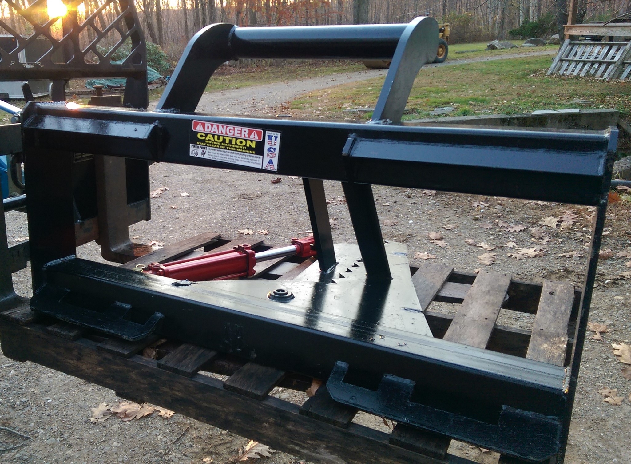

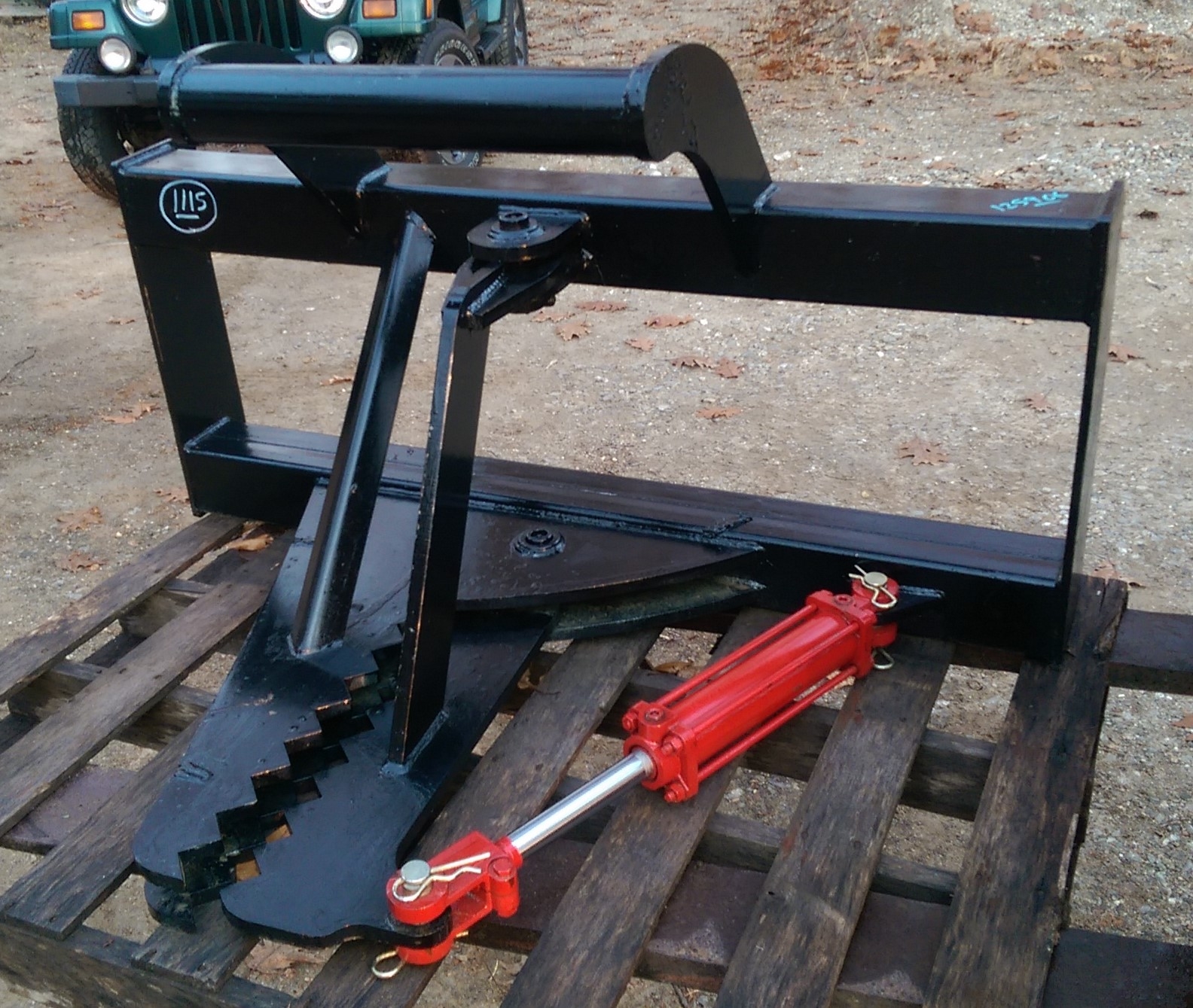

It wouldn't be too hard or expensive to weld on a push bar to the top of the tree puller frame.
I thought about that. I have the steel, so it would be free.
Yup... I would recommend one too... the one on our little puller makes a big difference... & ours is just a simple push bar. design
The one thing on my "to get to" list is building a protective cover for the hydraulic cylinder
