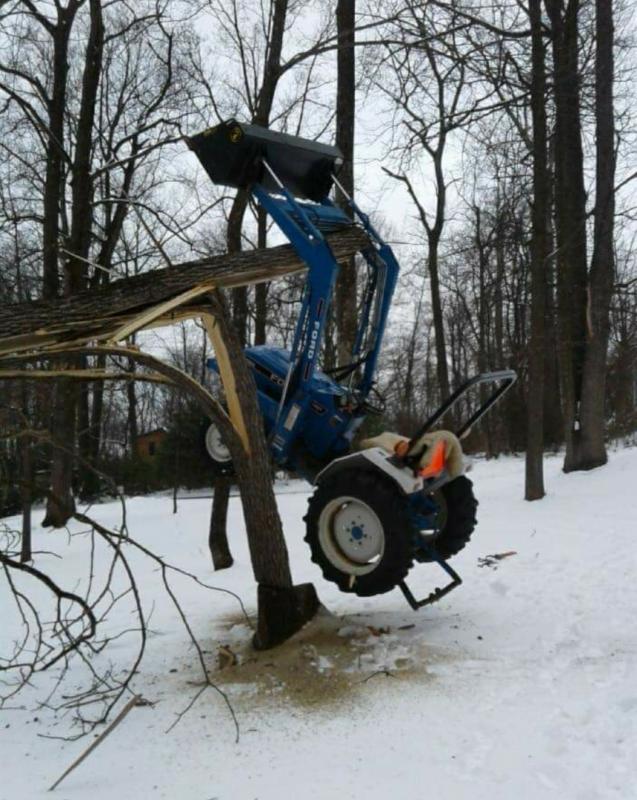

That almost looks like the tree wasn't sufficiently cut before starting to push on it.
.....of course that's not to say something similar couldn't happen if the tree was properly cut as well.
Large standing trees and heavy equipment that isn't designed/intended for tree harvesting can be a risky combination - kind of makes a chainsaw and proper use of wedges actually seem like a safer method.
.... but that just might be me.

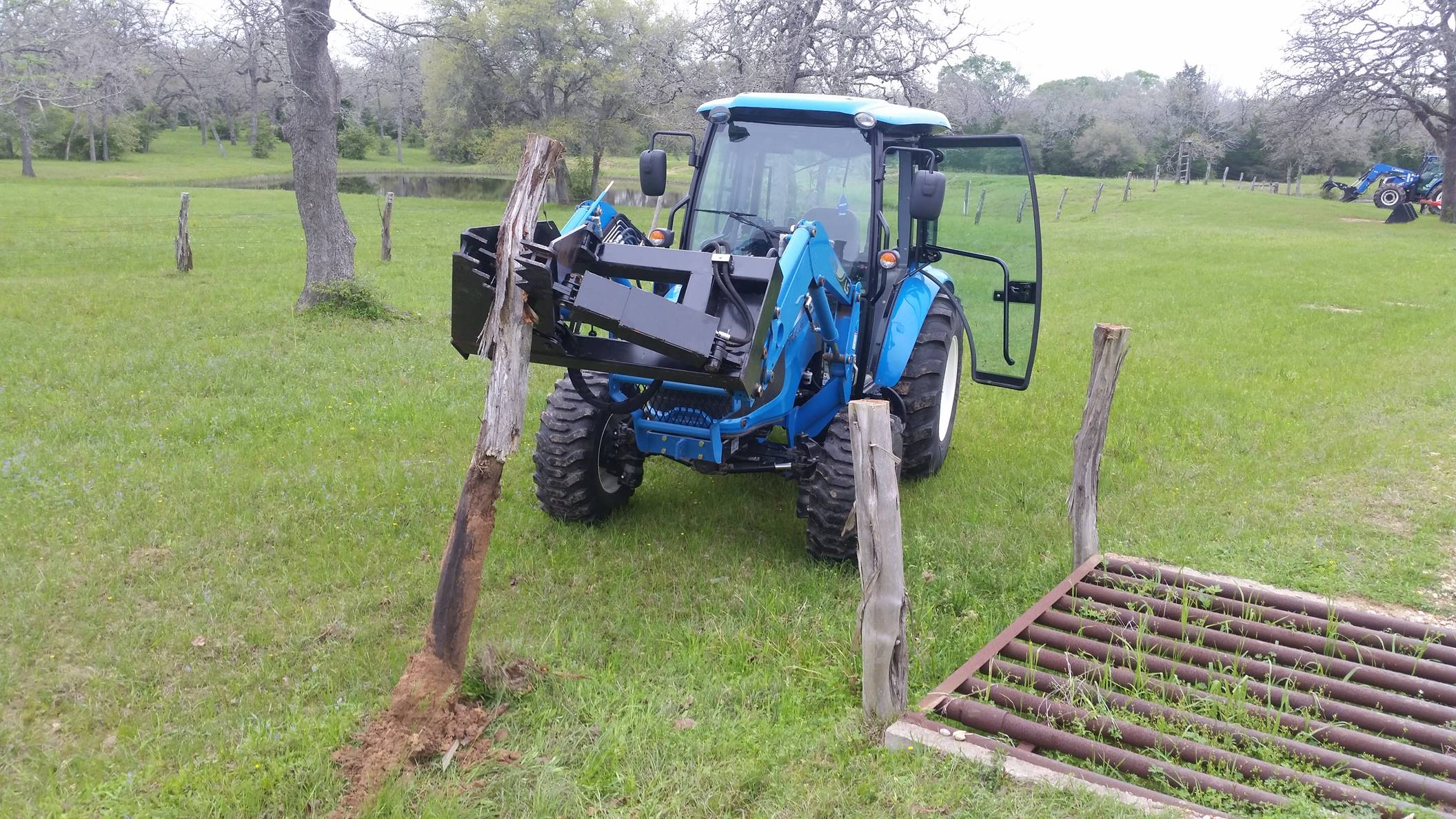

It takes a fine touch, with your 3rd function, to not just crush everything. When I pull fence posts, I grab them near the top where I have a good view. I close jaws to where I know I've got enough clamping force and lift.
When I cut cedar trees, that are at the base of oak trees, I leave about a 3' stump. I ignore the stumps for a year then go back and yank them up with the tree / post puller. Lift them up, shake the dirt from the roots, and drop them. I come back late with the grapple to pick them up.
