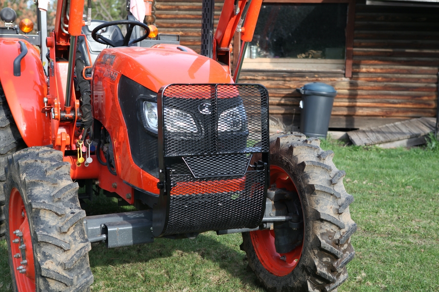

Another thing - modifying your OEM grill guard. You may be getting a grapple. You DEFINITELY need to mod your grill guard. Like SmokyDog - post #24 or as I show here. You do not want a limb, stob or trash finding your grill, battery or radiator.

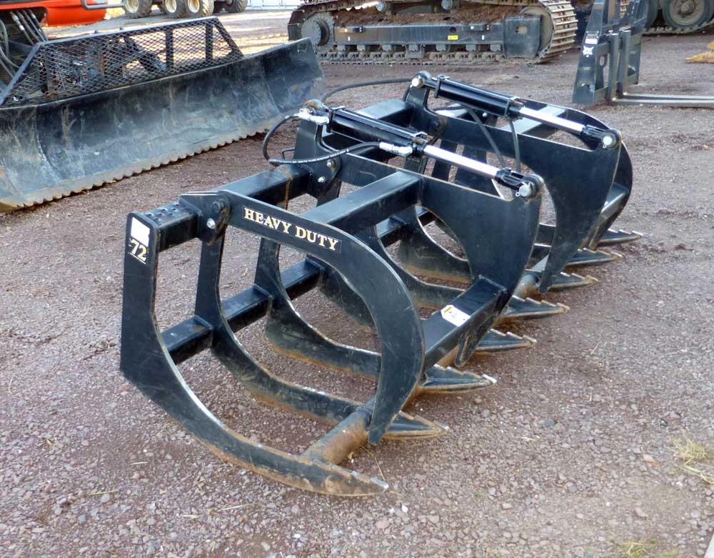

Seen this yesterday at a nearby bobcat dealership. I want it, but maybe a more narrow version.View attachment 1737143
Nice, hopefully priced well for someone.
Imho, grapples are better a bit narrower than the tractor. You can still pick up branches much wider than the grapple. More size = more weight and less maneuverability. Ymmv.
