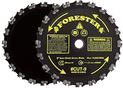

I don't own a Combi Tool, but do own their FS250 and use it often with a saw blade on it - mainly for cutting Buchthorn (an invasive tree that I'm overrun with.) Before that, I owned a similar Jonsered brush cutting saw for many years (until I lent it to a friend who straight-gassed it.) I much prefer the Chisel tooth blade (or the similar Maxi blade sold by other manufacturers) to the one that looks like a circular chainsaw wheel. The chisel or Maxi cut more efficiently.
I use the Forester circular chainsaw wheel on my Stihl Kombis...fwiw - I have the Stihl Kombi KM130R and KM131R models; also use a wire brush for patio and wall work - I saw some posts in this thread about windows breaking while kicking up stones with wire brushes -- misery loves company:)
How do you keep them sharp?
/ trail clearing technique and tools #1,325
Same way you sharpen a chainsaw.
Not difficult to sharpen, but for my uses, other styles of blades work much more efficiently. I don't see a lot of those Forester-type blades used by guys who use clearing saws professionally.

When you are doing thinning - cutting saplings up to a couple of inches in diameter(or more, depending on the clearing saw you are using), there really is not another choice. The metal 3 armed blade won't make through saplings this size, and a string trimmer wont do much more than strip the bark. Something like the Forester blade or the blades that look more like a circular saw are the options for that. Chainsaw blades rob a lot of power. I find the "circular saw"-looking blades a better choice, IF you get a good quality one. Husqvarna and Oregon sell some of the Maxi style (made in Sweden). I suspect others sell them as well - probably all made in the same factory and relabeled. They good quality, hold up well (if you keep them out of the dirt and rocks), and easy to sharpen.
