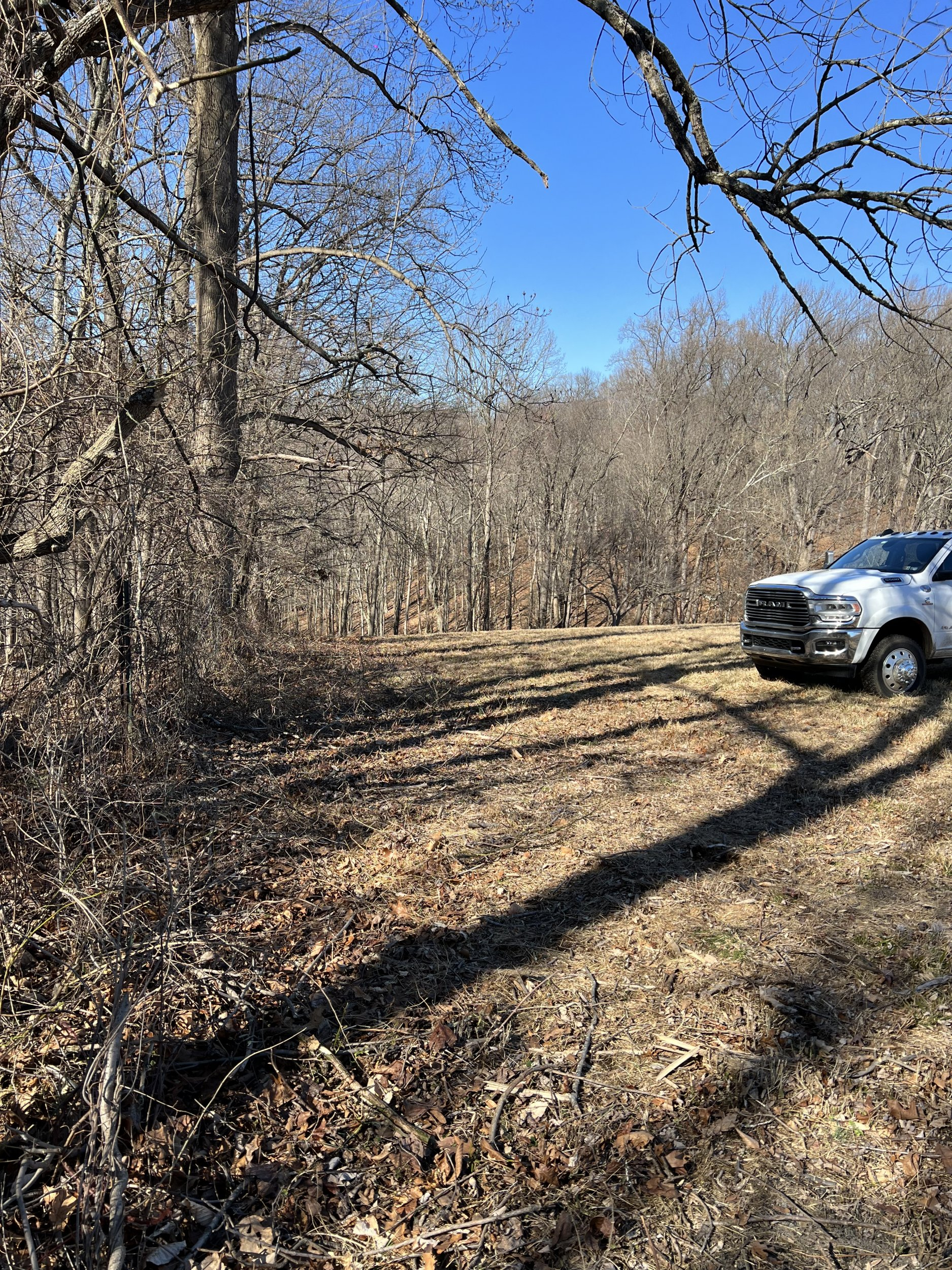

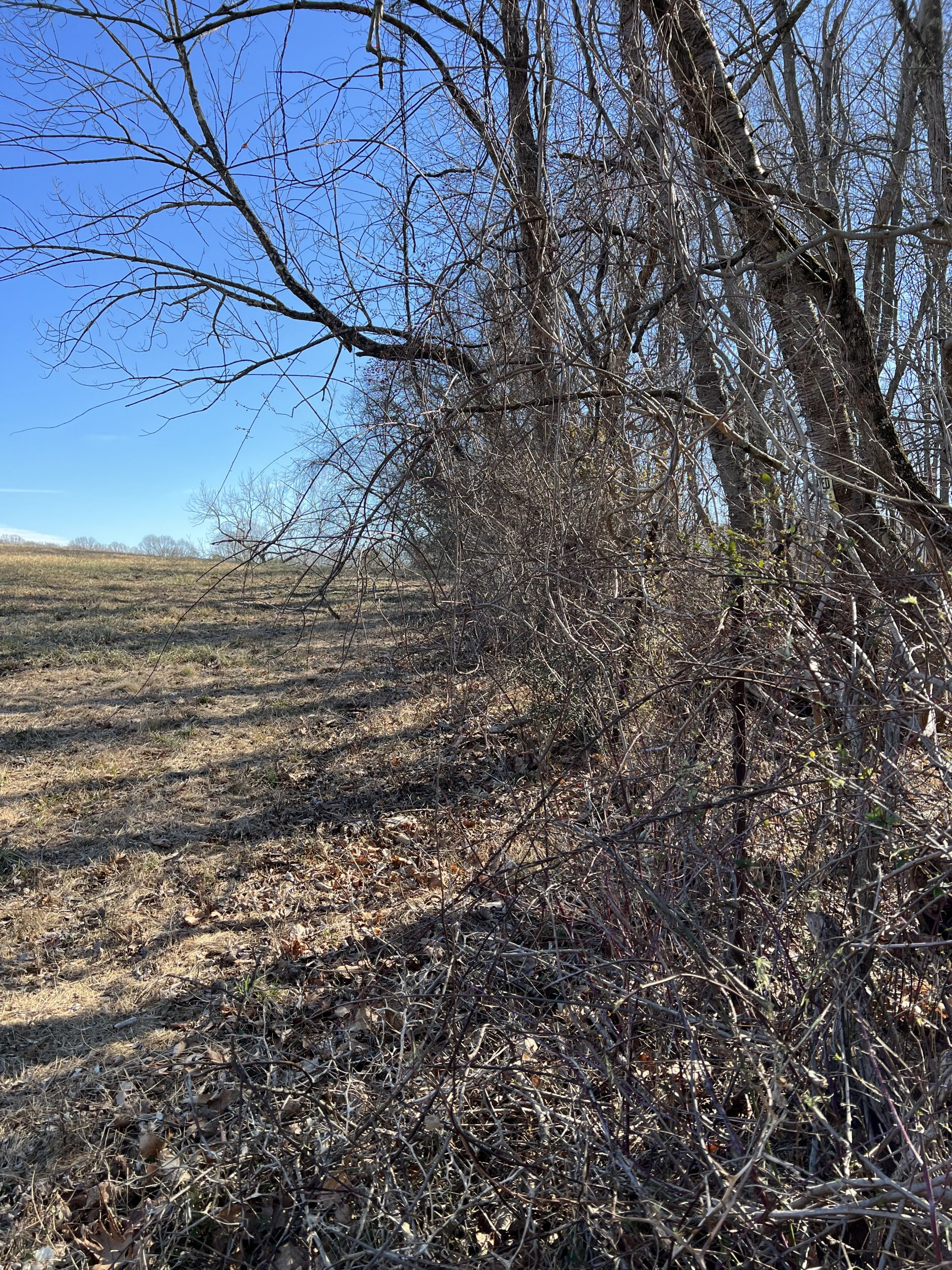

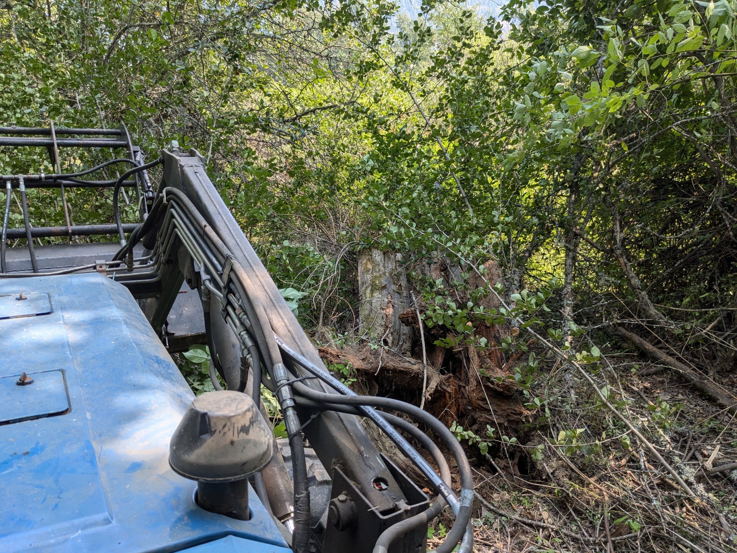

Got a 'rough' trail in, started with the Rhino tractor and the Woods Brush bull and grapple lots of brush higher than the roof I starting mowing from the spot in the first pic after moving the log out of the way..
Some chainsaw action and grapple grabbing brush, made the mistake of hand moving what I cut with the saw and didn't notice some of it was thorn apple, which was made obvious pretty quickly.
Some large rotten stumps I was able to just push with the grapple/ bucket on but then a tree came up that just had to go so went and got the TLB and could not believe how stubborn it was to get the stump out.
Once that was cleared brush cut more with the Rhino then it got pretty tough.... big ditch that was several feet deep and there was a large downed tree that was near so used the backhoe and hydraulic thumb to put it in the ditch lots of breaking up the higher level to be road with backhoe and dragging it into the crossing. Back to the brush cutting and got across the ditch and able to get to the beach area after several years. Going to be golf carts only after this.
With all the stobs I hit, feel lucky that I did not get any flats. Also took a few breaks from brush cutting and used a battery saws-all to remove some of the worst offenders.
Beach is still there and needing some work but not going to get anywhere near the water with machinery
Just realized I didn't take any pics of the path after.
That's some really tuff stuff you had to clear. I'm not sure if I'd even give that at try. Congrats on your tenacity.

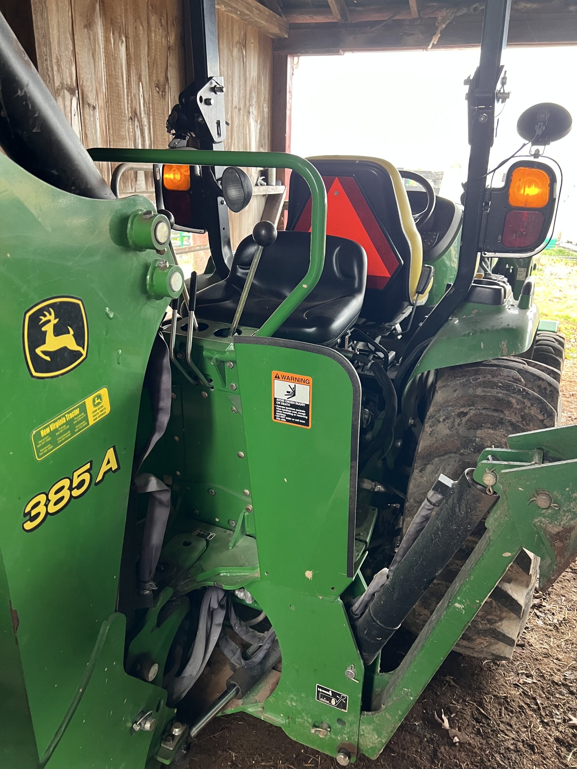

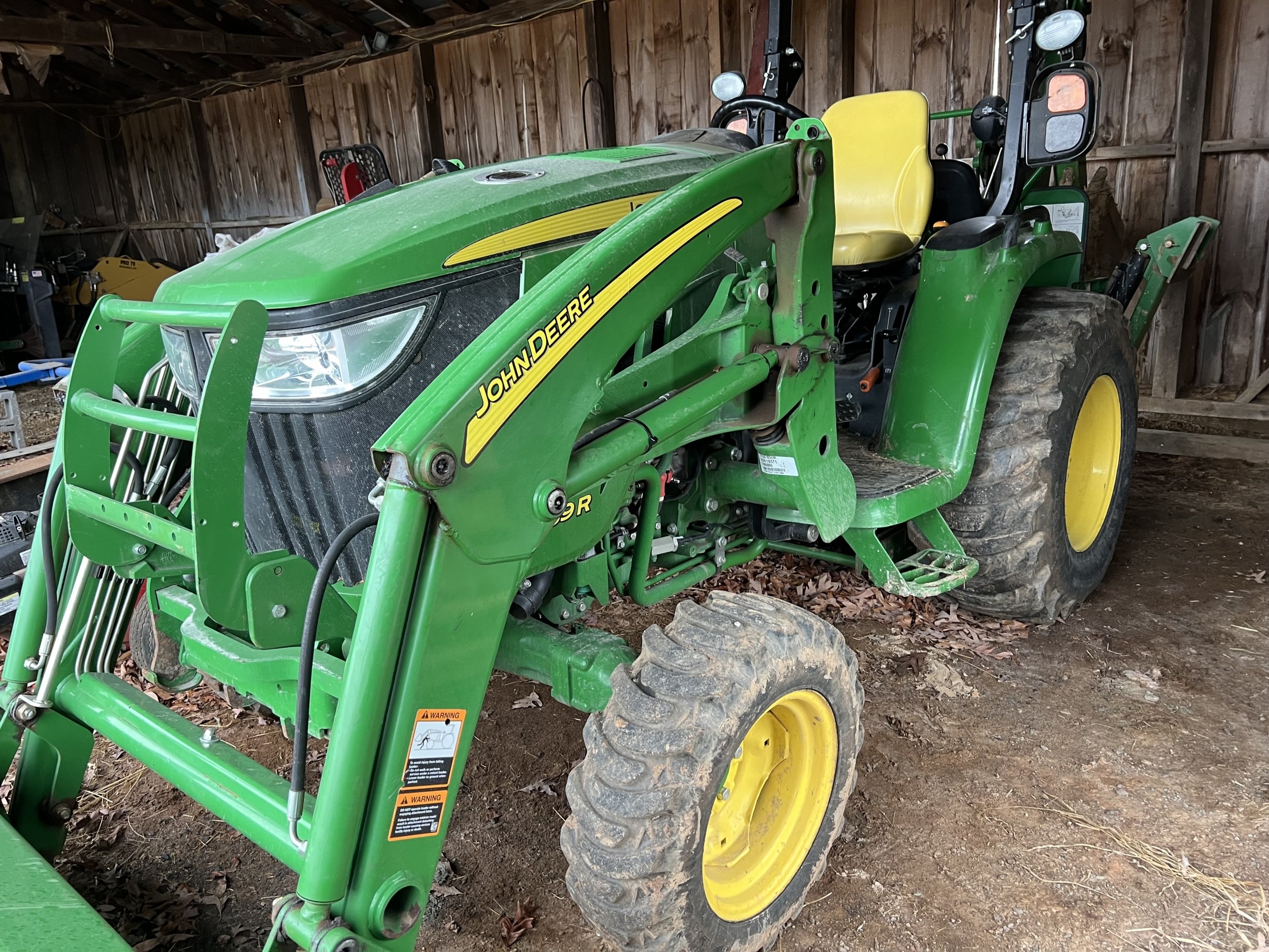

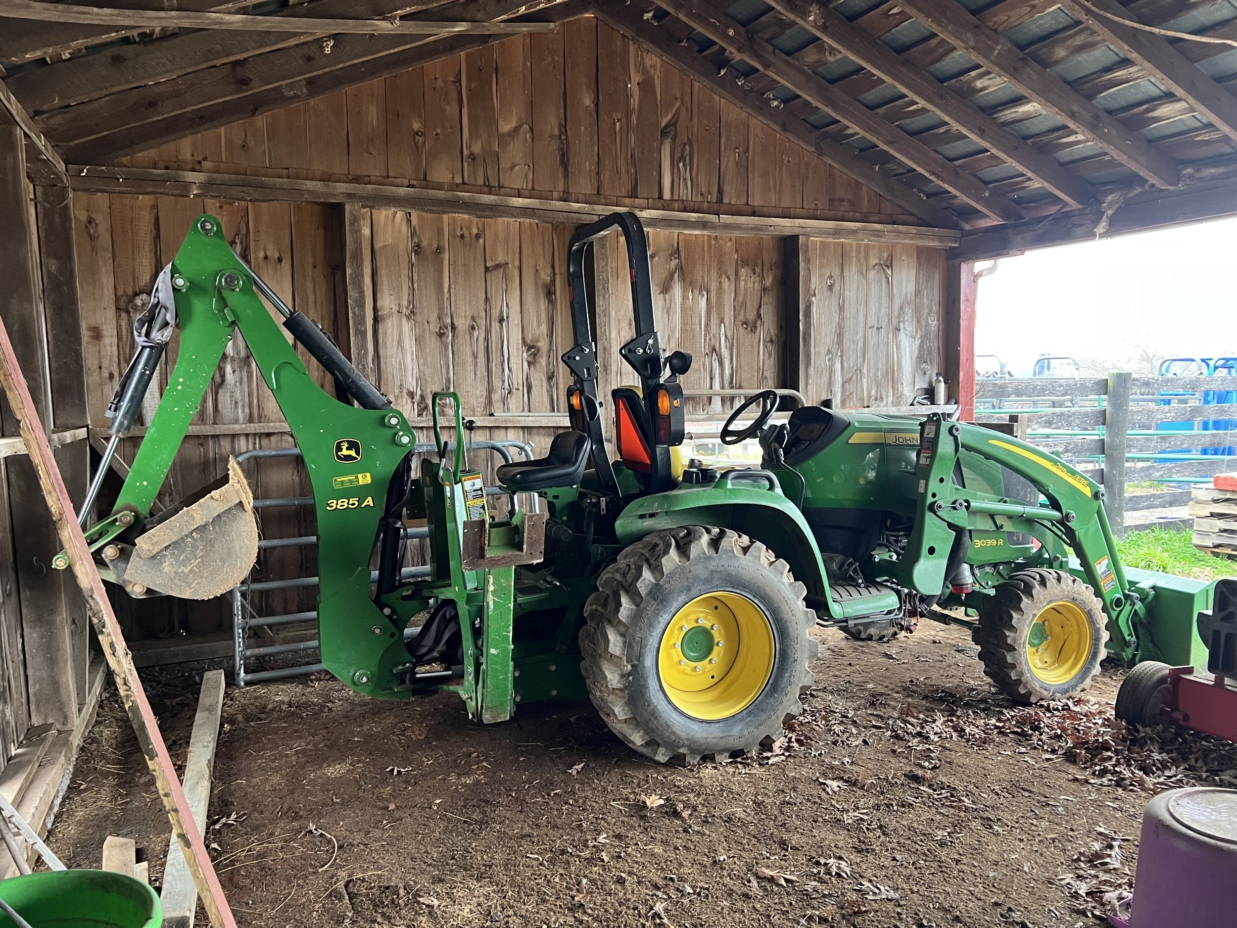

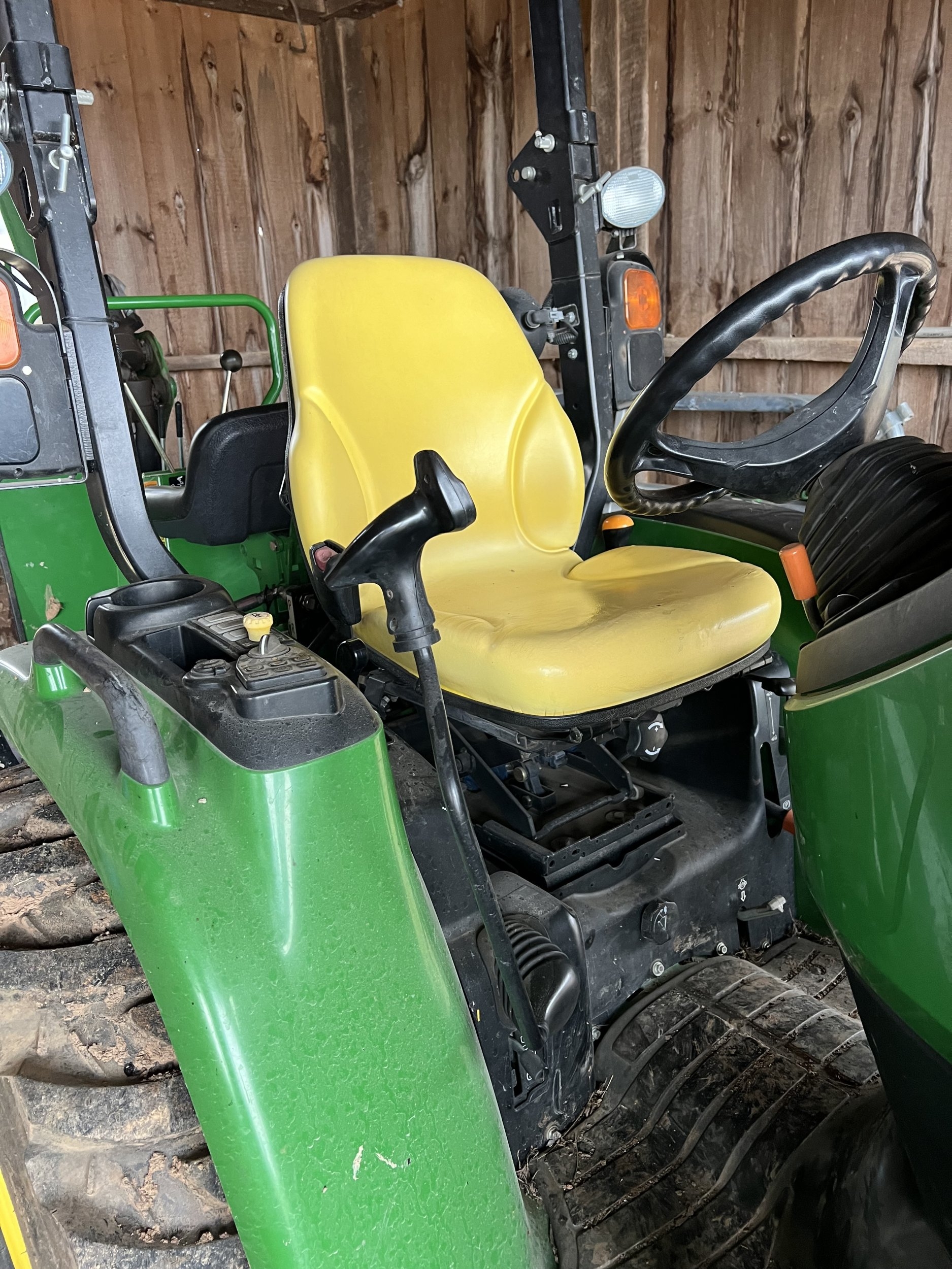

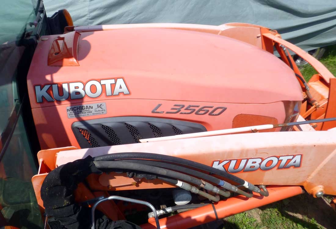

If I could locate a good used JD 3033r or 3039r tractor at a reasonable price I'd be ticked pink. I'd go for a Kubota as well but I don't know there line very well. Here is one I used View attachment 882306View attachment 882332
I’m just about to trade my 2016 3039R, H165 loader w/61” HD bucket, 385A backhoe w/18” HD bucket, 900 hours.
The dealer is giving me $30,000. I’d be happy to sell it privately.

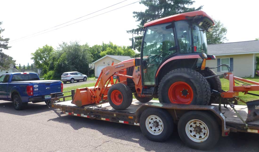

Fascinating thread; love reading all the info; obviously got a ways to go. I maintain 10+ miles of trails. All 8 - 10' wide but a lot are quite steep. FWIW - here's core stuff in my toybox. I built the trails mostly with my mini excavator (Kubota 161 and now a 057) over the last 10 years. Also used a Kubota B3200HSD (tractor) with a tilt and level 3 pt hitch and box blade (game changer). Stihl Kombi tool is a must have for me - I have one that I keep a chainsaw bar on, and another with a chainsaw wheel. I also have a bunch of Stihl saws. I use a Rut Mfg Tree Slayer (brush cutter) on my mini but it is impractical for extended mowing use as it is a sit and sweep type tool. Just purchased a Kunz brush mower to tow behind tracked ATV.
Here's the obligatory Kubota photo.... I love Kubota (diesel of course) - their RTV is heavy and slow but with the Camso tracks is amazing; have used their stuff since the 80s. Kubota reliability has been phenomenal. My ATV is a Can-Am Outlander 1000 with Camso tracks- use it mostly in winter for xc ski trail grooming.
