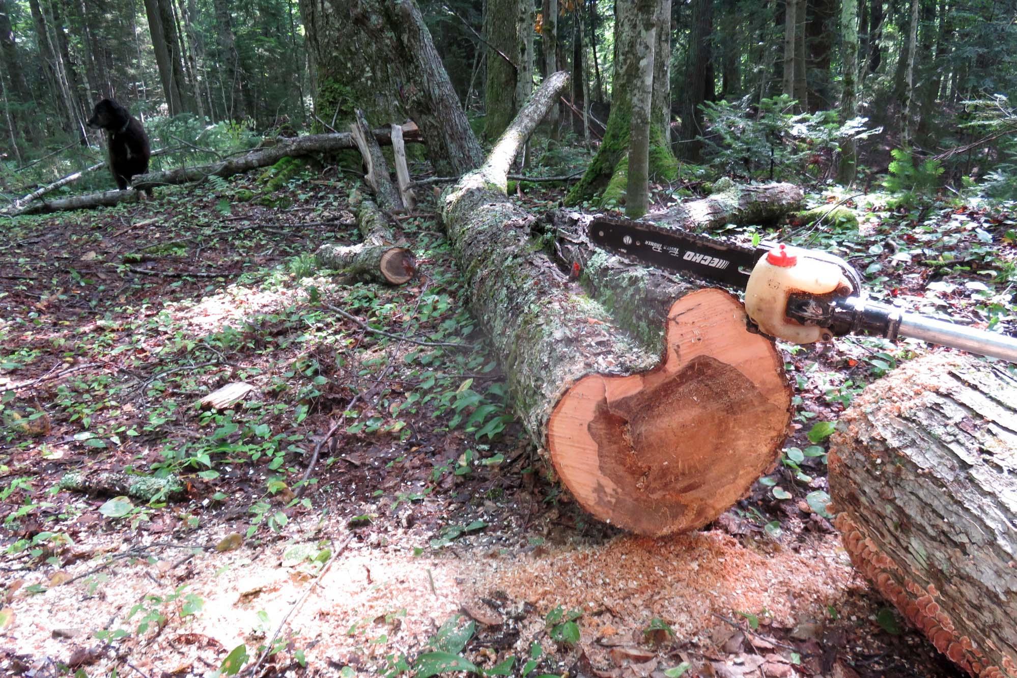

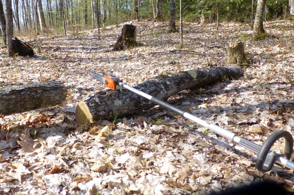

This dead fall needs to come off. At least a 3ft section of it!

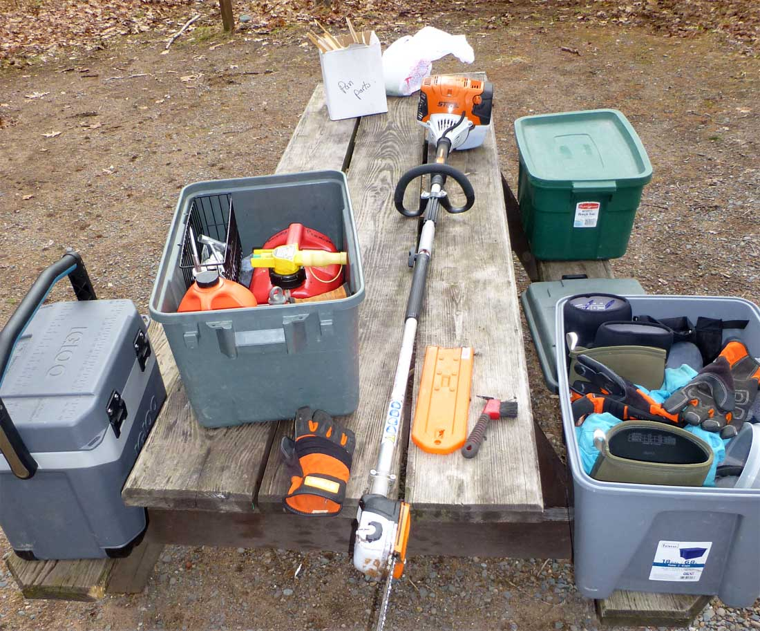

Pole saw and tools setup.

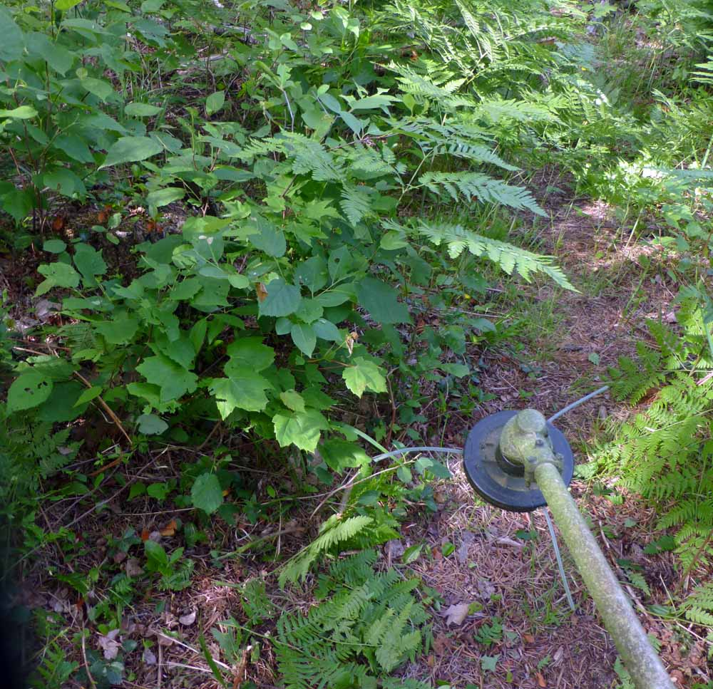

This photo is knocking grass down on a XC trail.

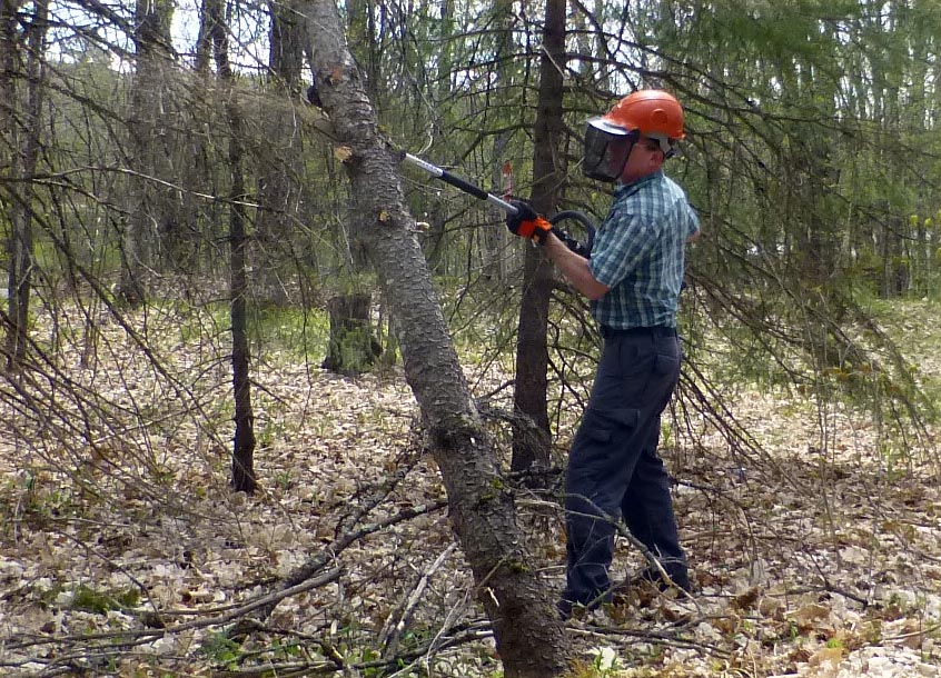

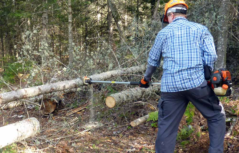

Most of the work we do is with s pole saw combi type setup.

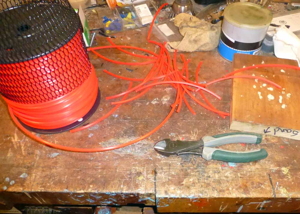

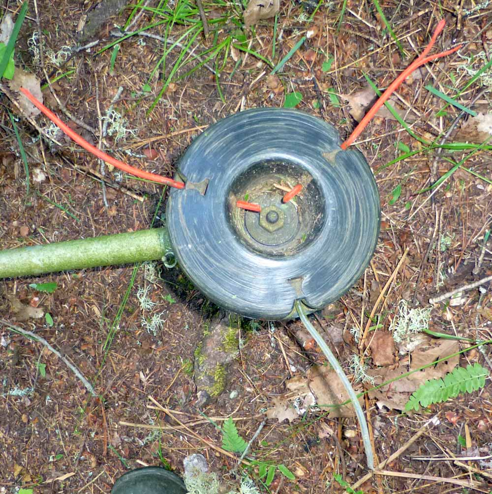

The vast majority of sawing we do in the field is with a pole-saw which we are proponents of. We also use these to run .155 and heavier strings to knock tree shoots and tough grasses down. Stihl is suppose to be coming out with a head to hold .180 string which we will switch to asap.

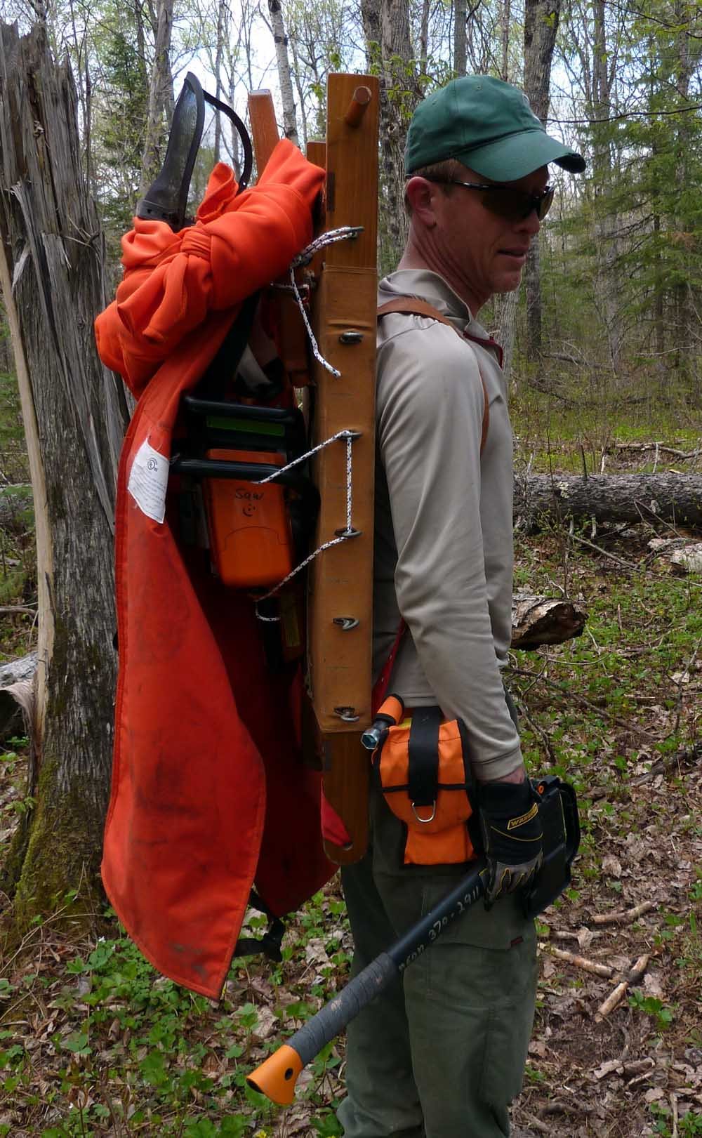

Oof, that wooden ladder backpack doesn't look real ergonomic lol.

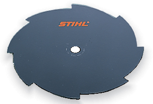

We discontinued the use of steel blades due to a rock problem. Like they are everywhere! :cool: This photo is the style we had used. Today we hope to completely swtich over to .180 string which will take out pretty large shoots and doesn't care if you have rocks or not. We have used .155 for years. This new and larger string really works well on tree shoots and if it doesn't outright cut them off, it beats the life out of them anyway.

I'm not sure what your vegetation is like there ken, but another reason we gave up on the steel bales, was there cutting radius was so darn small, compared to running string. Even if we ran into young trees the string wouldn't cut, we still got all the weeds, grass and smaller shoots cut while the heavy string was undeterred. (not broke) We could then follow up with a lopper and finish off the ones the string couldn't handle, but there wouldn't be all that many anyway.

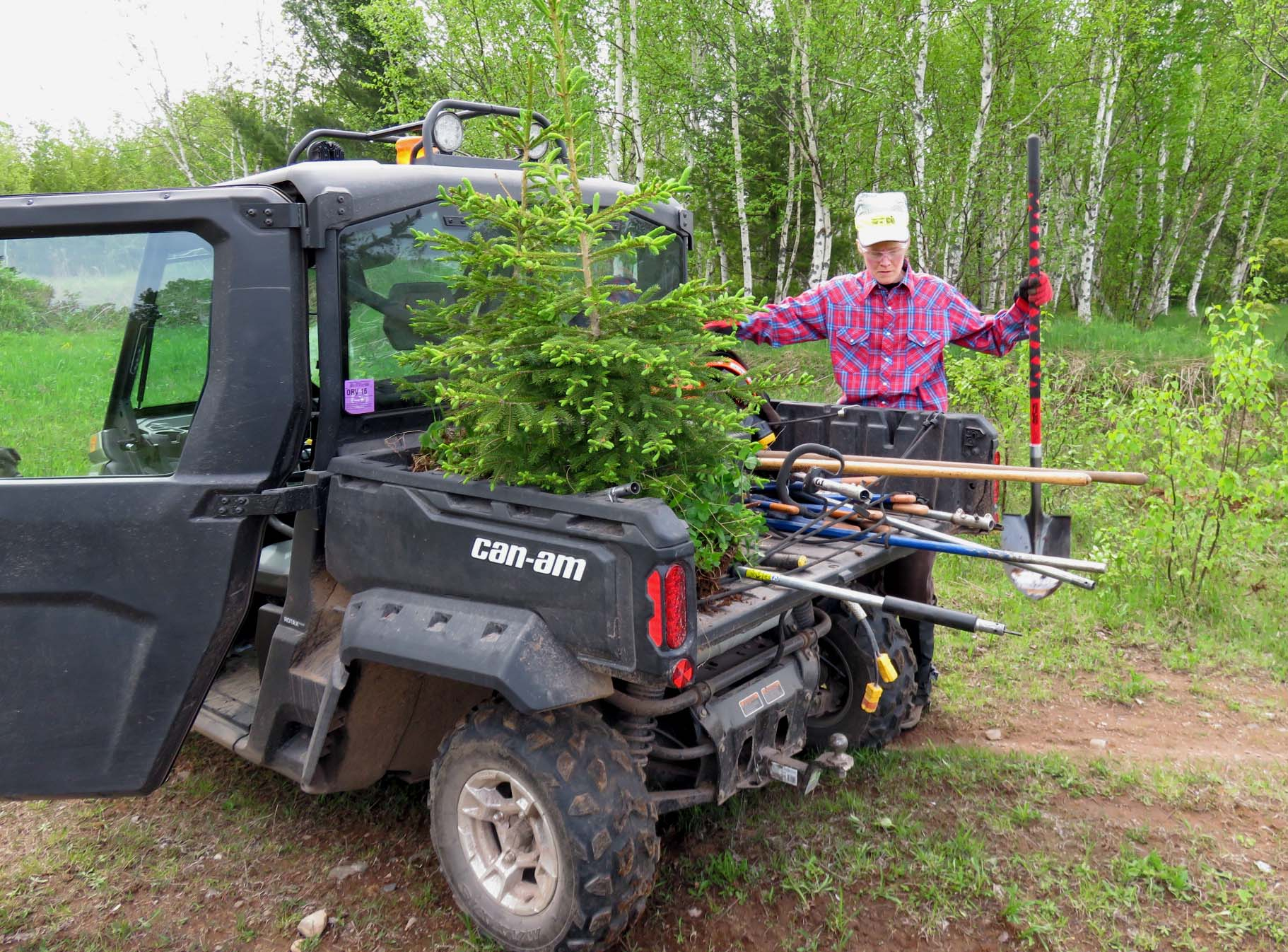

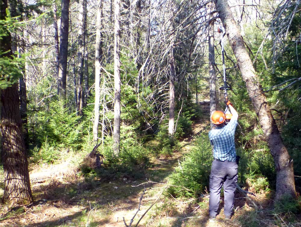

Clearing a NFS trail on Lake Ste Kathryn in the Ottawa NF in the upper peninsula of MI. The spruce bud worms make for regular work here. :(
Now all better!
Before
And after. All saw tools all carried in the DAKINE Builder 40L backpack you see here which is a darn good pack.
