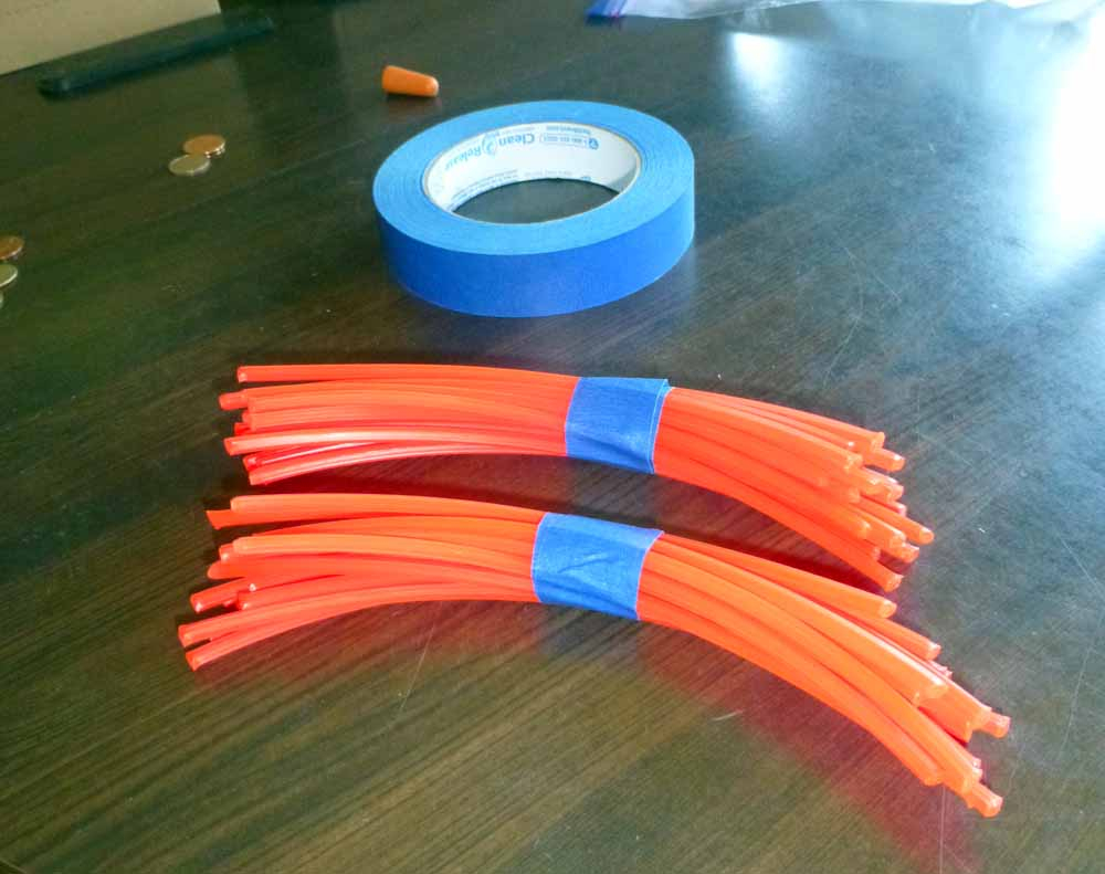

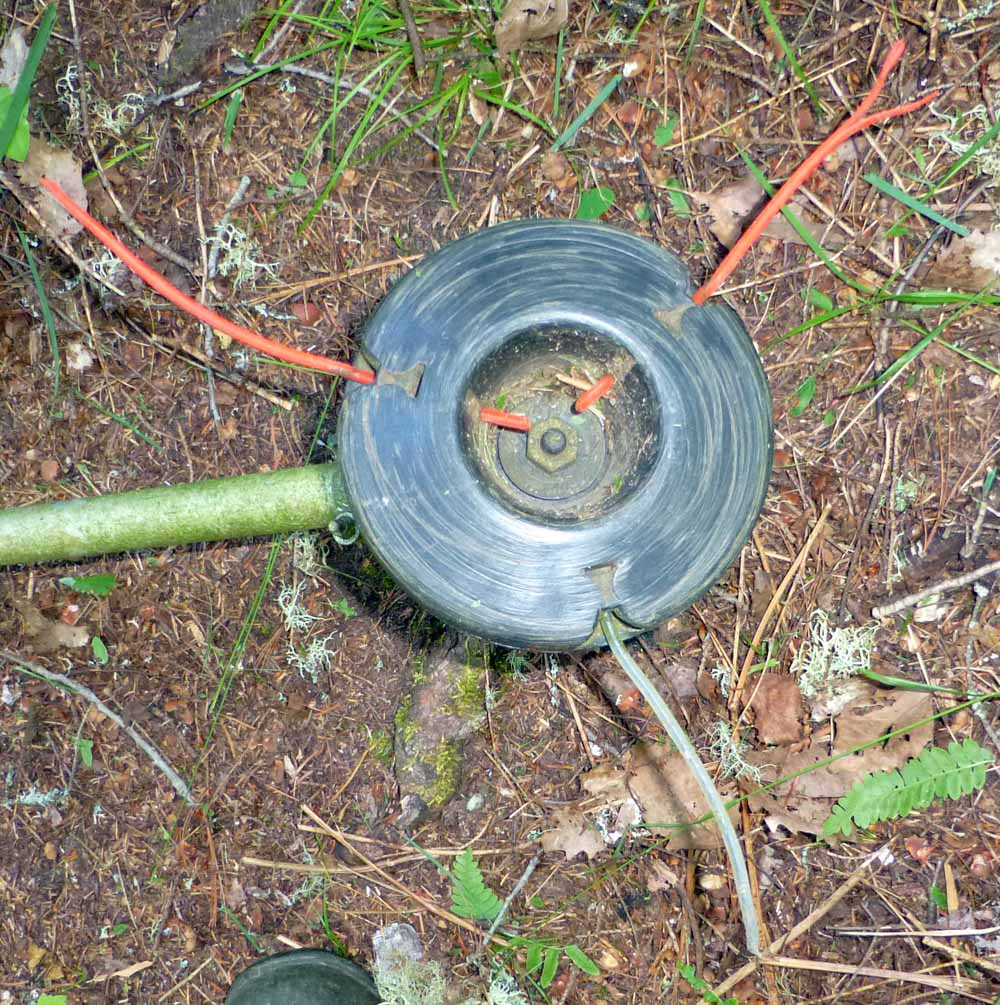

Gee Elven, we need to get you updated with a proper string head. :D Like you, I hate re-spooling those coil string heads and will never-ever go back to them. And more important that .155 thick string can cut serious weeds and tree shoots. Bad thing is they'll shoot rocks like bullets and can damage house parts. My spouse knocked the glass out of a our truck that was parked near by. Seen below is a string bundles we go into the field with and we can change out strings, in less than 60 seconds. We use a line-men pliers to do that.

My dad had one of those 4 wheeled weedwackers prob 17 years ago and it had a head that used strips of strings like that and it was a pita to change them. Granted good quality string has come a long way in durability but the memory is still there.

There are quite a few varieties and stiffness of string out there. We found the more flexible stuff lasts longer, but cuts slightly less. Nonetheless, we buy it by the roll and it costs little and we sometimes go all day with the same string. Then on other days, it last 2 hours. Trees and rocks chew them up fast. In the above photos I didn't change any string but I can't guess what your weeds and shoots are like.. :unsure:

This is me cutting and making new string bundles. The sharpie marks are the length.

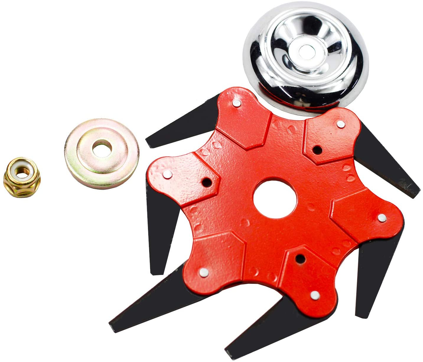

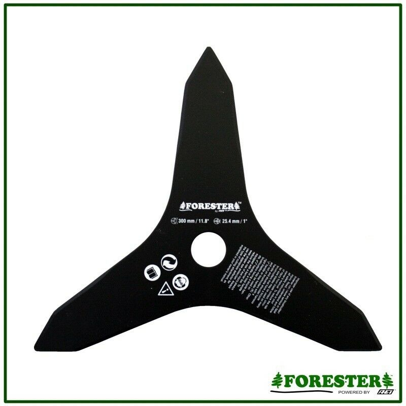

I don't take any string into the trails because I'm dealing with taller grasses, blackberries (thorns) and 3/8" face-slappers.
I found a blade like this for my Echo trimmer and it's extremely helpful. Rocks don't seem to bother it and it will take out stuff just under 1-inch. It's been great for me.
We discontinued the use of steel blades due to the rock problem. Like they are everywhere here! Plus we couldn't run them against the ground and there cutting radius is so small. Today we hope to completely swtich over to .170 string which will take out pretty large shoots and doesn't care if you have rocks or not. We have used .155 for years. This new and larger string really works well on tree shoots and if it doesn't outright cut them off, it beats the life out of them anyway.

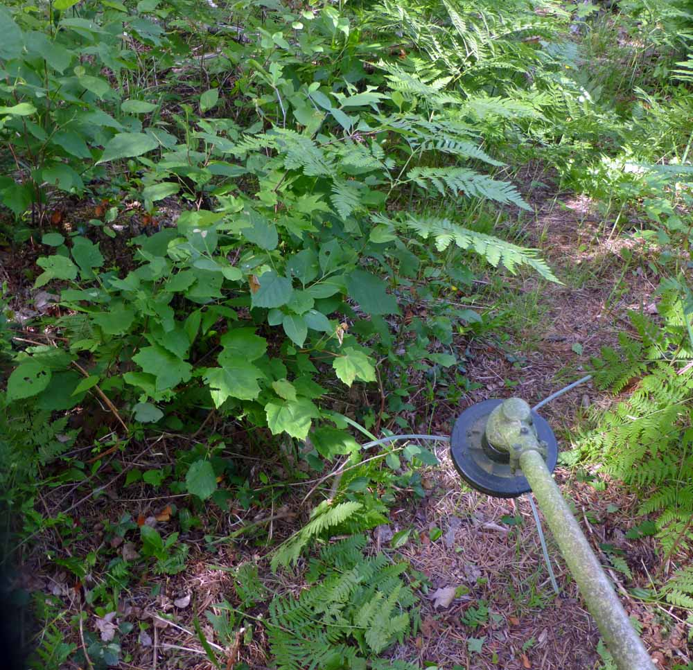

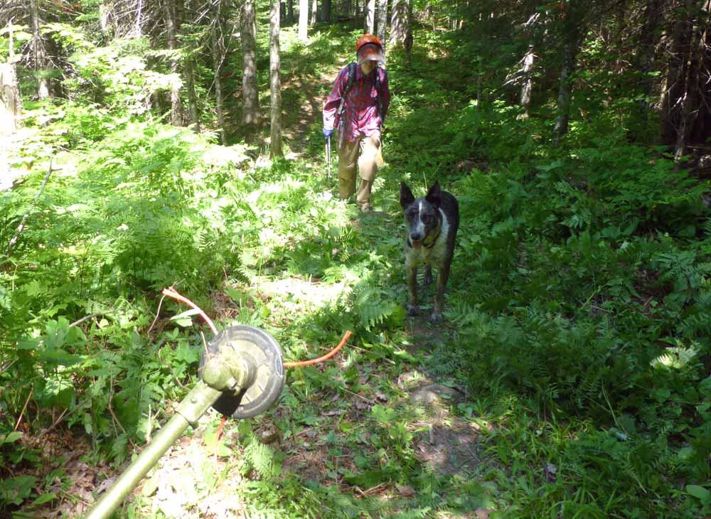

Suggestion for all people who'd like to knock down heavy weeds and tree shoots. Even bushes in some cases. Get a .155 string head for your power head. These cut much quicker and more safely, than steel blades do.
