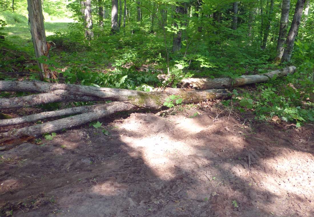

Earlier in this thread I mentioned some work I helped with on trails in Wilderness areas in the Cascade range where only human powered equipment was allowed. A technique they used to roll massive old growth logs off the trails was to take some webbing (probably 30-50 feet?) and wrap it around the logs. Probably 3-4 wraps over top of each other so it would bind on itself. Then, from a safe position, they would get 2-3 people on the tail end of the strap and pull on it like a pull cord of a lawnmower. This would start the log rolling and move it right off the trail. It helps if you can use slope/gravity to your advantage to get it rolling.
One needs to be very careful when doing this of course. They guy coordinating the work would sit for 5+ min and just look at the situation before doing anything. He was looking for hazards, the way a tree might twist or pop as it was being cut, escape routes, overhead dangers, etc. "Look up, Look down, look all around" was his mantra. Then he would set up the situation (be it a cut of a log, or movement of a log, etc). Then he would sit again and assess the situation one last time before acting.
We were moving logs 3-4 feet thick and 10+ feet long with 100% human power with this technique.
In the photo below, we made one cut on the log on the uphill side, then used the webbing technique to roll the downhill side away and clear of the trail.

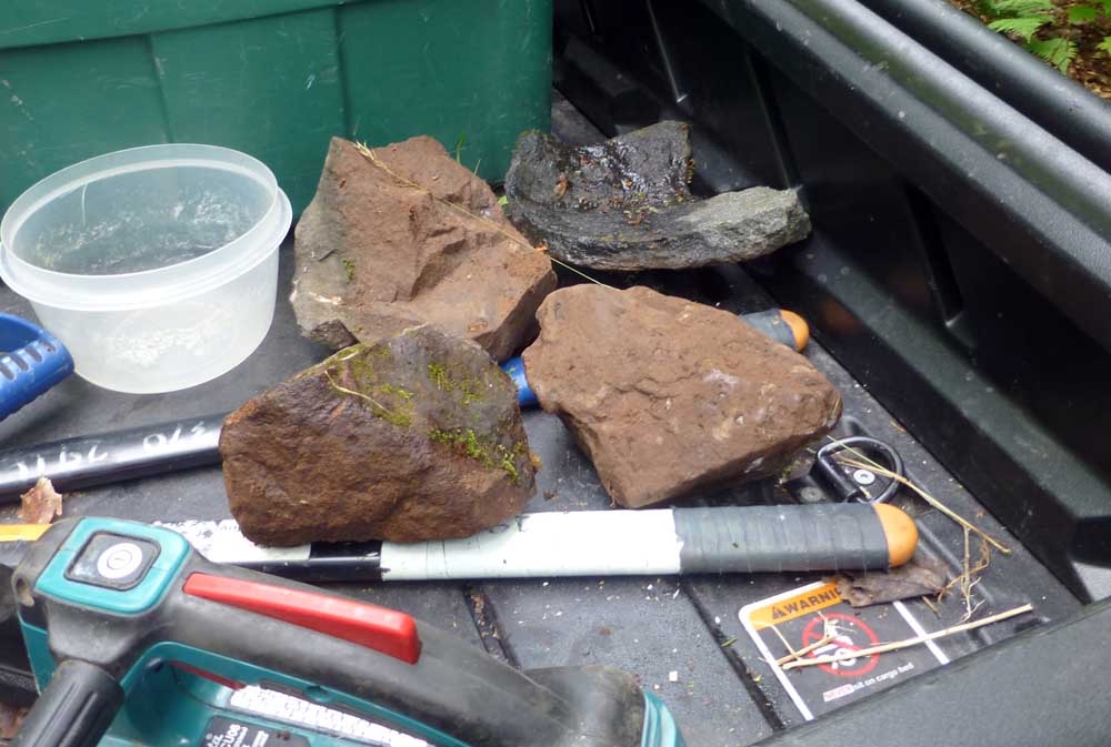

We had gone camping for a few days and planned to do trail work there, but unpredicted rain drove us home early. Taken yesterday while blazing our trails. Can anyone identify the rocks in the box? We picked them rocks along the logging road to be droped in to fill a hole.
/ trail clearing technique and tools
#999
We had gone camping for a few days and planned to do trail work there, but unpredicted rain drove us home early. Taken yesterday while blazing our trails. Can anyone identify the rocks in the box? We picked them rocks along the logging road to be droped in to fill a hole.View attachment 811884View attachment 811885
Tough one to guess guys. Its mine rock used as road base. When it was blasted and bought out of a copper mine, you end up angular rocks as you see here.
/ trail clearing technique and tools #1,000
That's what normal rock looks like around the Ozarks out here. They are all angular like that. There are lots of businesses set up around here that just pile up rocks and sell them by the pallet. I pick them up and use them for flower bed borders. Works well and looks nice.
Lots of older houses around here are clad with them instead of brick or siding. We apparently grow rocks as one of our cash crops?
