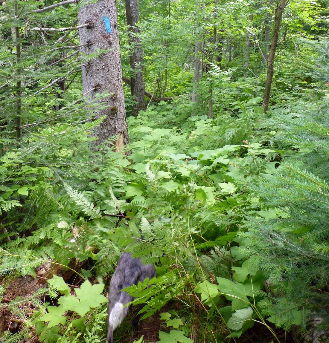

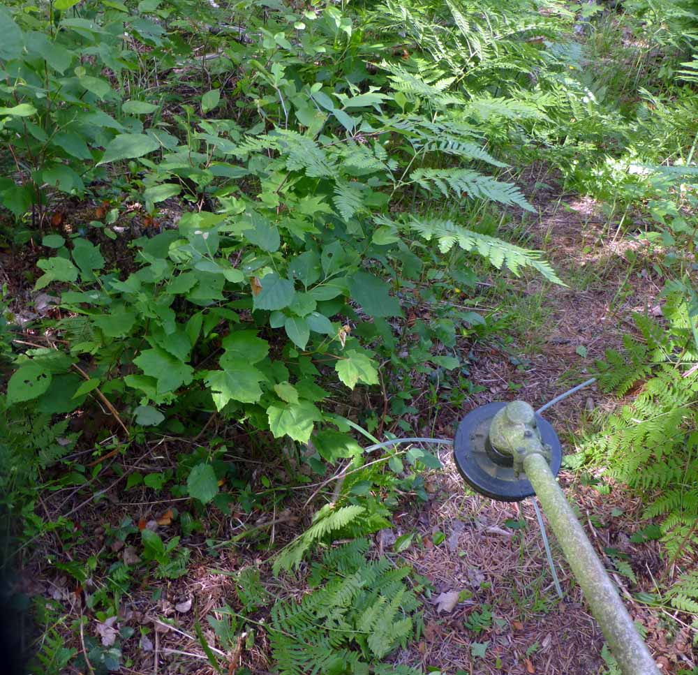

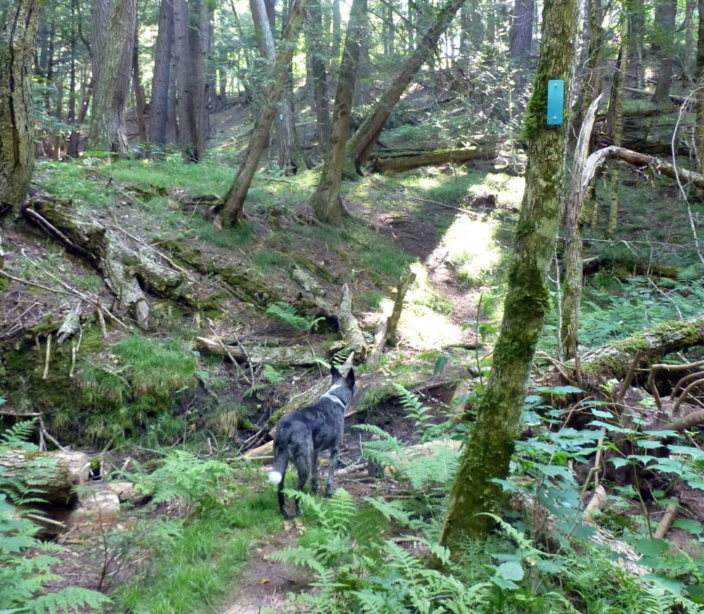

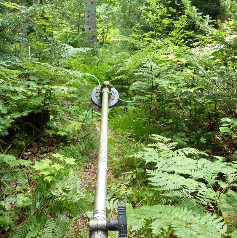

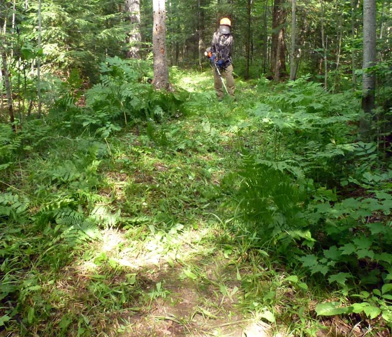

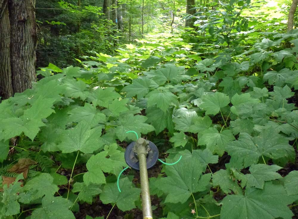

These photos were taken on the North County trail our elderly friend cares for that we helped on over the weekend. Ya, some HD string was needed here. More photos will be posted later.

Yes, but with two of us operating strings it has in done in less than 1/2 an hour. Next we take the same whackers and head down the trail.

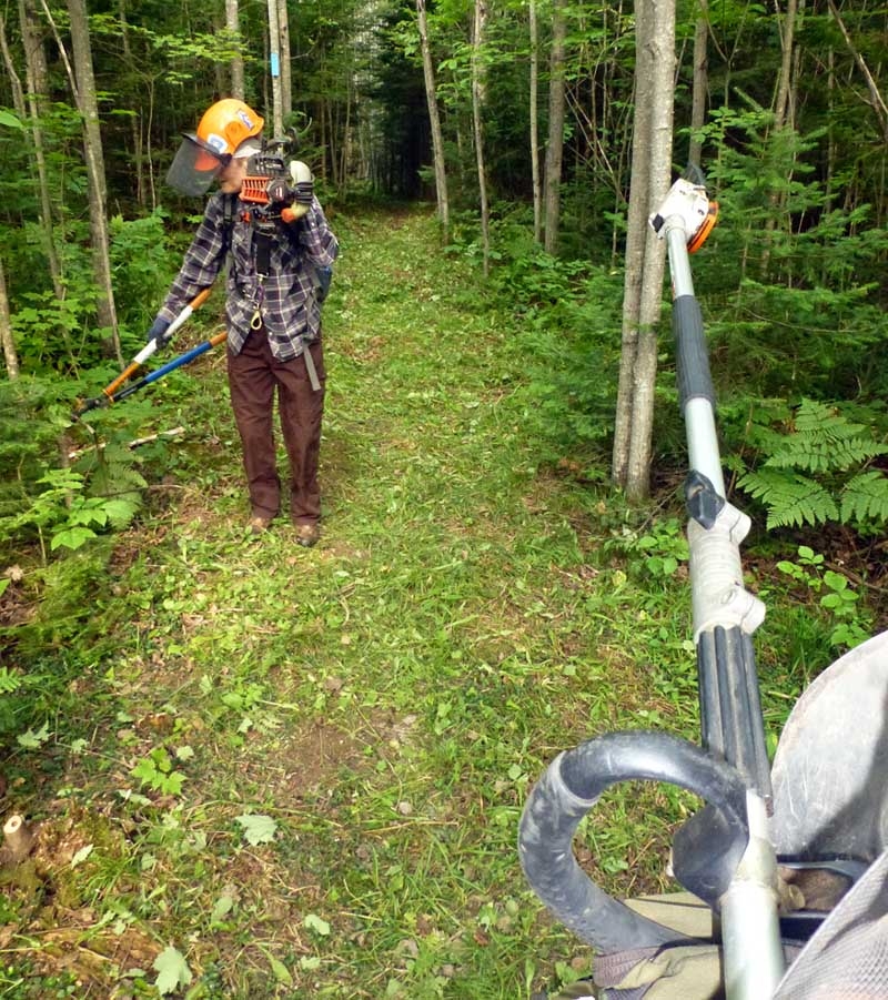

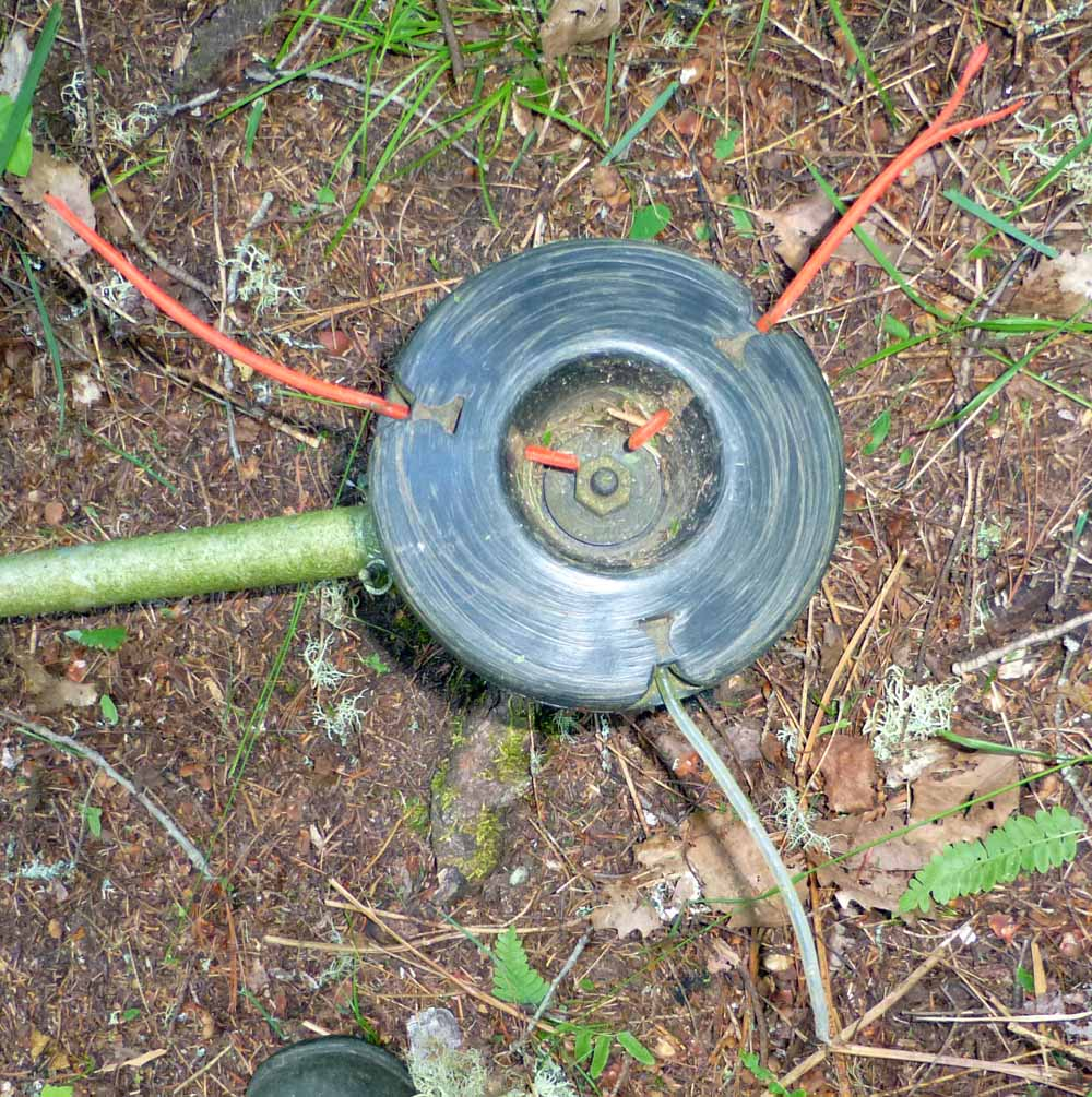

These photos were taken on the North County trail our elderly friend cares for that we helped on over the weekend. Ya, some HD string was needed here. More photos will be posted later.View attachment 815539View attachment 815540View attachment 815541View attachment 815542View attachment 815543
I know you have discussed the HD string on the weed wacker before, but can you remind me what you use? I have a Stihl FS55R and I want to change the head like you have in this first photo. It appears it's a different type of head, and then single lengths of string that are easily replaceable?
/ trail clearing technique and tools
#1,034

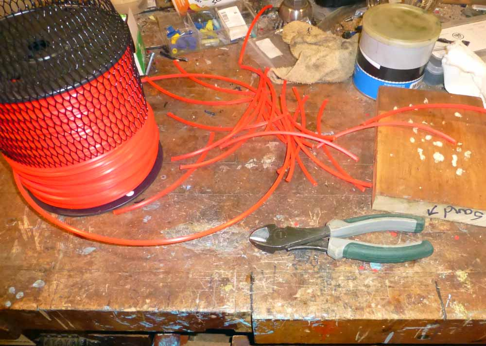

Here is a head that holds .155 string. Yes, we buy it in rolls and cut it to length on a bench then tape it in bundles sized to carry in ones pocket. Takes less than 60 seconds to change string out. I'd go with larger diameter string if we could.

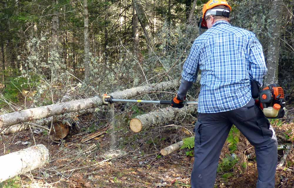

The vast majority of sawing we do in the field is with a pole-saw which we are proponents of. We also use these to run .155 and heavier strings to knock tree shoots and tough grasses down. Stihl is suppose to be coming out with a head to hold .180 string which we will switch to asap. View attachment 697105
